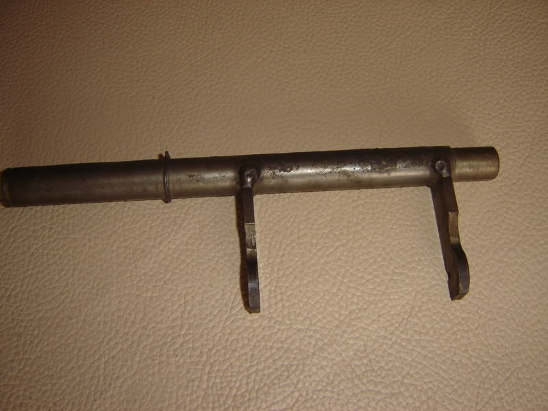

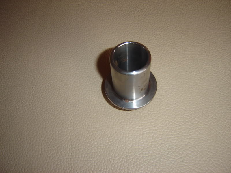

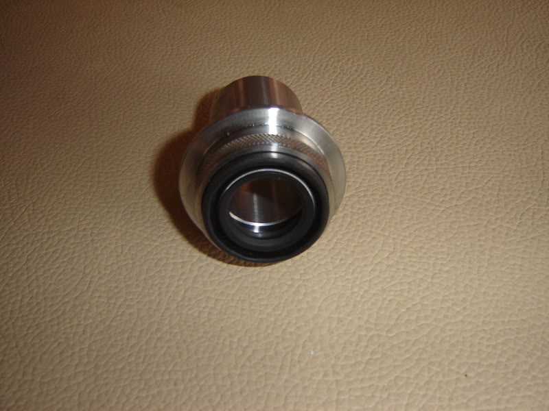

This past weekend I had collected some bits from Rui to convert to the later type release bearing so that the later diaphragm style clutch would be compatible. You basically need the adaptor sleeve and late model release bearing fork....
You have to remove the old seal that is on the gearbox input shaft, then drive the sleeve over the shaft - it has an integral oil seal.

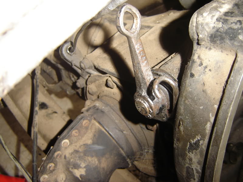

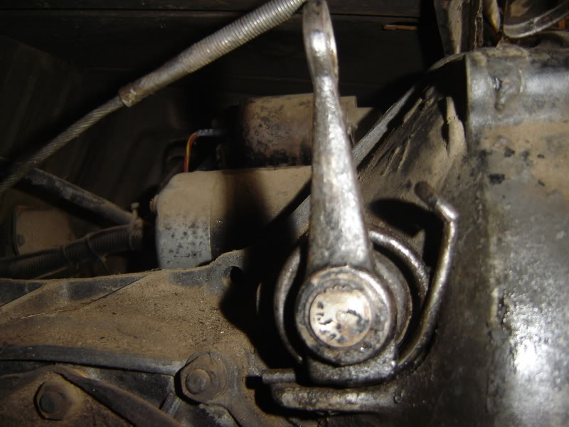

So yesterday evening I decided to start removing the old bearing fork. The hardest part was getting the damn clutch spring off the arm. It took a lot of swearing and levering before the damn thing popped off. Time elapsed: 30 minutes. To remove one spring.Hmmmm
There we go - Spring is off the arm. I fear that it is going to take a lot of time getting the thing back onto the clutch arm because there isn't a lot of space to lever.....We'll cross that bridge when we come to it
As you guys can see, it is absolutely filthy down here
Will have to spend some time cleaning up before everything goes back together again.
My next step is to remove the circlip that holds the clutch arm in place so that everything can come off and the new parts can go on. Have new bushings etc for the clutch fork. I must say that the Bug Me DVD dealing with the gearbox/clutch was very valuable when doing this. Shows exactly how to replace the clutch fork and all the bushings etc

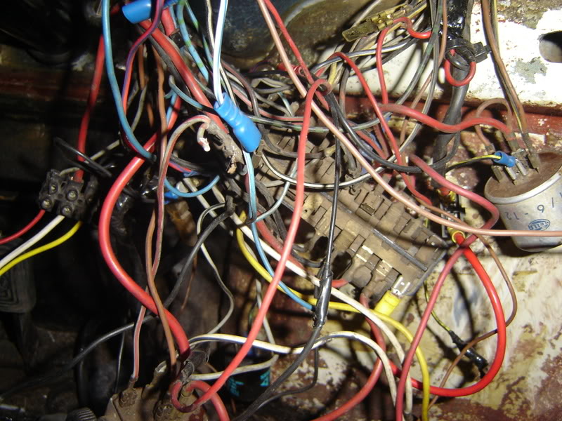

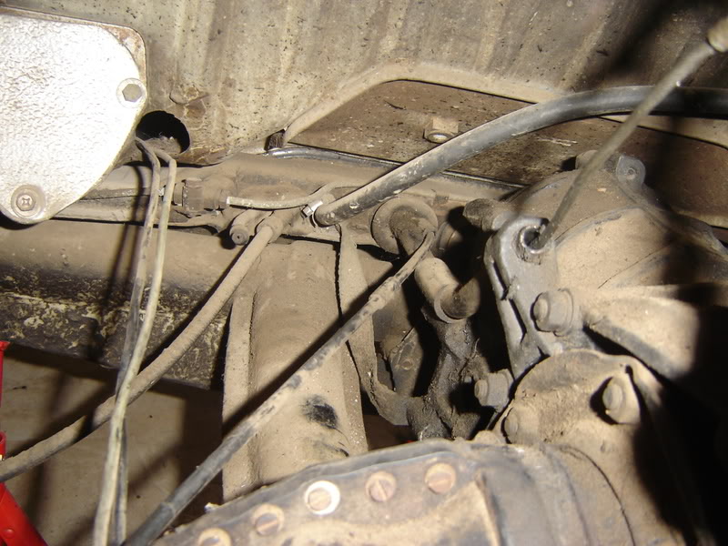

On another tack, this picture is just to show what the wiring looks like

Another picture that I found - Was taken sometime last year

Okay guys - the engine is ready to go into the car. I installed the new clutch fork and adaptor sleeve. Unfortunately, the bushing kit that was supplied didn't fit, but luckily the bushing that was on the car was still in good condition, so i just reused that. Then I hit a spot of real luck when putting everything back together again. It was very easy to get the spring back onto the arm, because someone cut away some of the metal above the arm, hence it was easier to get a screwdriver in to lever the spring back on. I have no pictures of this weekend's work as my camera was totally dead and i didn't have other batteries. . .

Like I siad in my PM, it would be great if we can get a local source for this sleeve - If you do happen to make them, i will take another twoBad Ass Bob wrote:Blitz what did you pay for the adaptor sleeve if you dont mind me asking ???
