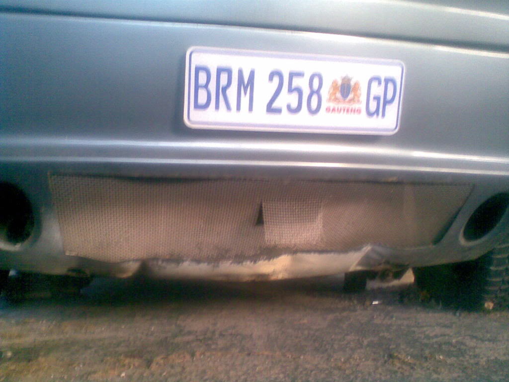

This car started life as being a standard ’68 Fastback which was originally white from the factory. In 1995, it received a 1,9 WBX engine transplant. The engine was bought from Ace Auto Spares out in Springs and cost something like R5500-00 :shock:. To get some cooling air to the rad tucked away in the sparewheel well, a neat hole was cut in the front valance and covered with some mesh. Other hacks include a hole cut in the rear apron and also the ring and surrounding metal where the cooling fan boot bolts onto. So the car has seen its fair share of hackery :?

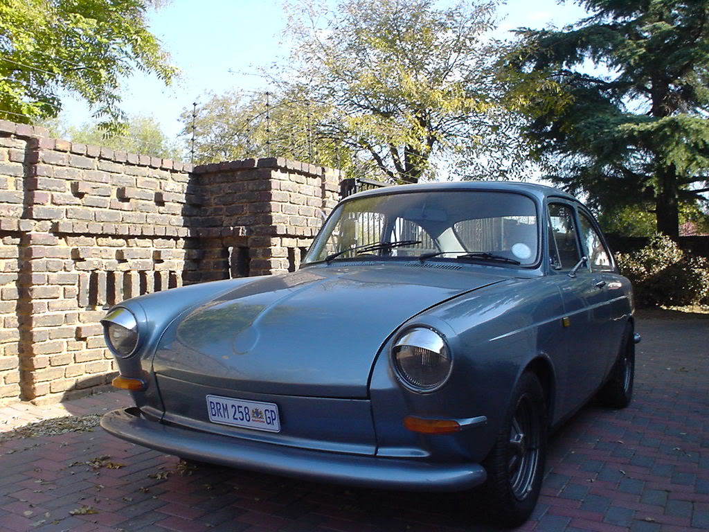

Some time later, the car was then sold to the guy who I bought it from. He also proceeded to do his fair share of modifications to the car. The most radical was respraying and dechroming the car. The attention to detail was also quite good, as he had colour coded everything that was originally chrome (with the exception of the door handles) and smoothened the beading holes and the rear decklid. At this point, the car was lowered two splines in front and one at the back by Kraftwerk (any further history on these guys?). It also had a set of chunky tyres on 14" Rostyle rims which were also sprayed a metallic grey - IMHO a very cool contrast colour! It must have been a really wicked looking ride, with decent performance thanks to the WBX :D
In its glory years:

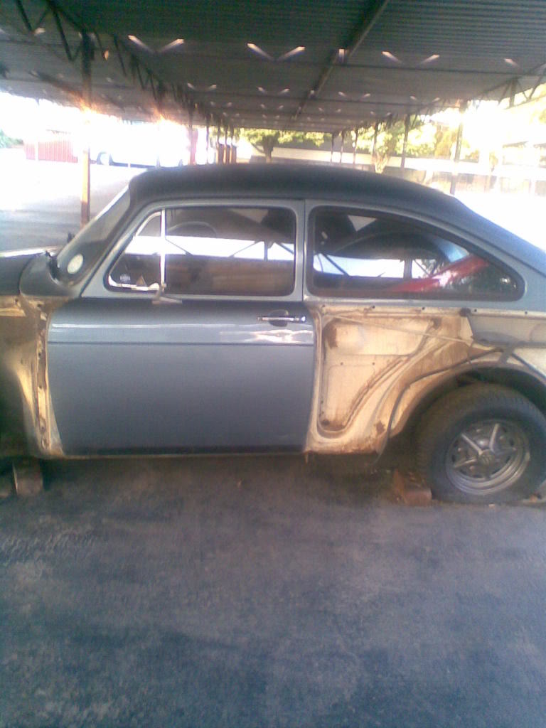

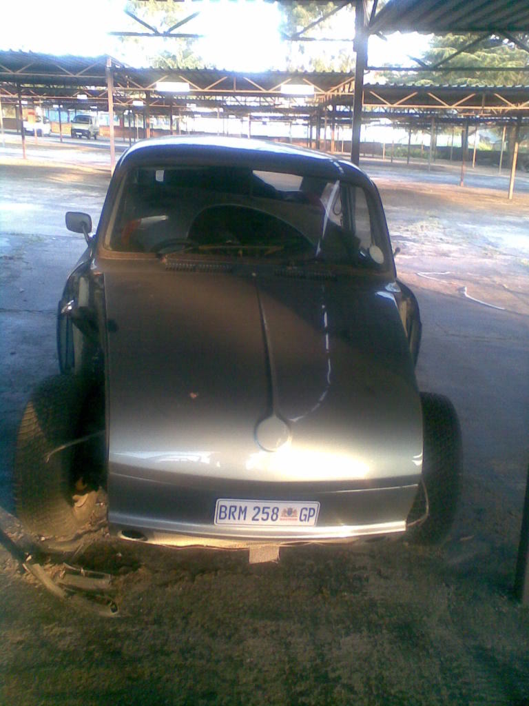

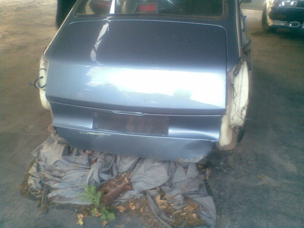

To cut a long story short, I first went to go and see the fastback in Dec 2007. Even though it was stripped and partially buried under a layer of dust, I instantly fell in love with it! The moment I saw the car, I knew that I had to have it. And so It was a done deal. I checked it out and decided that it would make a quick project (famous last words). Here are the first pics that I took of it.
Anyway, after confirming that I was going to take the car, I had to wait for a further two weeks before we went to go and pick it up. The car almost never made it home. As we were coming down the off ramp at about 40kays per hour, the car broke loose from the A-frame and decided to go on its own way. In those adrenaline fuelled moments, I don’t know exactly what had transpired, but I do recall jumping out of the moving car at around 40 kays, narrowly missed being hit by a Golf 5 GTI as I ran after the Fastback in the middle of the road, slipping and falling on the gravel on the side of the road as I fought with the steering through the door of the Fastback, eventually getting it to a halt on the side and hearing my Dad curse my stupidity (had to remember that part :lol: ). I waited for around 2 hours on the side of the road with the damn car as I waited for my Dad to get a car trailer and then finally managed to get it home without any other problems. (Oh yes, the previously jammed passenger side door did open as we got off the highway – By then, I was seriously wondering if it was cursed...)
After finally getting it home (offloading was another story – Trailer was too big to fit in the yard so it took a bit of juggling – Even stopped traffic in the street for a while) my initial idea was to get it running as a daily driver and then fix up my ’67 as a long term project.Yeah right. That never happened. Main reason for the car not running sooner was because of my studies, work and a just a lot of indecision as to what engine I should run . (Wbx, Type 4, modded Type 3, Type 4 again, Golf motor, WBX again – you guys get the drift!). If I had a set plan from the start, this car would have been running a few months ago already :evil:
About a week after I got it:
I did some minor work on the car, such as cleaning it up a bit, putting all of the panels on loosely etc.After a while, the car was moved into the garage. Where it has been sitting ever since. Again, under a thick layer of dust. But at least protected from the elements.

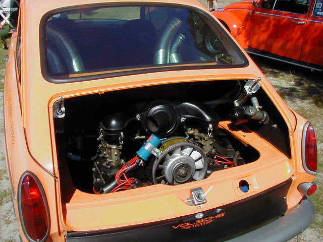

Engine
Most definitely a Type 4. The 1800 that I originally bought had a few issues (odd piston, distributor drive was fooked etc), but has quite a few decent core parts and it is rebuildable, which will happen sometime next year .The new engine that I have in my possession is a 1700 Type 4,but is quite a rare beast as it has a magnesium case. And it was just last night that IMPI called me to tell me about another 1700 up for sale that has already been rebuilt, so who knows what could happen regarding motive power for this Type 3...
In the meanwhile, I'm going to start work on this one.
A huge thanks to Pine who brought the engine for me from Klerksdorp in the back of the FuchsBus :hangloose:. More on the engine later…

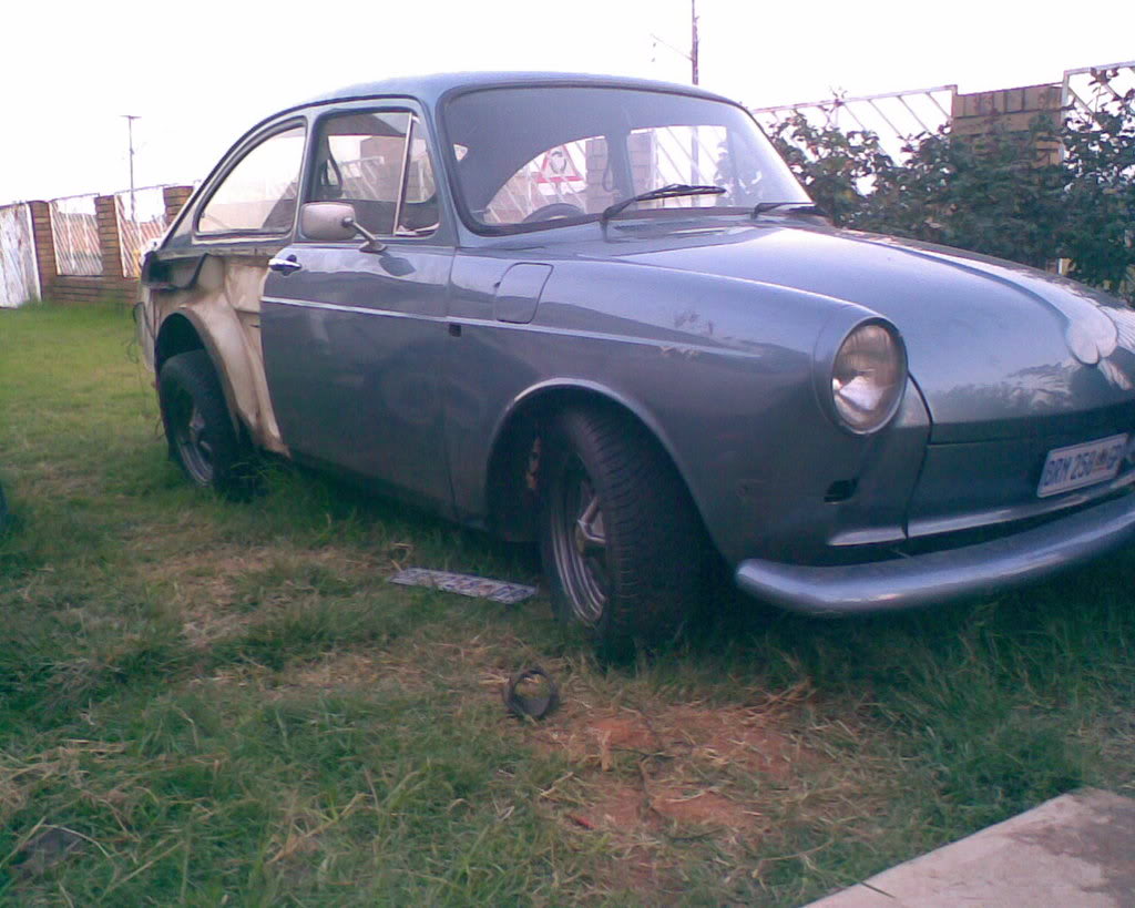

There are plenty scratches and in some areas the paint is cracking due to imperfect prep, but on the whole, it isn’t too bad. This car is most definitely not a show car and the intention is not to build one, so I don’t think that It will be resprayed anytime soon. Maybe a few minor touch ups here and there. The one area which does need urgent attention is the rear decklid and apron as the metal is starting to rust under the body filler and the filler is falling off in chunks. I will be painting those areas Satin Black once the car is running. Something like what this guy had done...

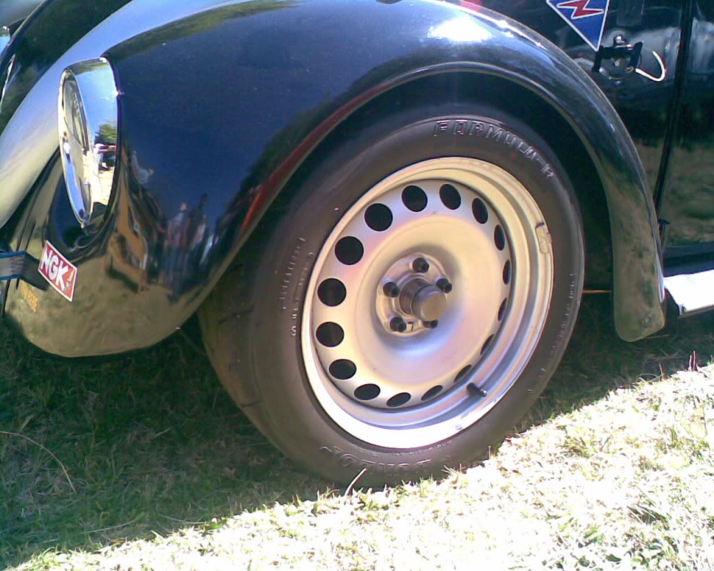

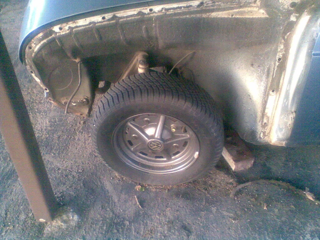

The current Rostyles just don’t cut it and won't be compatible with my choice of disc brakes. I had a set of 15” BBS wheels from a friend’s imported Golf VR6 in mind, but that deal doesn’t seem to be happening. In all likelihood a set of plain and simple steelies from a Jetta 4, powdercoated in a contrasting colour will be the choice of wheel. I had two of these with decent tyres and when I let someone who urgently needed to move his Golf use them, they never found their way back to me. Bastard guy :evil:
Nothing in life is definite, so if another rim does happen to catch my eye............................... :lol:

Floor has some rust, but nothing that can't be fixed. The body is rust free. The actual spray job is superb, but due to imperfect prep, the paint is cracking and loosening on the doors and other areas.

There were 2 sets of BBS wheels in JM ads I posted. I included them for you as I know that you are partial to BBS wheels, just like me.

@Beetlefanatic - Yes, I will be putting on BBS wheels at a later date. Keep those Junkmail ads coming in boet!

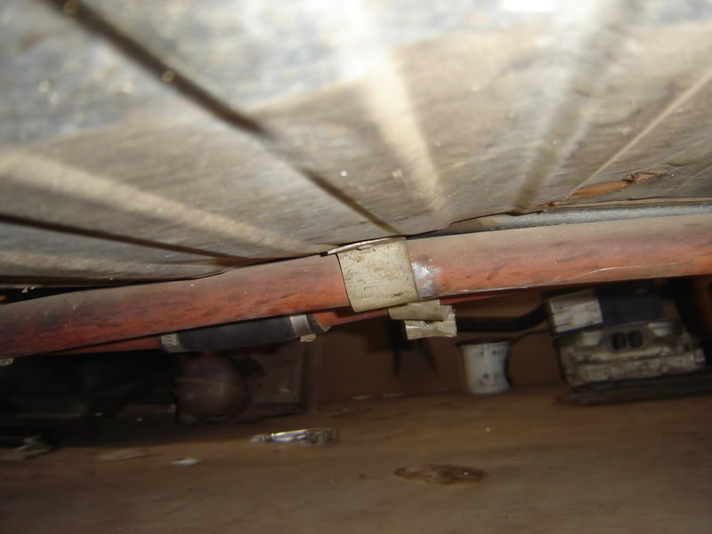

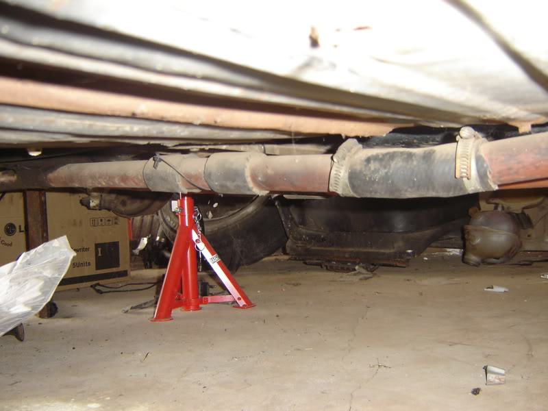

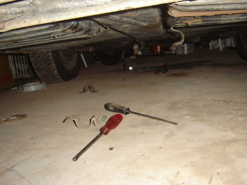

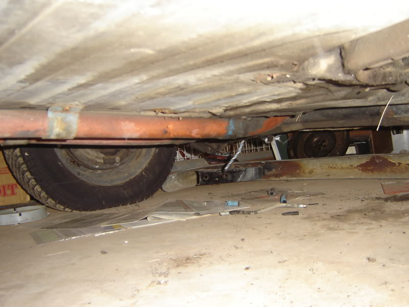

Remember that this fasty had a watercooled conversion. The pipes were still running under the car.
Decided to remove them. What a nightmare of a job!! The self tapping screws that the conversion-maestro used to secure the brackets were all rusted. It took a lot of Q20 and strong language to get them out :evil:
Will keep the pipes just in case I ever get the sudden inclination to do a Subaru swap :lol:
Pan looks so much neater without the pipes. Not that a person would ever look underneath :mrgreen:
While removing the pipes, discovered a few rust patches which I immediately sorted out. There is a hole under the clutch pedal assembly though. Will have to get some fibreglass and sort it out.

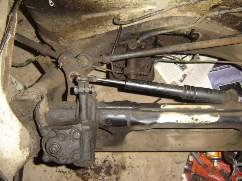

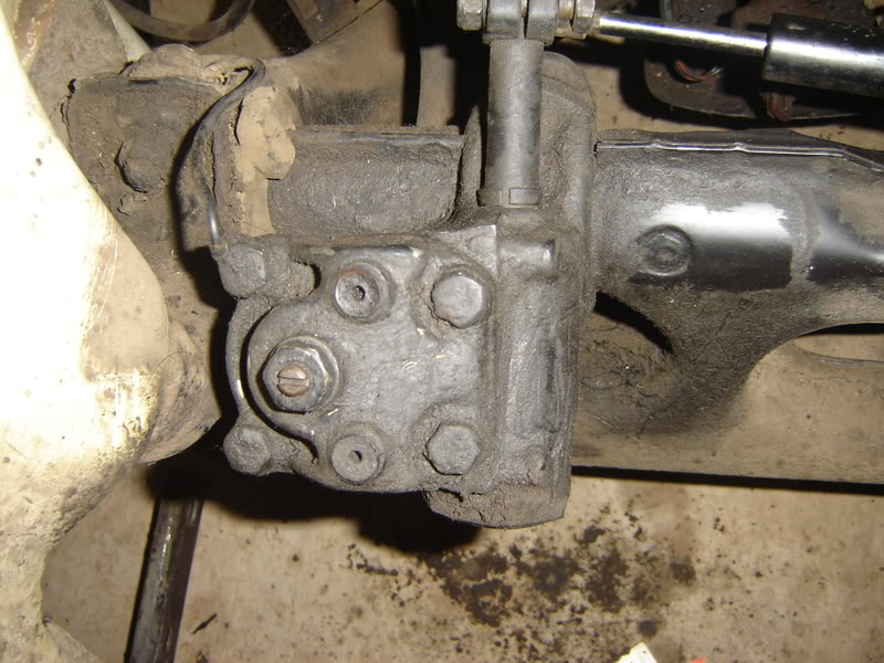

Thick layer of crud on the steering box and surrounds :shock:
Will start with the wirebrush and drill today after work.
