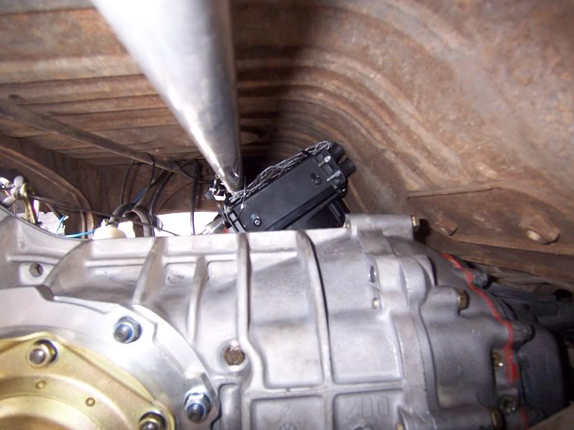

- Posts: 15008
Suicyde is now buggered
Well its official, Suicyde is now Buggered.
Anyway... my updates...
Making slow progress. Working alone takes its time and moral support can be lacking at times.
Gearbox is now in. All gbox braces are now installed - kaefer cup brace, mid-mount for nosecone support and bellhousing strap. Getting these items on properly wasnt a laughing matter. The final fitting of the bellhousing strap and the kaefer cup brace took close on 3 hours (and there was only 2 bolts to line up and fit and do the final length adjustments on the Kaefer cup brace).
Gears have been tested - a little tough to get into, but i am sure it will be easier once they wear in a little.
Real wheel bearings have been put in.
Axle boots are on, but not secured. I am having serious issues getting them to fit properly and ran out of patience today.
Plans for tomorrow (if time allows) is to seal the axle boots and fit the rear hubs and brakes. Also to convert the hubs to accept wheel studs instead of bolts.
and proof that the oil cooler clears

- Drive Train
- Posts: 3004
Re: My bug - version 1 - Suicyde - the ongoing project
Ahhh, that oil cooler is so cute and small!!!
Seriously, did I miss the info of where you bought it? The oil cooler I installed years ago on the Fastback is bigger than that(on top of the gearbox with EVERYTHING still in the car. FFS, did I struggle to get in there
Things look good. Here is the morla support "Keep at it buddy!"
That *edit* Kaefer *edit* brace, is it ally?
