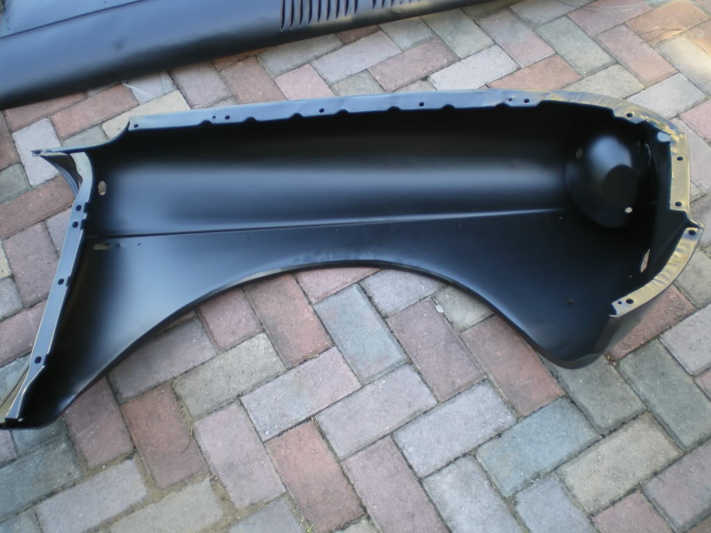

Hi All
Here pic's of sand blasted parts that have come back from E-Coating.
No Rust inside or out, these will now last a another 43 years
Now we off to the Spray Shop, will post pic's of car when loaded on trailer,
The paint is off and the underside is pre-rubberrised, a little off the paint line.
This as well as the inside of all loose parts will be fully rubberised on return from painting

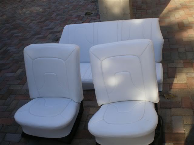

Hi All,
Short note to say All tin in to spray,
Good news ...
Got seats back, and they look great, but what do you think ...
Till next time....
Good news ...
Till next time....

The pics of the body panels : Were the panels in primer in the photos, or did the sand blaster apply the primer?
Was there any warping that occurred ?
Thanks for the pics and updates
- Posts: 8716
- Has thanked: 424 times
- Been thanked: 542 times
Hi Jolas,jolas wrote:Cool, this project is really progressing at speed !
Thank you.
The body I removed the paint by hand with heatgun and scraper. Sand blasting takes to much steel off, and exposes new areas to rust that you cannot get to, to recoat it again. Inside areas I spray with Rustcoverter and cover with tectyl(liquid wax)
The panels had so much surface rust that I had them Sandblasted, BUT I paid the Blaster chappie extra, to blast from far away, so as not to damage the surface,Therefor I got no warping.
THEN we toke them to a company that works for the auto manufactures, and had them derusted to take out the pitholes of rust.
Then they E_Coated them(this is what they do on new car parts so that hiden sections do not rust) in a tank that is electricly charged to make the coating(much like powder coating) stick to the metal
Then they bake it in a oven for 45min at 200Deg. C, This bakes the coating and seals the surface so no oxygen canget to the metal, to start the rust again..... few... Here endith the lesson...
