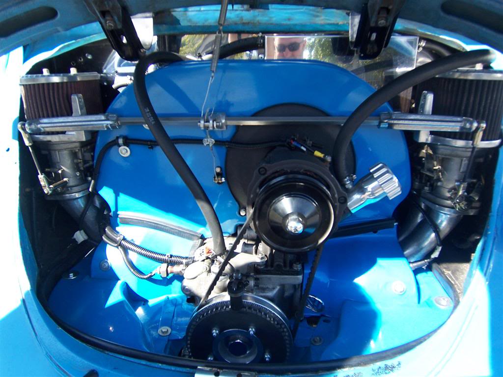

- Posts: 14992
Re: 58 beetle project now with nitrous
If you are going to go that route... why not use Gotech? Neat install and local support.marius 58 bug wrote:Thanks guys I wil look into it . I also like this system but I think you will need a ecu
Here is mine
