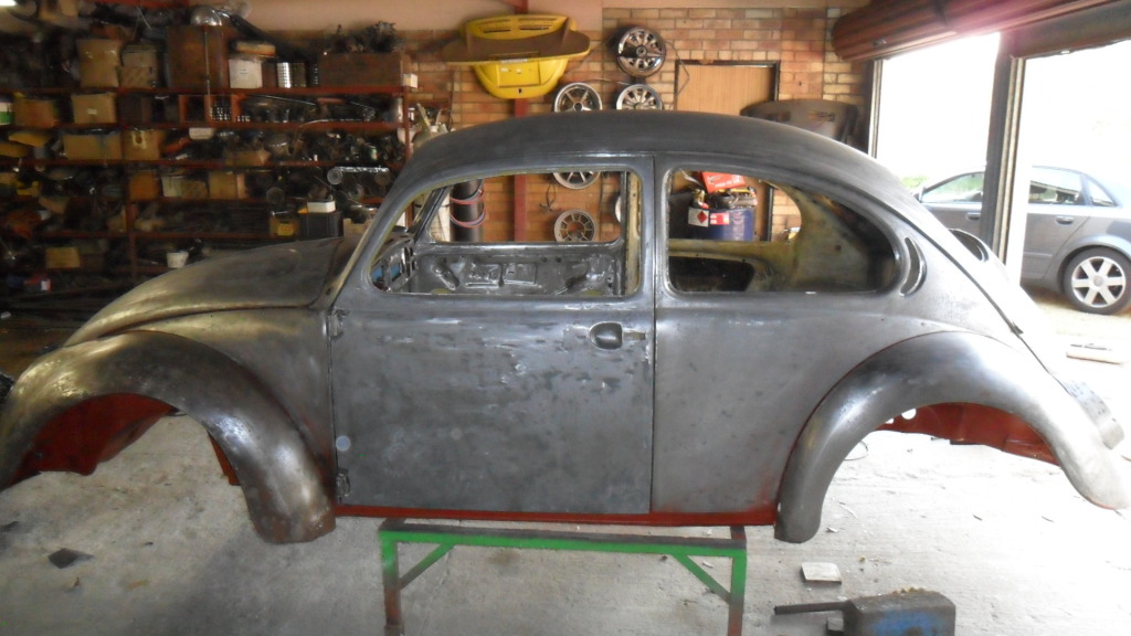

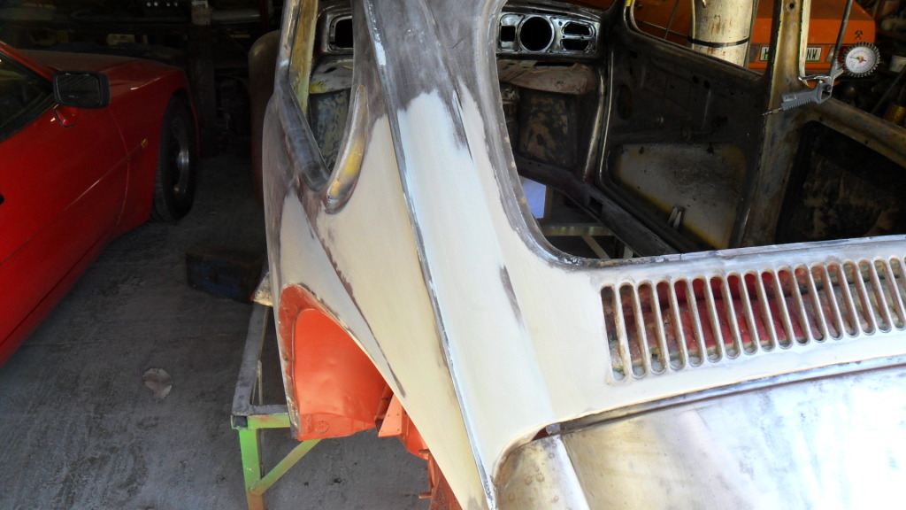

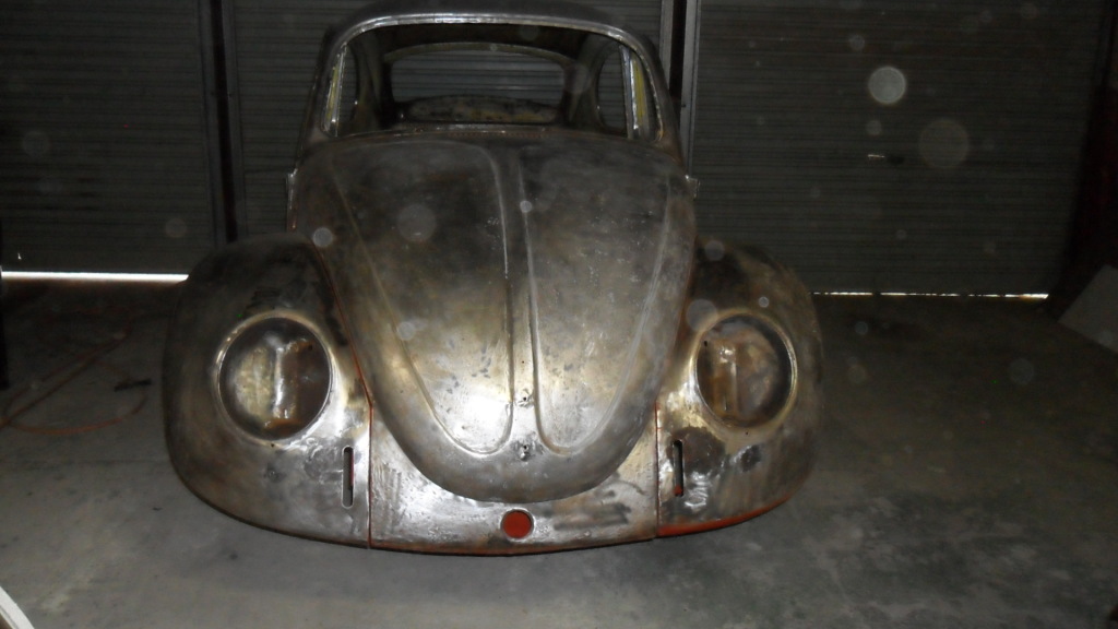

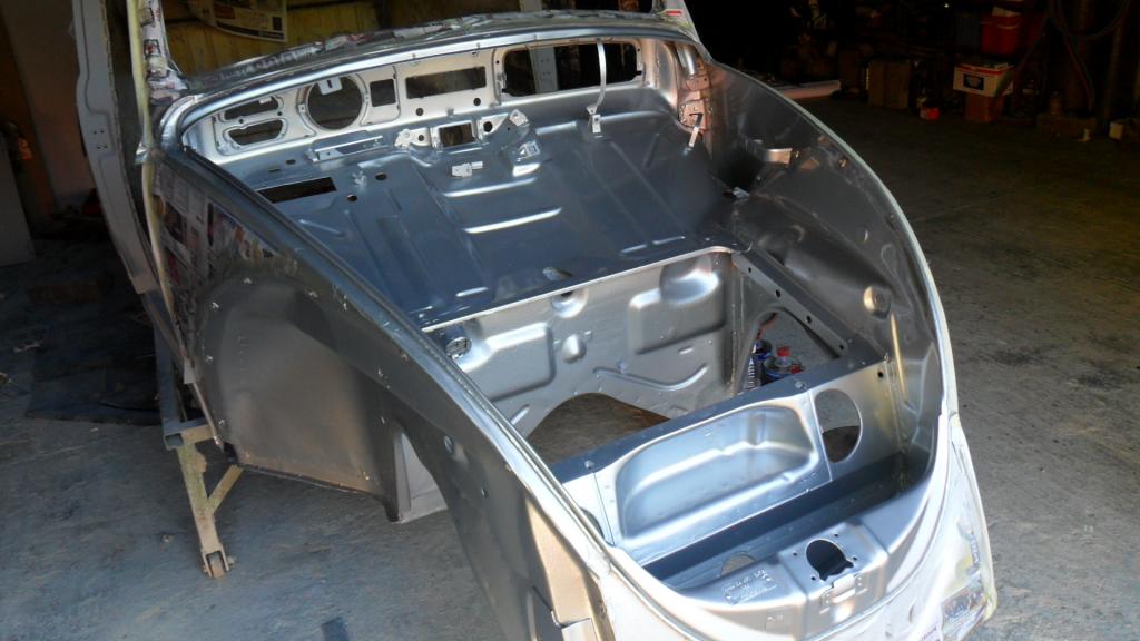

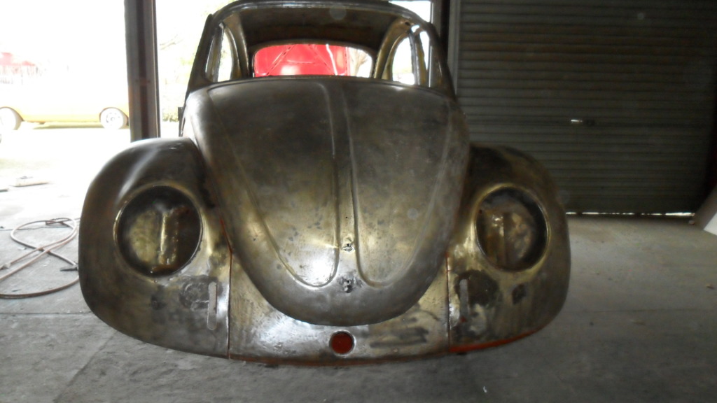

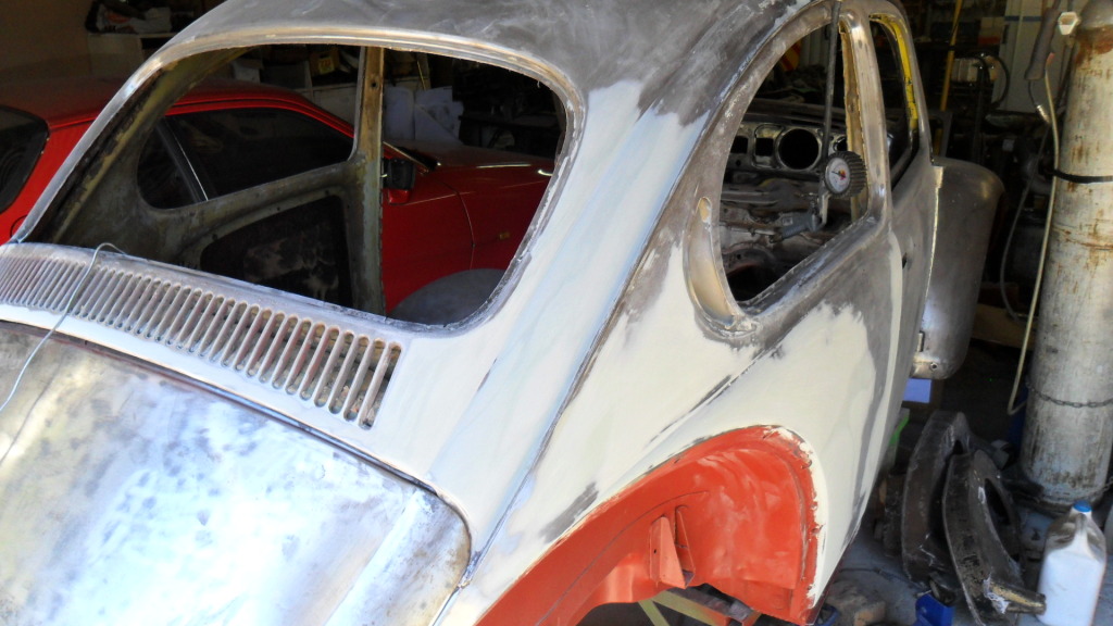

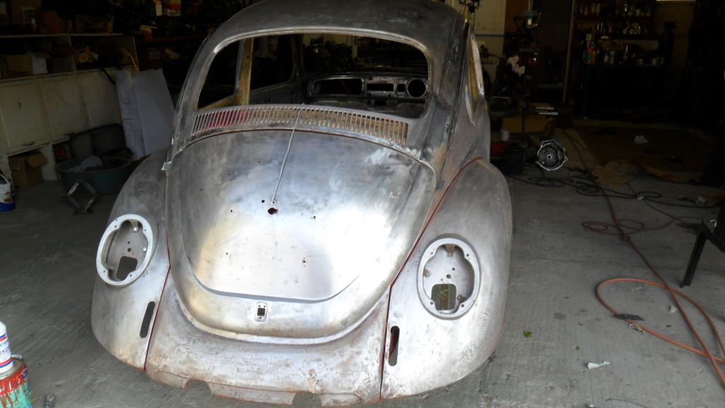

Finally the thing is clean and bodywork is starting.
Bare ass naked Bug!
Hopefully we show real progress now
Armand
Bare ass naked Bug!
Armand

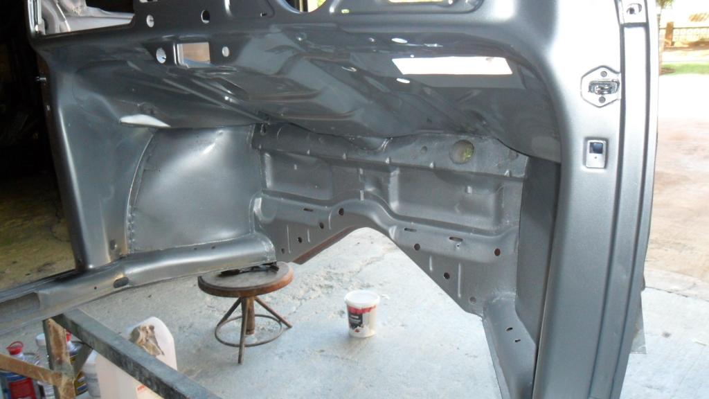

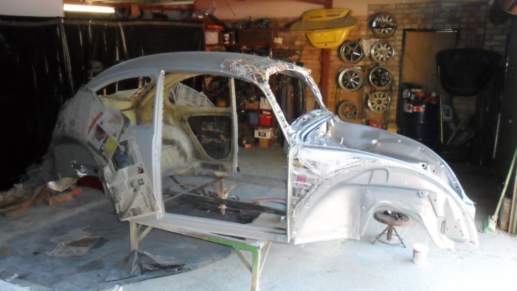

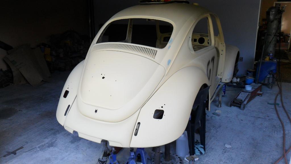

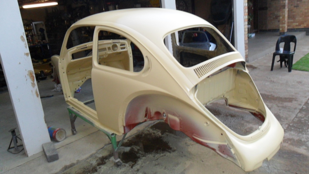

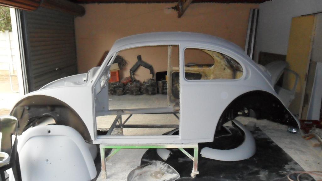

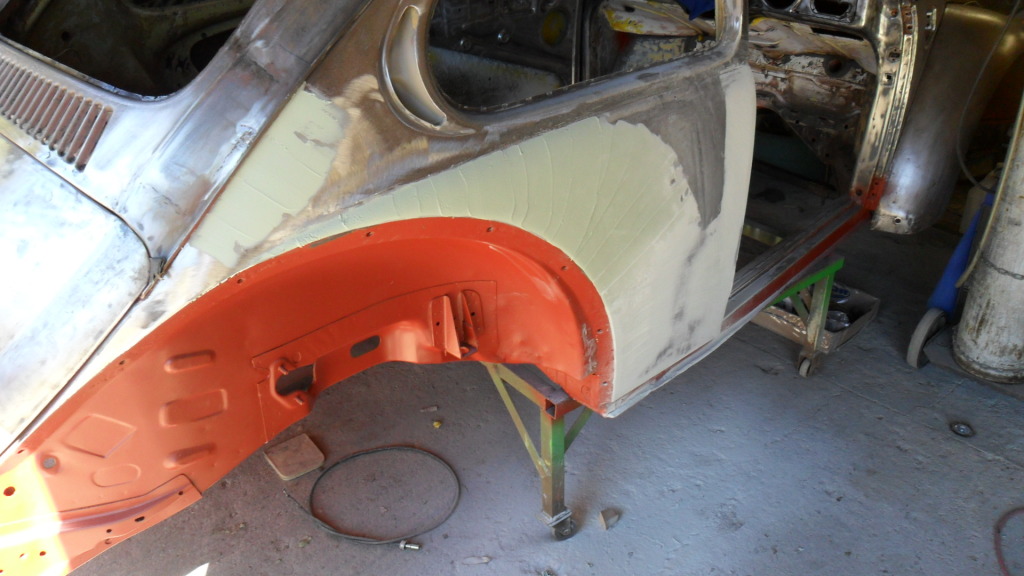

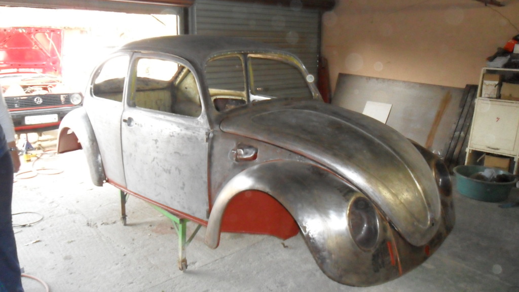

Another few shots finally the main shell is in primer now for fenders and stuff
Armand
Armand

u fitted the bonnet and decklid?
Ryan Marshall
- IMPI
- Posts: 1897
- Been thanked: 78 times
Re: Overhauling South Africa

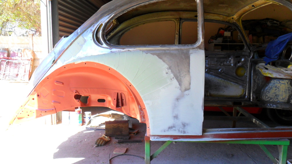

The bonnet and bootlid is off and onn a lot of times to check alignment and curvature. Once all the rough work is finished we will spray hinges and fit them and the bonnet finally just before final paint this way you get a coat of paint in all the nooks and crannies but also over the whole car. It is almost impossible to do the fenders without solidly bolting them on
Armand

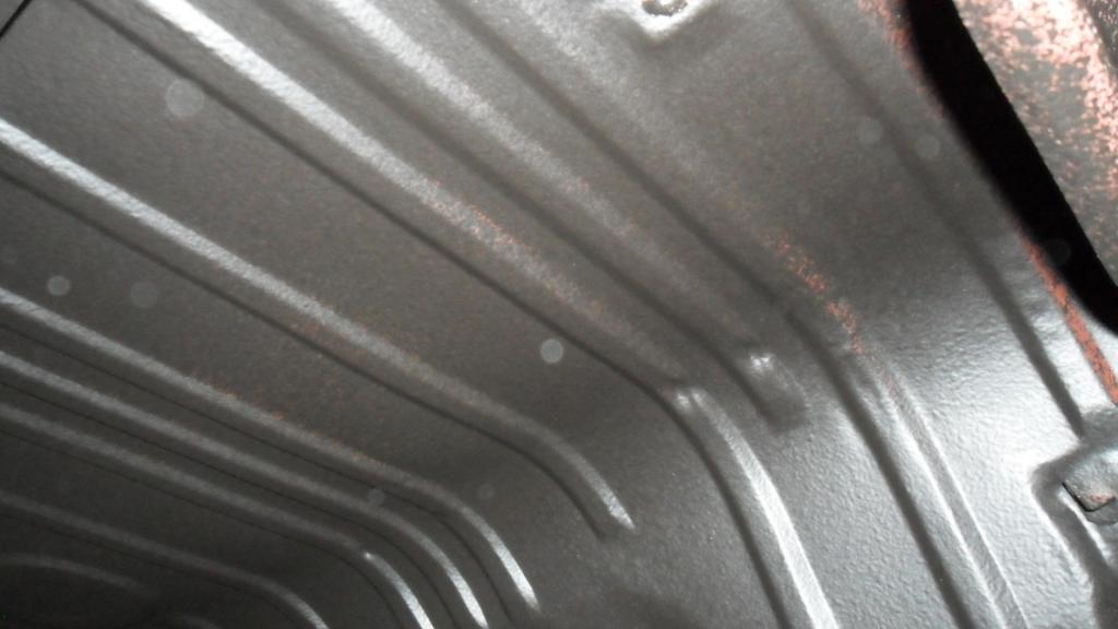

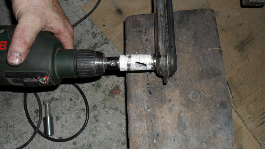

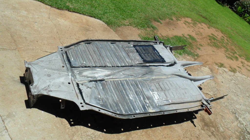

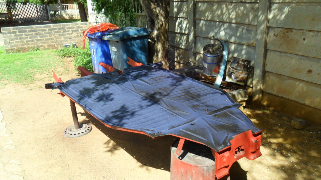

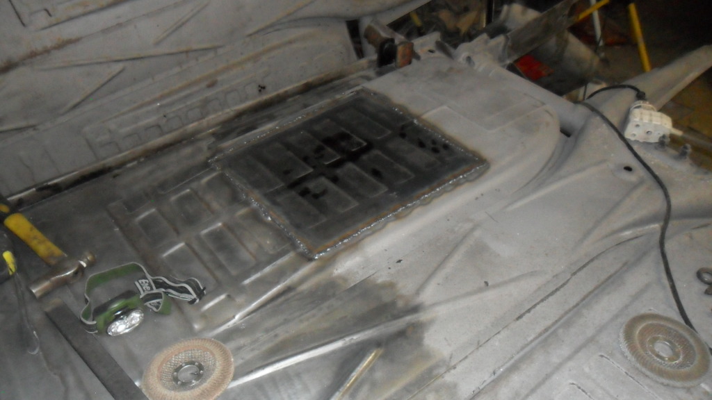

Hi Renier has just strted uni and the bug is still a bit off but we hope to finish it this year.
December was spent on the pan.
holed bit replaced with section from volkspares
Seams sealed with poly urethane
Then onto stone chip

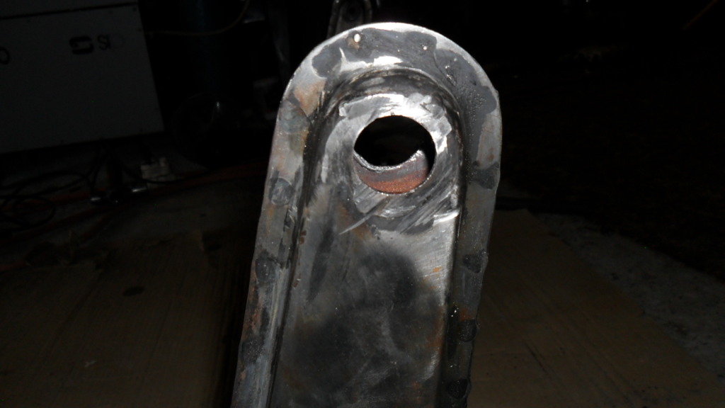

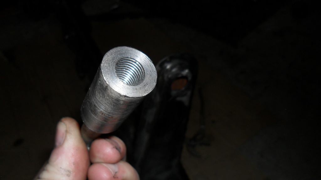

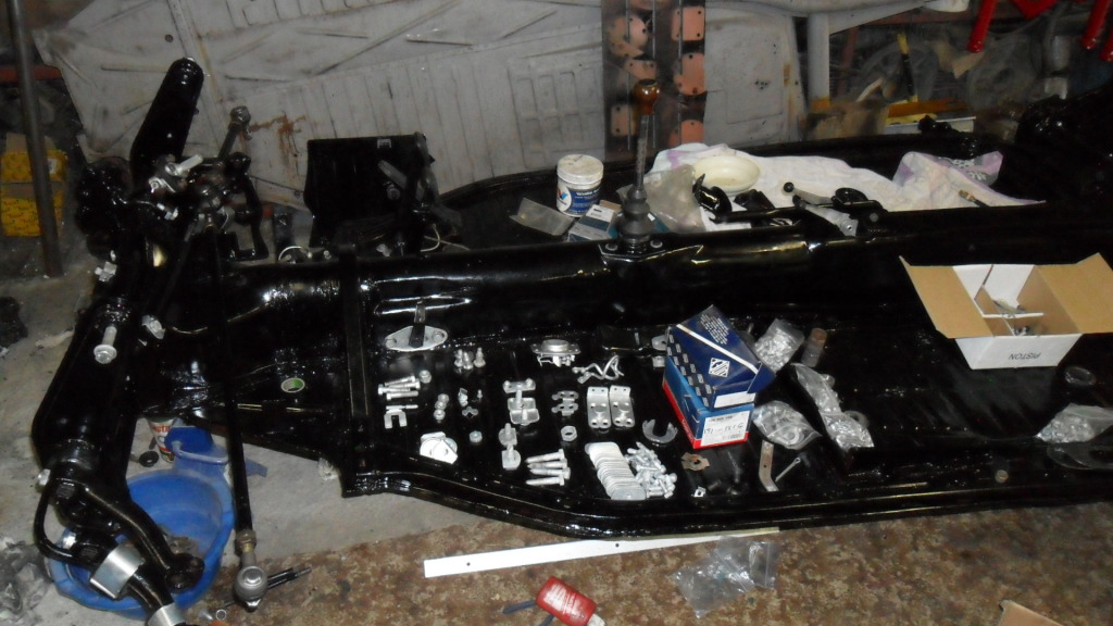

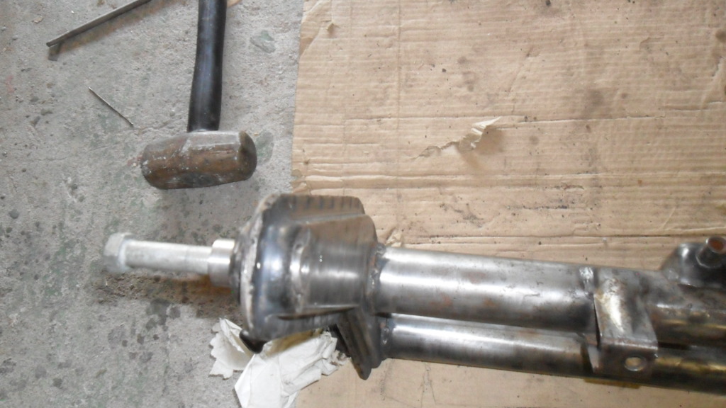

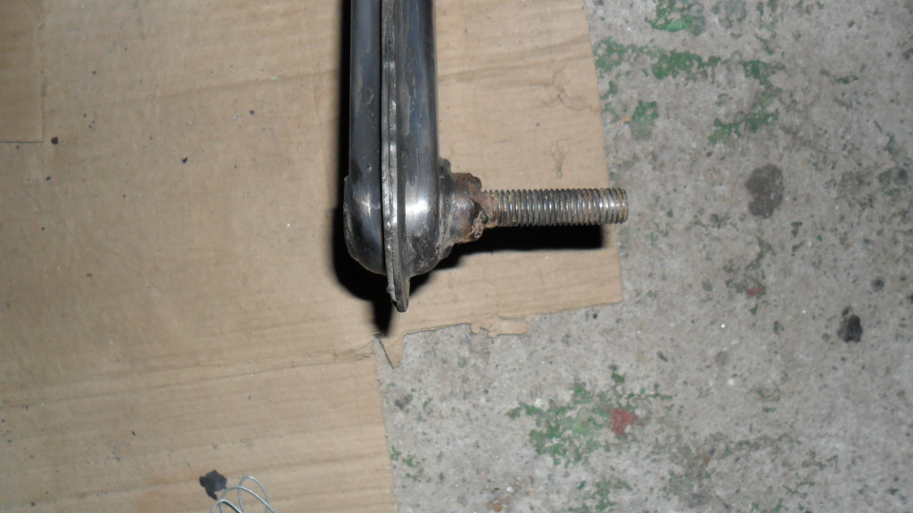

Front beam needed love
New insert made

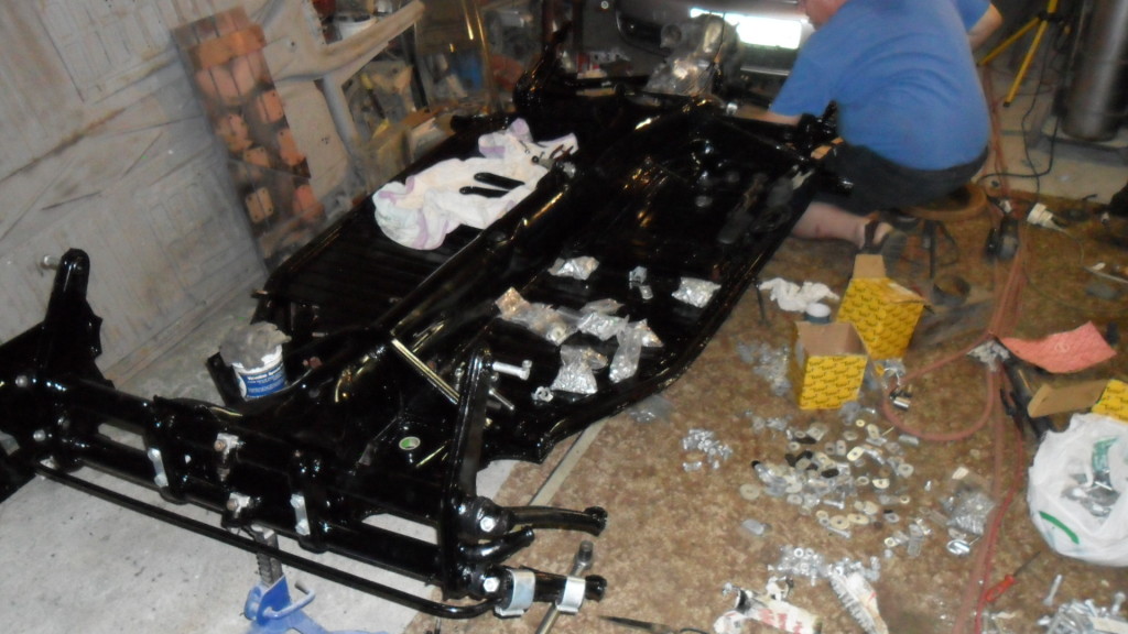

Then assembly

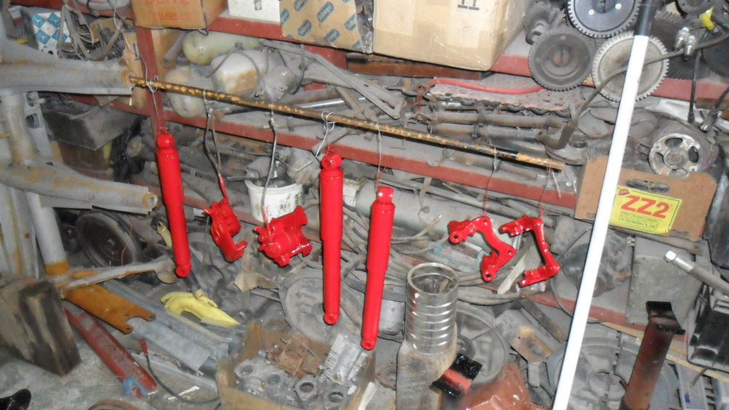

all the galvanised bits
some colour
front brakes
Thanks for looking
Armand
New insert made
Then assembly
some colour

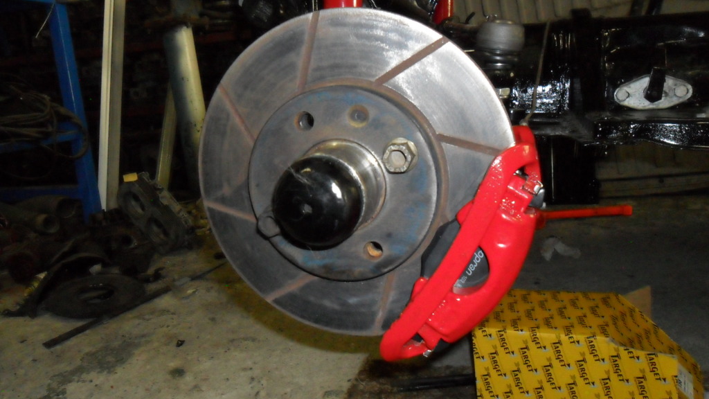

front brakes
Thanks for looking
Armand

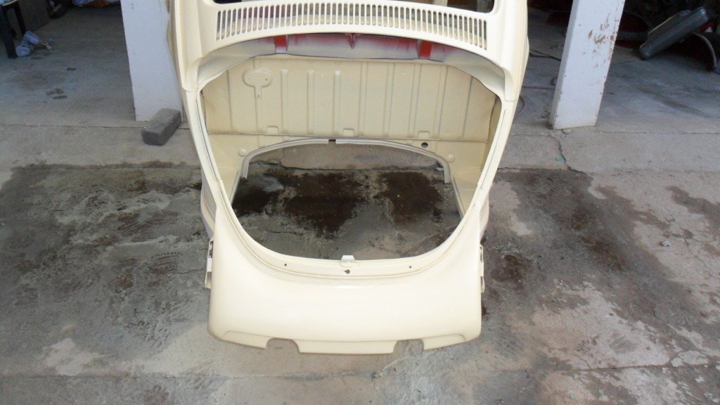

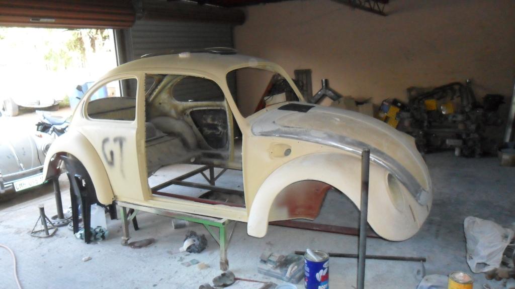

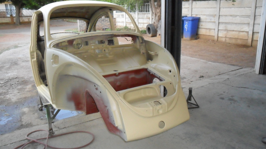

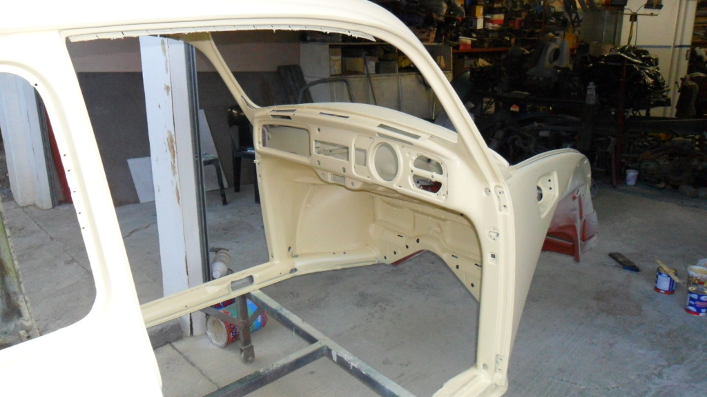

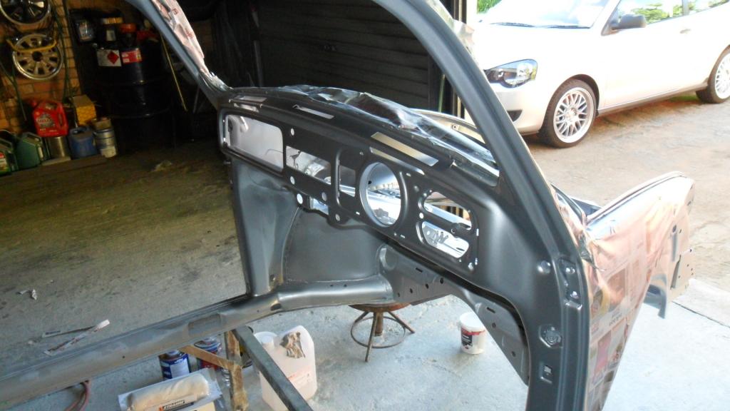

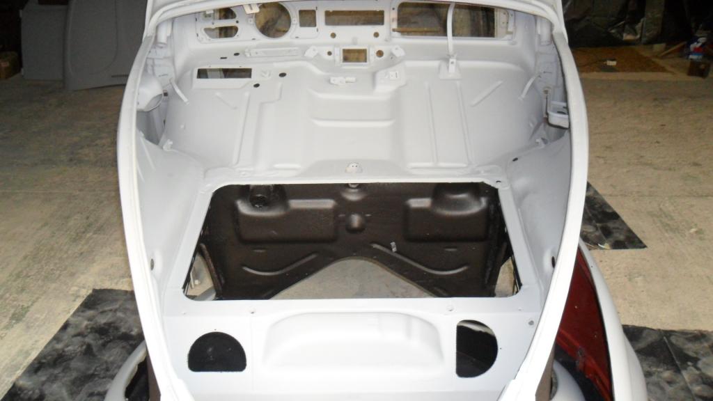

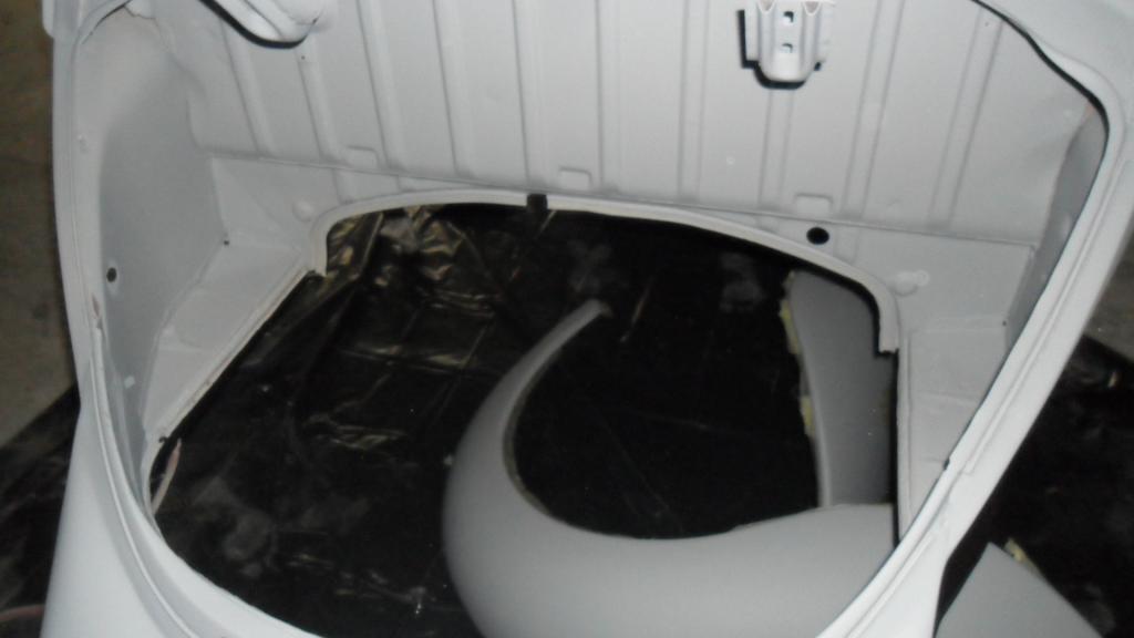

Hi some progress to show. Body work is finally done and we are starting to painr hopefully she will be in paint this weekend.

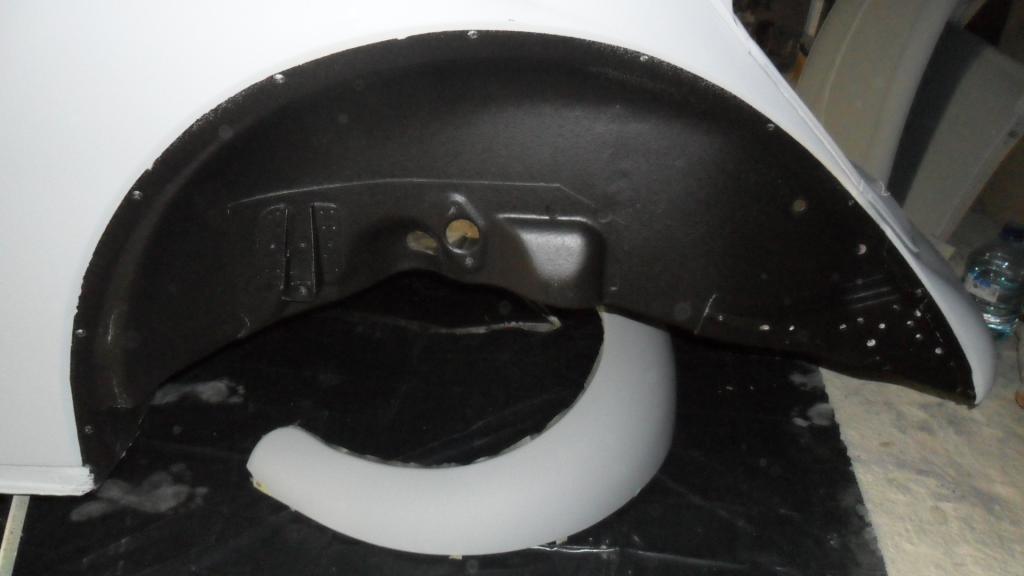

final primer and stonechip under arches
We painted the dash and under bonnet areas first
Thanks for looking
Armand
Thanks for looking
Armand
