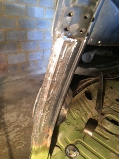

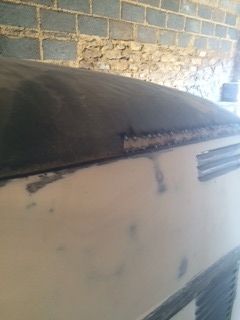

Yes its good to get some progress, and yes both mig and tig are used for different areas.
Only using Green Panels where the profile is dominant, otherwise such as with the beetle just forming steel to fit.
The edges are not overlapped, it just looks like it, but are 1st tacked, then shaped, then spot tacked to fill.
Then ground to flat.

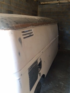

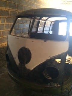

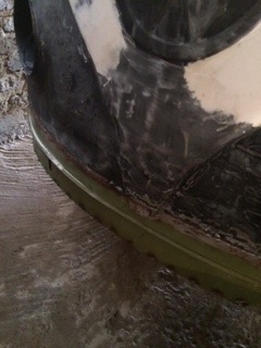

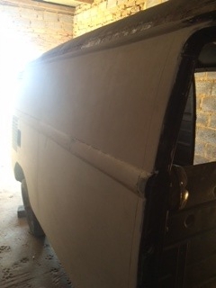

Well its been a long time coming, but here are some shots of the bus at this moment.
Was hoping for it to be nearing completion, so the assembly can begin, but lets get some colour on her 1st.
Well till next time,

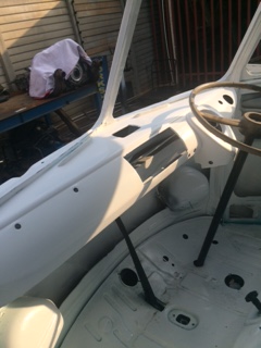

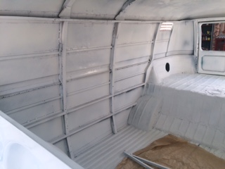

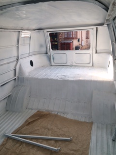

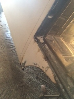

We its been some time, and most of my time has gone into the Beetle and the Bay
So now I will wet you intreset, and post some after photo's, ........
From Inside.....
From Inside.....
- Posts: 8717
- Has thanked: 425 times
- Been thanked: 544 times
Re: Retrovans 75 Fleetline panelvan - Project
So now I will wet you interest, and post some after photo's, ........
From Inside.....

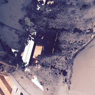

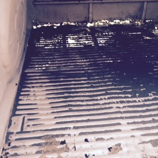

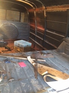

Yes there is some work still to do, also sum Rust converter, and final Interior coat'
But it looks better then this..
And....
So till next time.....
From Inside.....
And....
