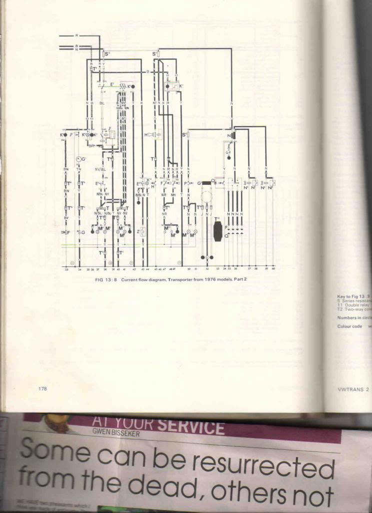

Please help!!
Which goes where, I am still busy with the Bay's wiring.
Spotlight relay;
87 = ?
86 = ?
85 = ?
30 = ?
What does it mean? Body negatively or positively earthed
Twin Horn relay;
87 = ?
87a = ?
86 = ?
85 = ?
30 = ?
John
0734897477
. . . . . . . . . . . . . . . . . . . . .JESUS IS LORD OF ALL

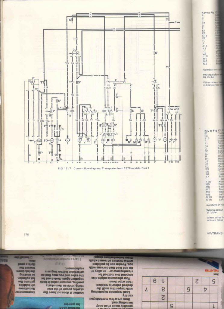

sorry, forgot something,
in the engine bay there is a harnass that has got a red, black, light blue, brown with a whtie stripe, and a blue with a black stripe. What is the red wire, and the brown with white for, as black is for fuel pump ( I have got that and my coil and carbs connected to it), light blue for alt warning light, blue with black oil sender unit
John

Posts: 14992
Re: Questions-Questions
maybe this helps
Posts: 14992
in short 80-85 is the coil, this should go to your button and to ground.
30-87 should come from your fuse box and then head off to the lights.

JohnCloete wrote:..............
Here the wiring diagrame as needed,
PS, it has a colour key on all the wires.
Good luck

Herman,
thanx, I have got those in full colour. But I cant seem to trace those specific 2 wires
John

Modifications done afterwards to the wiring wo'nt be on the original diagram. (Twin hooter relays, spotlights, electric fuel pump, etc, added by some previous owner).

JohnCloete wrote:Herman,
The best then is to find there use by association.
VW always used the same colour wire for a particular item, so the left lights will always have a colour code, same the right ect.ect.
Now red would be powder supply wire, something that needs power at all times, such as the power to the fridge in a trailer, would be pin two on your plug.
The brown is normally used for lights, so I would say its for a interior light, maybe in the engine compartment for night repair, or maybe also for the back door interior light, or door switch.
My way of thinking, maybe it helps....
