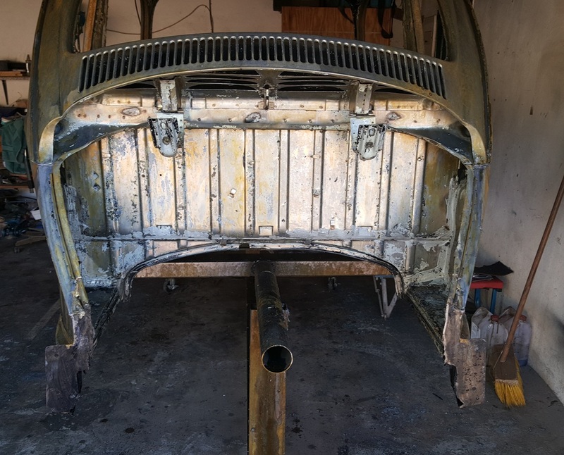

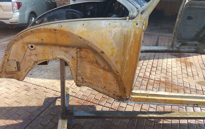

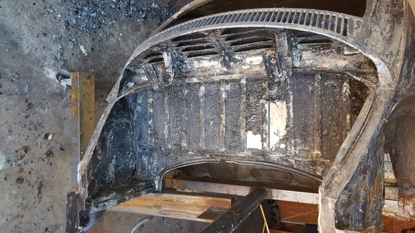

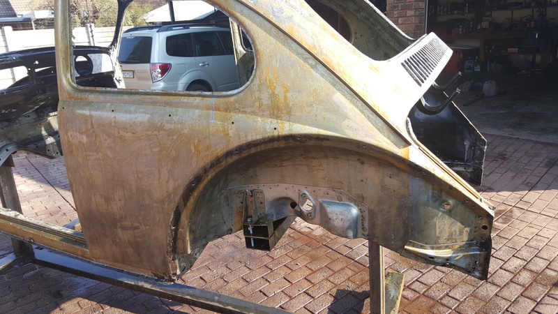

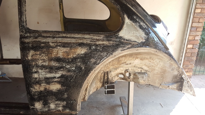

So today we started the stripping, taking all the old paint off straight to bare metal.
Paint stripper, scrapper, wire brush and patience...
The start:
Some panels all done:
The start:

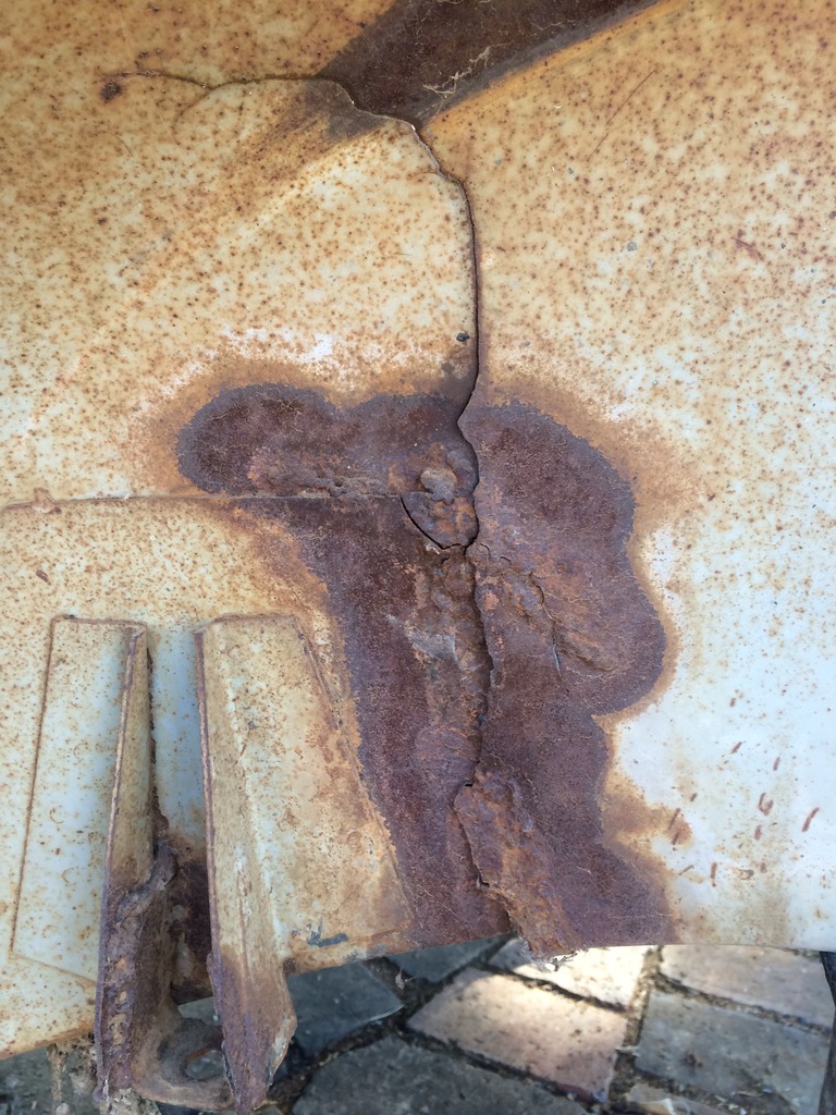

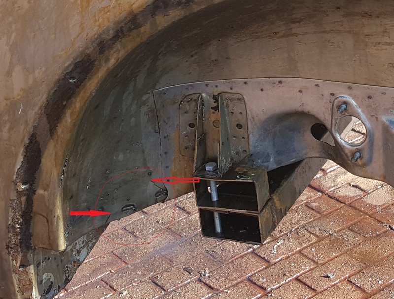

So look what I found after stripping all the paint off, has anyone see this before.
2 cracks on the left side and 1 crack on the right side of the body.
I will drill to stop the cracks as well as well the cracks up.

Pierre, there was no need for me to strip the paint off.merlinpta wrote:So look what I found after stripping all the paint off, has anyone see this before.
- Posts: 158
- Joined: Mon Oct 22, 2007 9:47 pm
- What model do you have?: 1969 Type 1
- Location: Centurion
Re: The Rebuild of "Stoffel" - 1969 Bug
Hmmm wow a little obvious there hehehehe... Crack filler will not fix that at all.

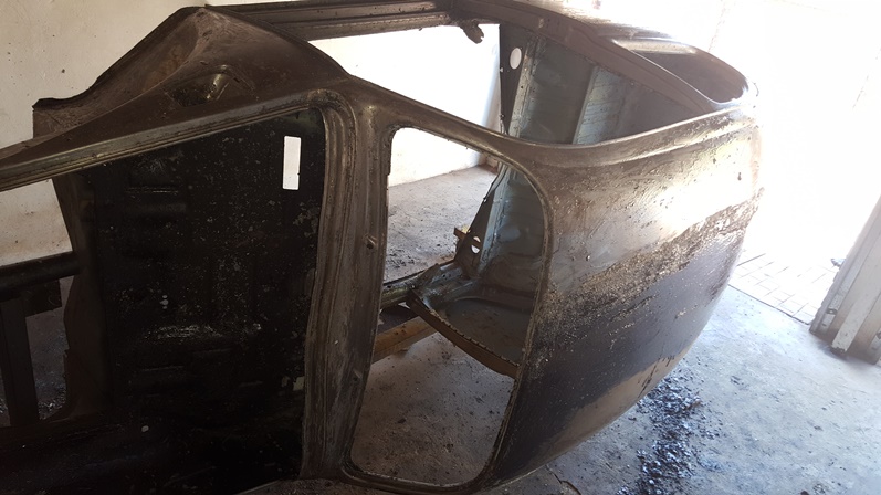

A bit of an update, 10 lt of paint stripper latter, I still have to finish up the roof some of the interior. Need to get some more stripper.
I am very surprised as to how quickly some of the paint comes off as well as to how tough some of the paint is.
Good to see all the bare metal, not finding a lot of rust, some on the skirts on the rear where the fenders mount and a little on the front left corner where the pan meets the bod
Lots of work still to do, want to get the metal ready for Edge primer as soon as possible.

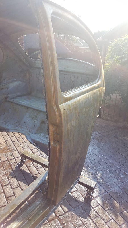

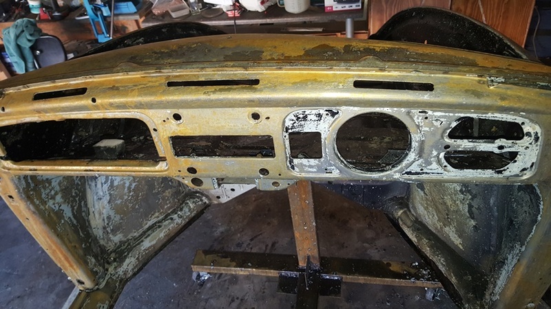

Bit of an update.
Car is now fully paint freeeeeeeee
Now the prep to get some prep on the car begin. This is going to a nice job.
Before I can lay some primer I need to make sure that all the panels and doors ect fit nicely. And here is problem I need some assistance on... I need to replace the door hinge pins. Considering taking the doors to an engineering shop and have them press out the pins, drill the pin holes over sise and press new pins in. Any suggestions as to a place in Pretoria that might or can do this with out bending anything???
Also some final welding to be on the body to get rid of the cracks in previous pics.
Last job I will need assistance on is the cutting of the front beam and installation of "Drop adjusters" and here once again any recommendations.

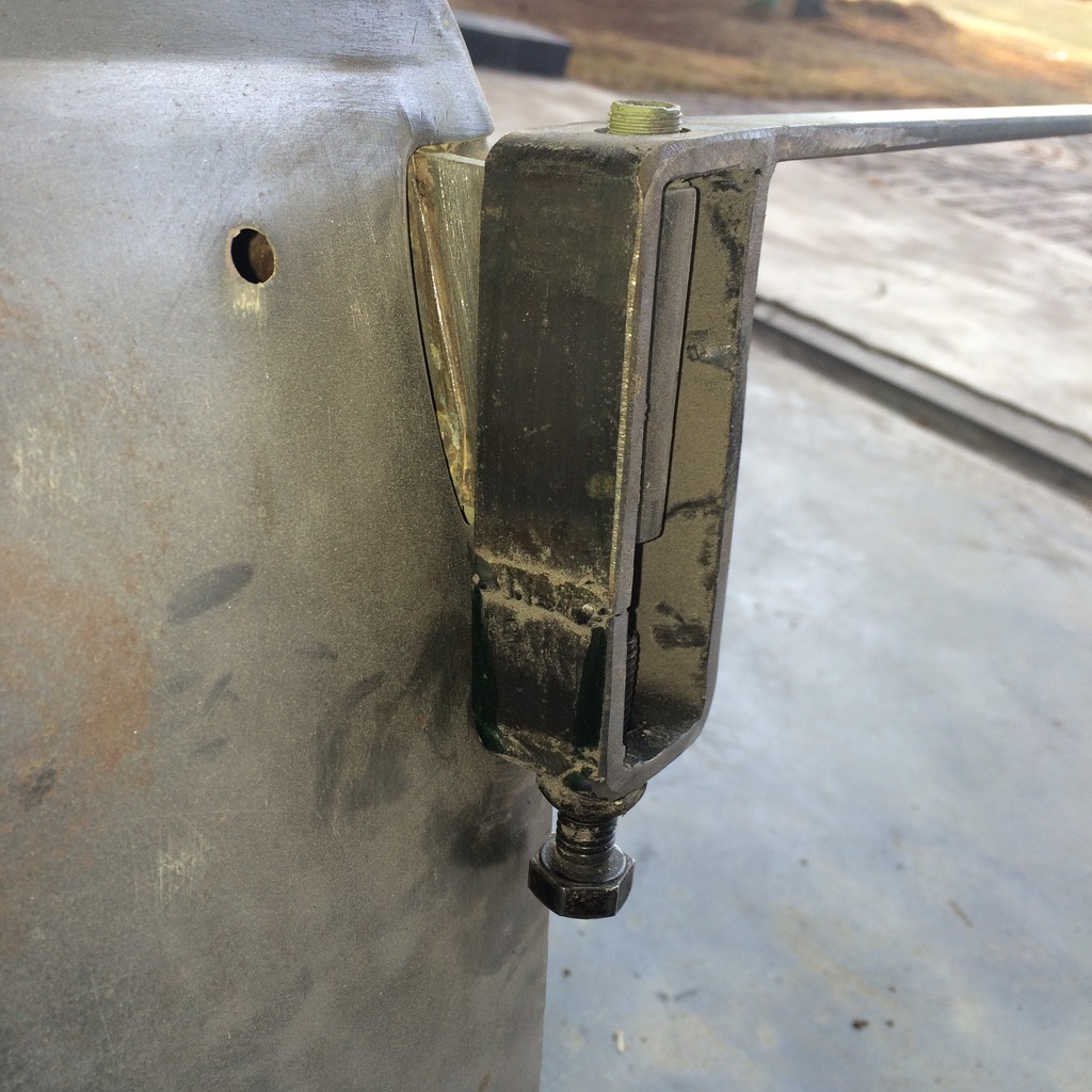

Here is a homemade tool. It works but I will change the 10mm bolt to a 8mm high strength bolt. Will also cut away where marked so it goes with an angle to the bottom to have a bigger clearance between the door.
I got my pins from Wolfsburg West with a reamer. 2nd oversize was better as 1st was still loose in the worn holes. I need to order more pins so shout if you don't have.
