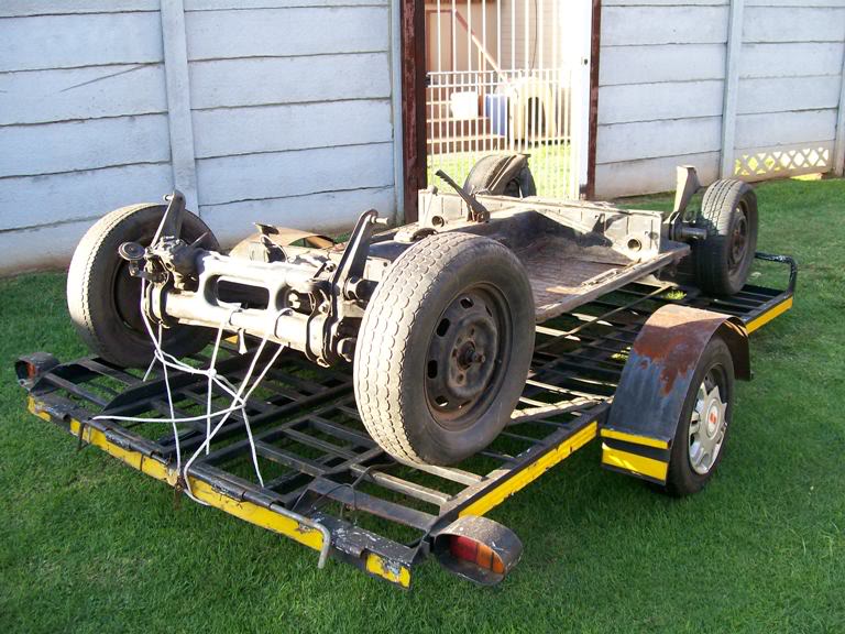

Complete IRS pan, with front suspension and wheels, as I got it

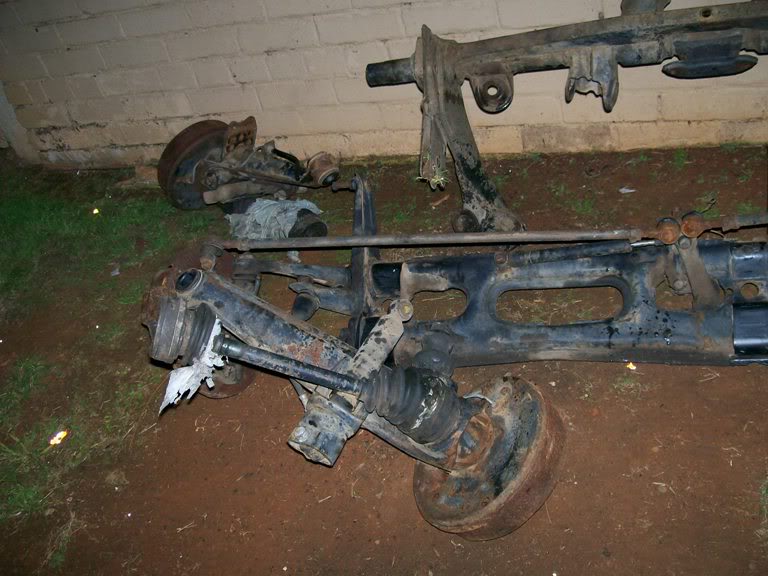

IRS rear with Bugger, the sideshafts on an automatic Type 3 are not the same length
Double rear spring plates per side of the Type 3, compared to the Beetle IRS with only one spring plate per side

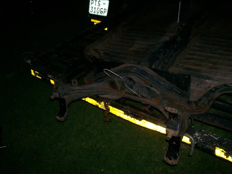

Six bolts keeping the ball joint front suspension with disk brakes to the chassis
Front part of the chassic completely different to that of a Beetle, this chassis is structurally still very good. (Dirk, do you still want to save the Fasty???)

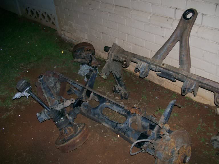

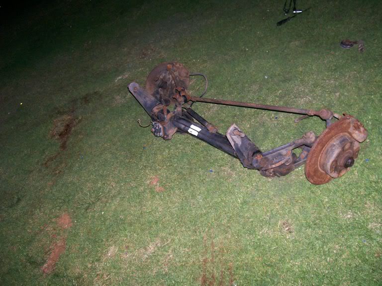

Front and rear suspension parts after being removed from the chassis (everything just bolts off)
This is one of the trailing arms that everything is all about!!

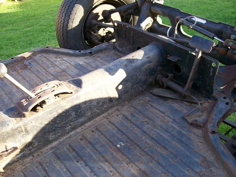

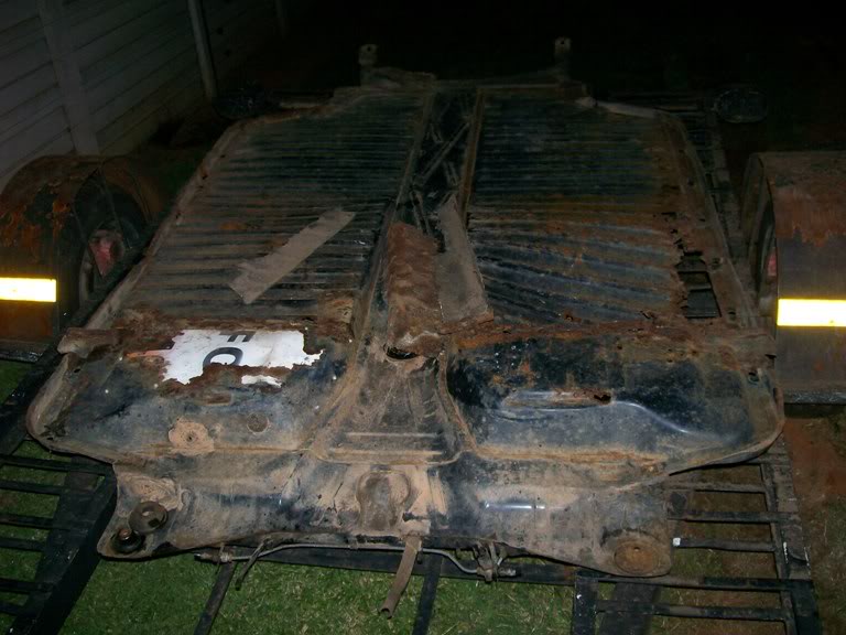

The remains of the floorpan - I will cut the rusted bits out, but keep the centre tunnel for future use
