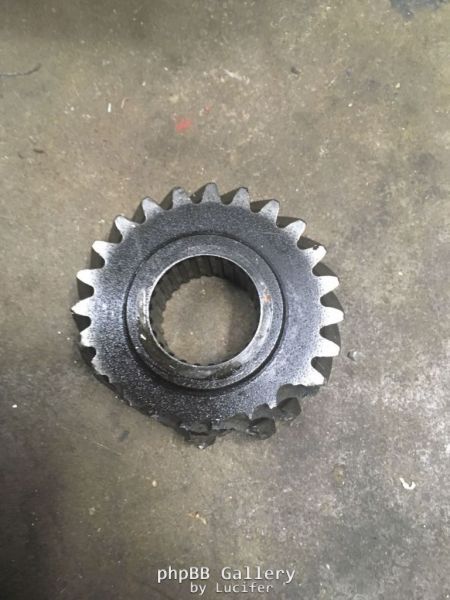

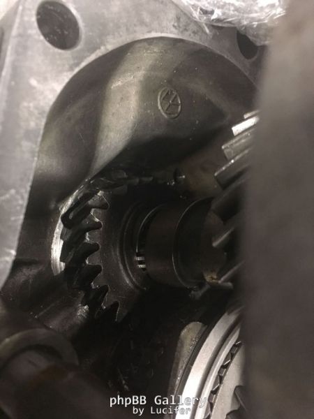

It turns out that I havent updated this thread to show what happened to the gearbox
Bugger took the box apart and his comments are that my engine makes too much torque
Apparently what happened is that 4th gear bend the circlip that holds it in place and pushed it off the main shaft, leading to all sorts of grinding noises...
Bugger has upgraded the retaining system on this shaft to prevent 4th from pushing itself off again
4th gear
4th gear
