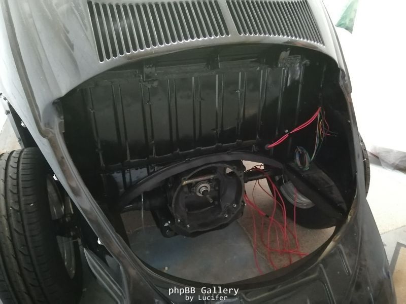

Been going at it again. Managed to get an entire week in during the holiday period. Made a list of all the little time consuming jobs and just did it.
This includes the little things that takes about a day to do and its not even seen.
Also had keys cut for door and t-handle but struggling to get the ignition key sorted. Anyone have a SC code key for me, please let me know.
I know SC is from a later beetle but it fits in the dash and looks original.
Some updates
Installed the firewall/tarboard in the engine bay. Got it from Pro Auto Rubber, they have a few different options available. I went with the one without the silver for the engine bay. This is also the heat and stick stuff, once its on its on. Im happy with the way it came out.
I also used some of this around the beetle where I didnt stick the laykold tape.
First time fitting the decklid. Its not 100% but trying to do it man alone without getting scratches is really hard. There is still a gap at the bottom and its hitting the body at the top. Will play around with it again once the handle is on and I have a helping hand.
Cut all the fender to body rubbers and then fitted the front fender, finished up the wiring.
Then onto the running boards. These are the cheap empi ones. Im quite surprised how well they fit.
But as one can guess the metal used is very thin. Currently making some reinforcement brackets for underneath the boards to take some more weight.
I pulled off the rubber that was on there and got some from pro auto rubber. The genkem reacts with the rubber which is odd. It seems to make it soft and bubbly. Its still not 100% after redoing it three times. I might redo them in future using a different glue.
Still need to do some final trim on the rubber, will do this once everything is bolted in place to get a nice flush fit.
