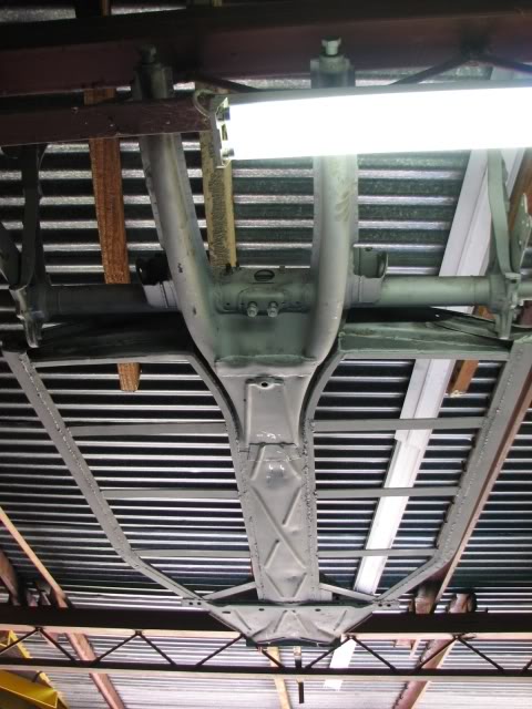

The chassis welding is complete, it is back from the sandblasters and I can go and fetch it on Friday when I'll be going through with a trailer to Potch/Orkney. It is currently suspended from the ceiling in IMPI's garage, so that is reason for the weird camera angle

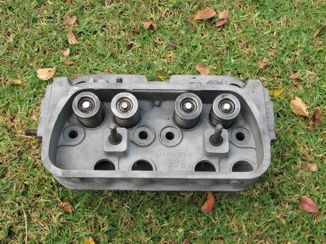

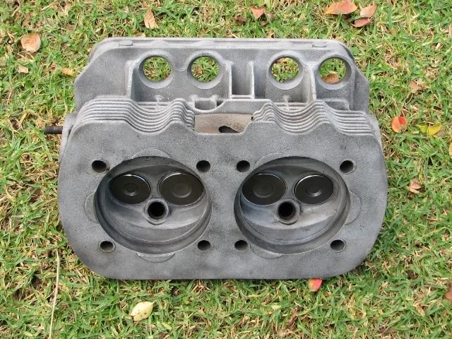

The cylinder heads are back from the refurbishers - shot blasted, new valve guides, valve seats, valves - the works!

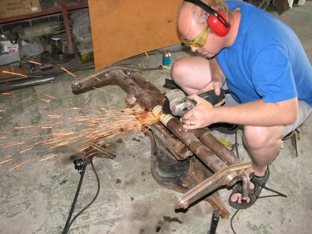

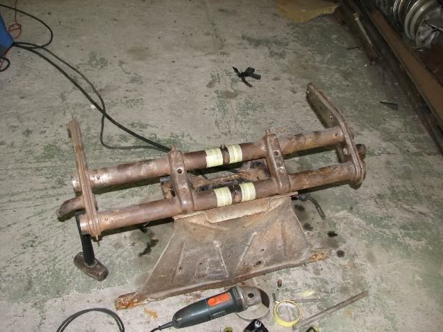

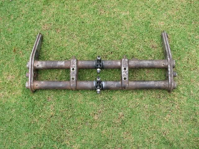

The front suspension was carefully measured, cut and the adjusters welded in - so in other words, it is now an adjustable front supension

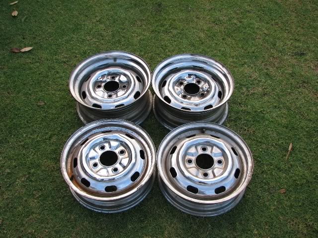

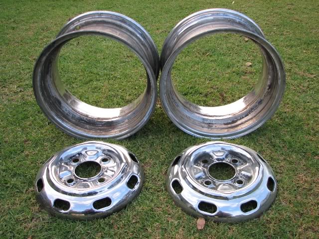

I've had 6 of these chromed Porsche 914 steel wheels for a while. They were clearly on an off-roader before, since four of them were widened to such and extend, that they don't fit on a 914 anymore:

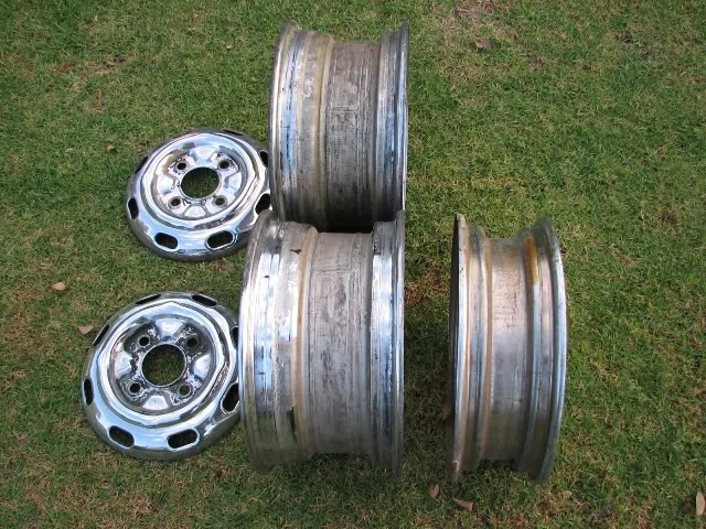

The two widest ones were taken to the engineering shop, and the centers cut out:
In this pic you can get a better idea on just how wide they are. That is a 5.5 incher to the right...

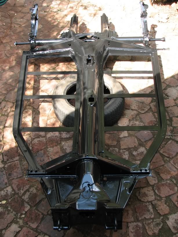

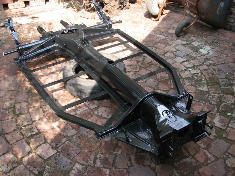

Just got the chassis back from the powder coaters, and I am extremely impressed with the good quality work they did, inside and out!

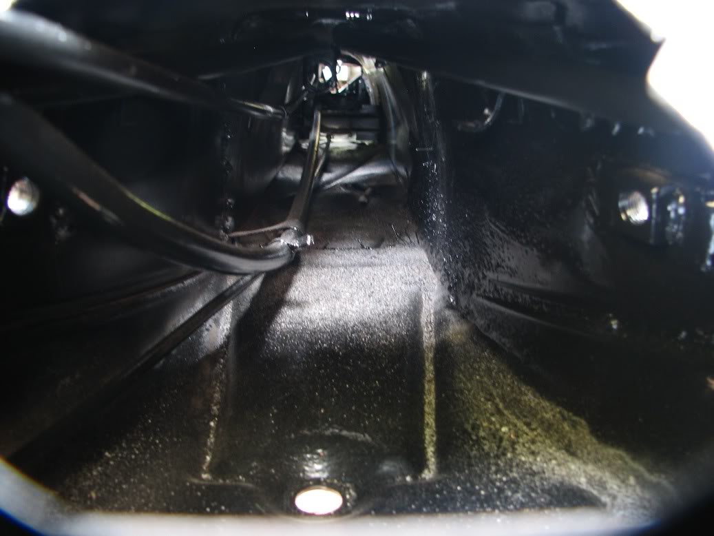

View from the front to the back, through the tunnel

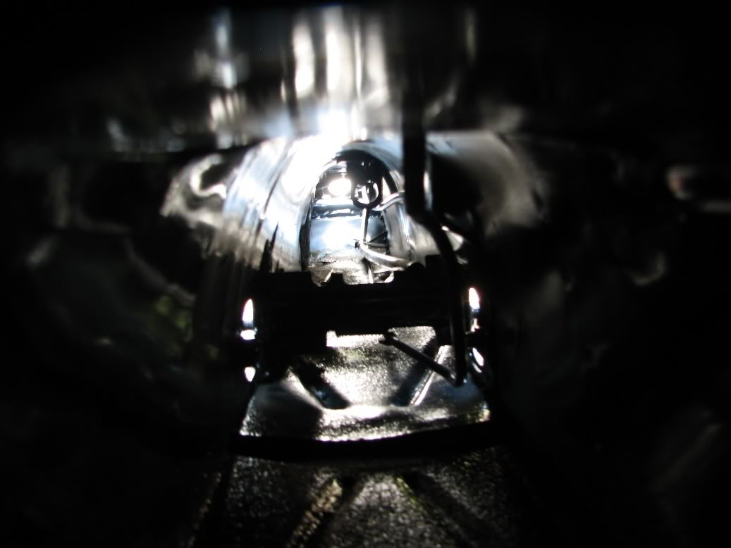

View from the back to the front, through the tunnel

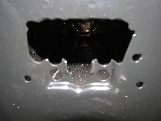

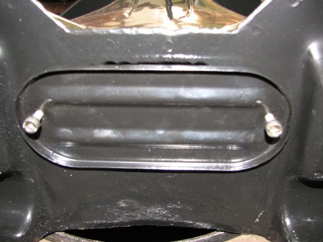

The funny shape of this pressing on the nose of the chassis puzzled me (since it is covered by a plate anyway), but according to Armand it is the only part of SA-built Beetles that remained unchanged between 1951 and end of production in 1978. Those two little holes are no other than the mountings for the brackets of - wait for THIS - the cable-operated front brakes of early Split Beetles!
(The buggy chassis is mid-70's)
The plate that covers the antique holes...
