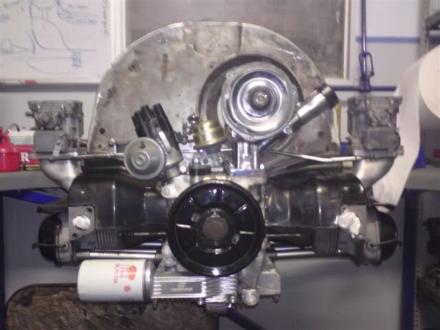

Update 18/05/09 - First engine pics!
Got this first pic of the engine-in-progress from IMPI this morning. Although it doesn't look like much, A LOT of work went into that fan housing. It is a late-model 'doghouse' oil cooler housing, with the heater outlets cut off, and the width narrowed. The carbs are Weber 36DCD7's, which are installed 'sideways' (west to east) compared to the normal 'north-south' installation of an IDF, for example. Will have to see how they work, though...

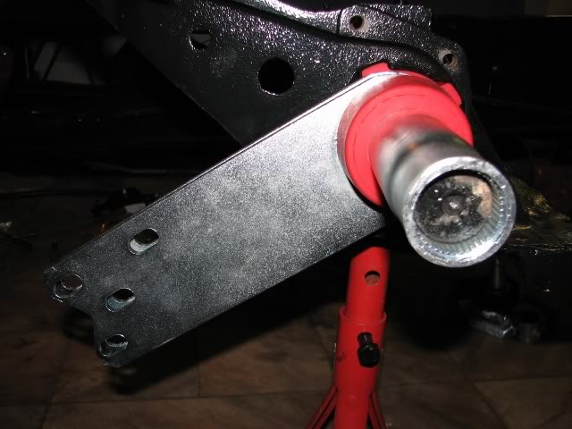

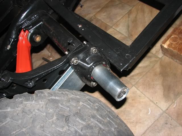

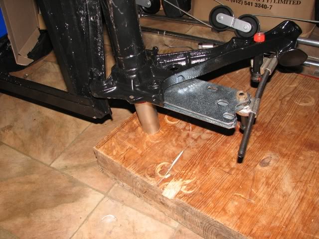

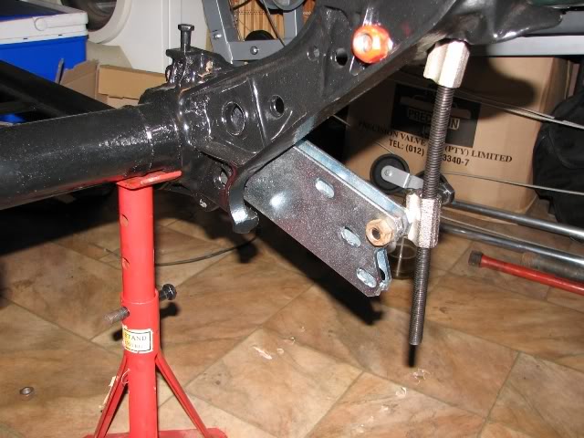

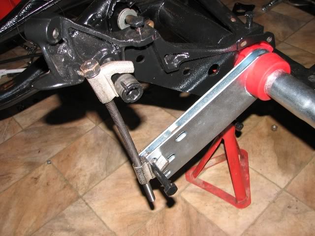

I got the twin spring plates back from plating, and proceeded with re-installing them. It is critical that both the left and right hand side spring plates are at exactly the same angle prior to putting the pre-load on them
I did an experiment, and bought coil spring tensioners for adjusting the rear spring plates. These are normally used for compressing coil springs, when changing shock absorbers, but I 'miss-used' them for my own purpose
It worked perfectly, althoug I got a bit worried when the treaded part actually started bending under the tension, luckily it didn't break
Once the spring plate was in place, I was a faced with a dilemma: it still needed to move to the inside of the splines of the torsion bars, but there was no use in hitting it with a hammer - because, being so light, it simply moved under the impact of the hammer...
So I made a plan!
I turned the entire chassis vertical, put a thick wooden block under the spring plate, picked the chassis up (vertically), and DROPPED it on its own weight on the wooden block...
...and it WORKED
(Once the the cover plates are fitted and the chassis has the weight of the engine and gearbox, the torsion bars will settle to its right place)

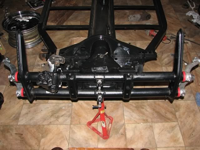

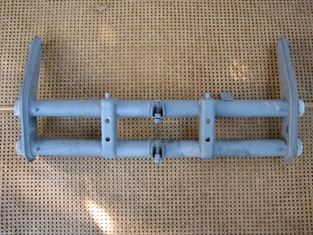

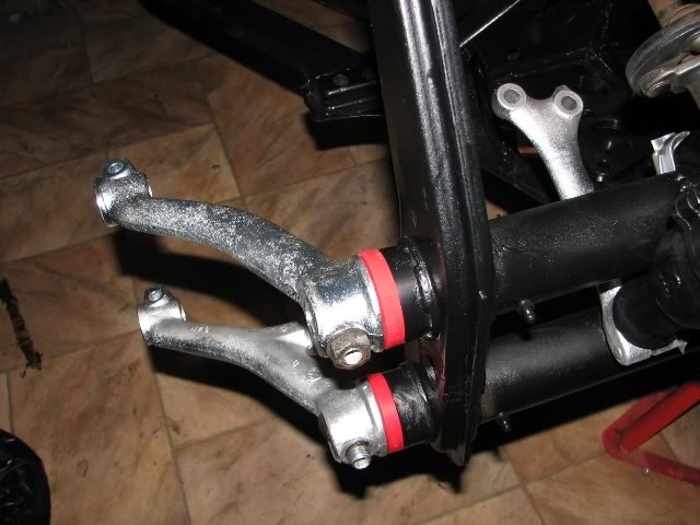

I gave the front suspension in for sandblasting earlier this morning, and within an hour from getting it back, I covered it with etch primer..
Before:
After (and trial-fitting the front suspension and installing the plated front trailing arms)
As mentioned, progress is good so far. The focus will shift to the front suspension/king & link pins for the next week.
So I made a plan!
...and it WORKED
Before:

Thanks, Tony - I said right in the beginning that the buggy build is a learning curve for me. I got a (small) compressor two weeks ago, for example - tonight I sprayed my own front suspension. I am getting very excited now, but try to refrain from taking short cuts in the build. The support on ACVWSA, however, has been amazing - thanks everyone!

pine i want to look at removing my pring plates to get them powder coated and then do something like you have just done with yours any tips while doing this? its looks great BTW
- Posts: 15036
- Has thanked: 235 times
- Been thanked: 234 times
I considered powder coating, but due to the fact that I thought that you actually need to 'hammer' them back on (i.e. damaging the freshly coated finish), I decided against it. Only once the (costly) plating was done, I realised that you won't actually SEE the spring plates, due to the large rear wheels of the buggy... So I guess normal spray-painting will be quite adequate?
