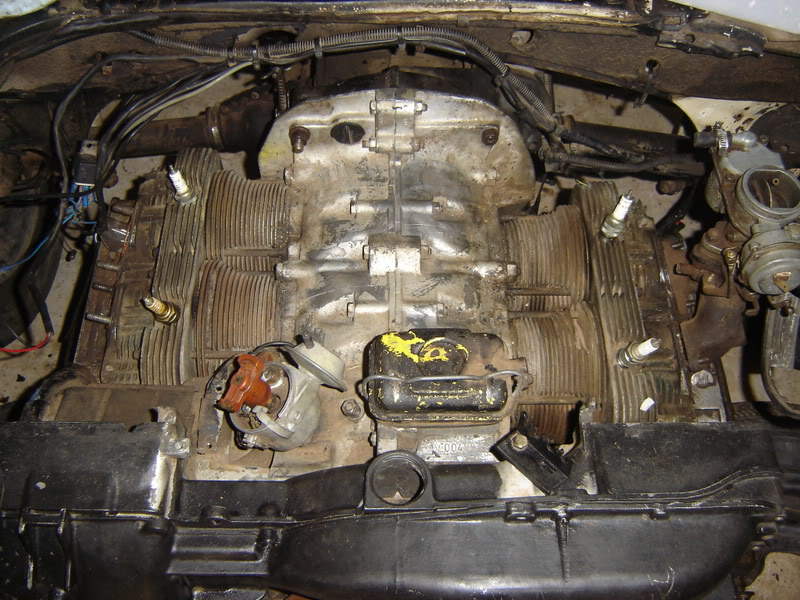

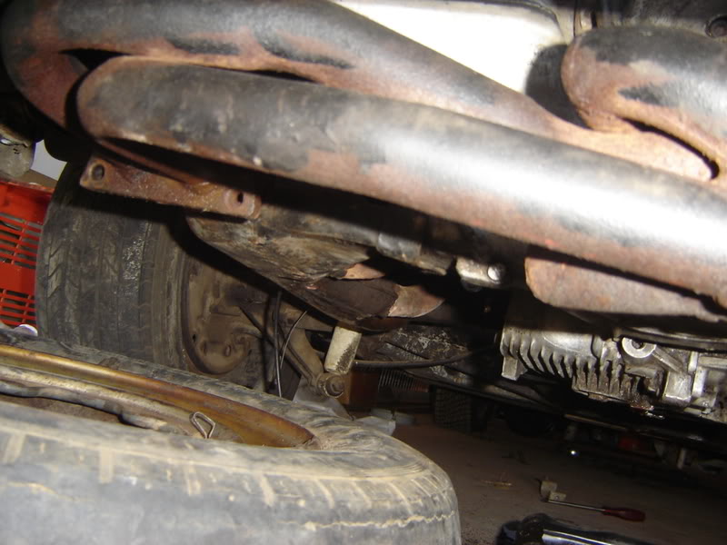

Here is the engine installed. I still have to remove the silver paint from the block with a wire brush. The cylinder tins are currently stripped to bare metal and are awaiting a shot of paint.

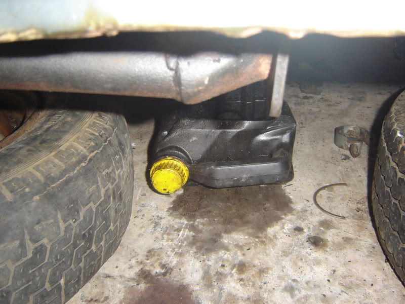

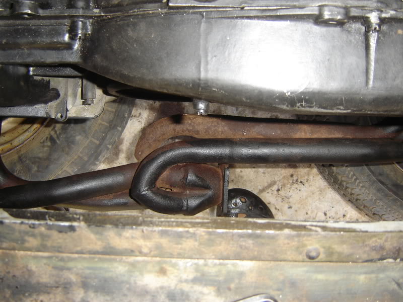

Quick pic of the 4-1 exhaust - Will be painting it with fireplace or normal automotive heat-resistant paint. I also need to find a Yoshimura 'bike muffler for it.
I first thought that we would have some clearance issues with the exhaust and rear valance, but I'm pleased to say that everything fits perfectly

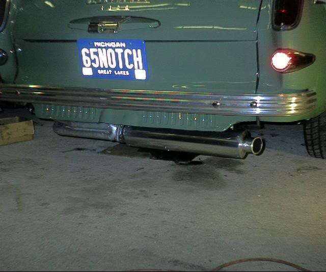

Ever since I first came across this picture, I've wanted an exhaust exactly like it.And now I have something similar
I'm going to try out that 'bike muffler for now, if it's too loud then I will have to go with a suitable Bosal silencer.

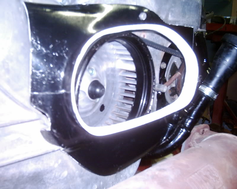

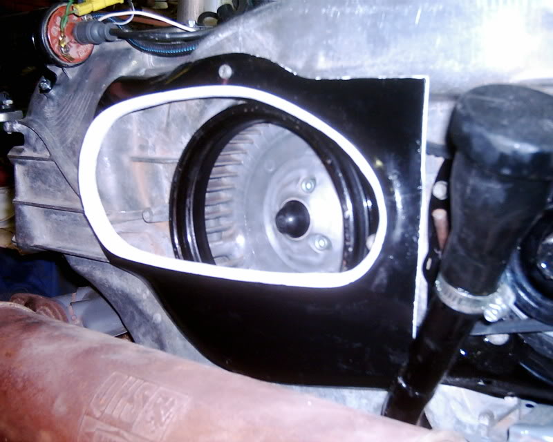

What I also need to get is one of these fan shroud adapters.
Due to the rear valance being hacked when it was WBX converted (And in the process losing the ring that the fan boot normally attaches to), I will make a custom boot from a truck air cleaner coupling and a fibreglass sheet to patch the area that was cut out.
Of course, it will be properly fixed with the correct metal when we change the entire rear valance, someday in the future.
Will be contacting IMPI Renn Werk for one of these brilliant adapters as soon as I get the stuff that I'm supposed to get for IMPI
