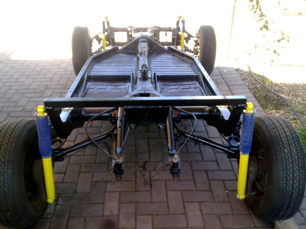

by retrovan » Sat May 05, 2012 10:08 pm
arnocill wrote:
Are those, std shocks or coil-overs.
Can not wait to see the final product.

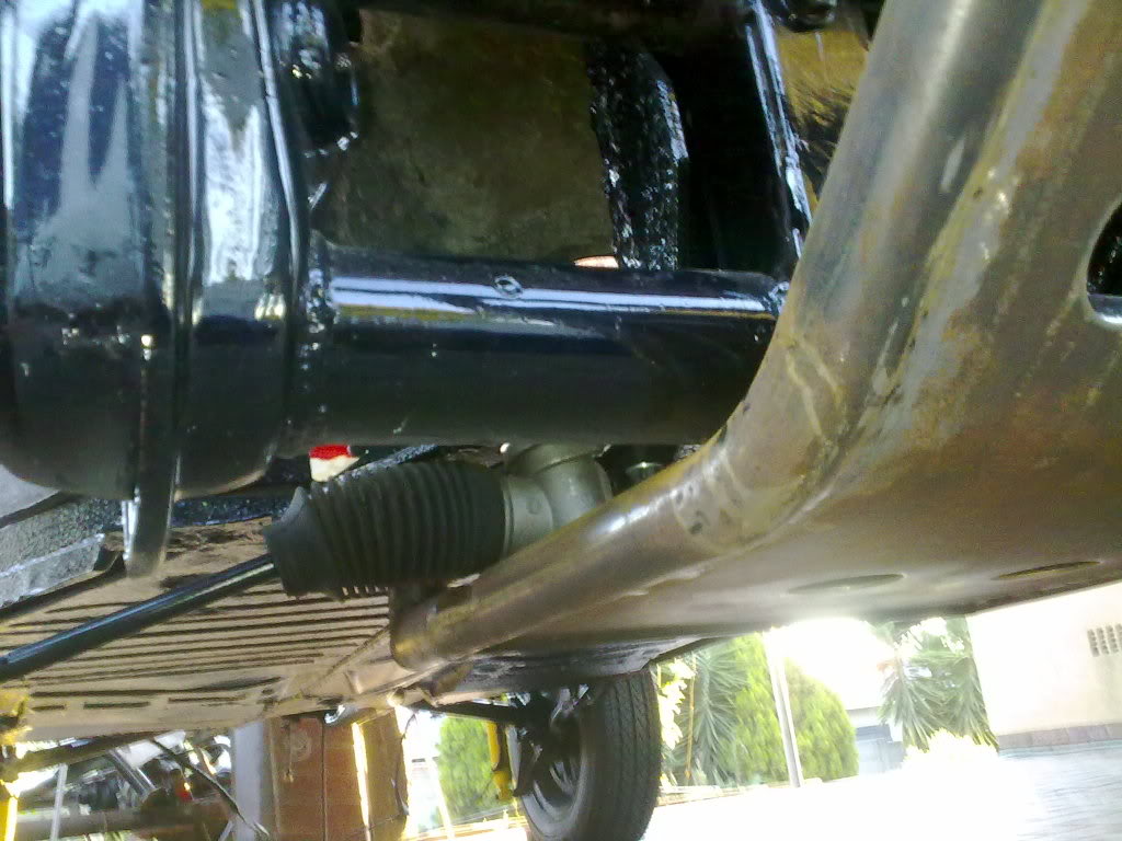

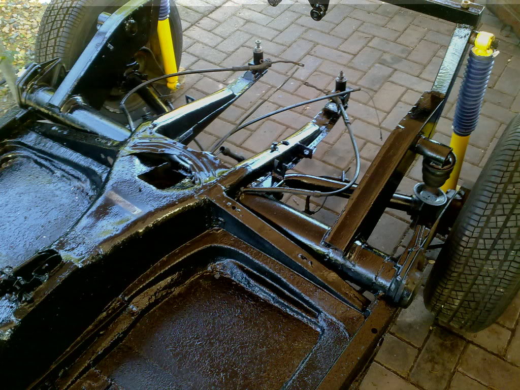

by arnocill » Sun May 06, 2012 8:36 am
Thanks guys.
It's standard gas shocks, all i did was to cut off the upper tube of the shock and fit rubber dust covers to give it a different look.
I can't wait to get it finished and drive it either, at least i got a whole winter ahead to get it done

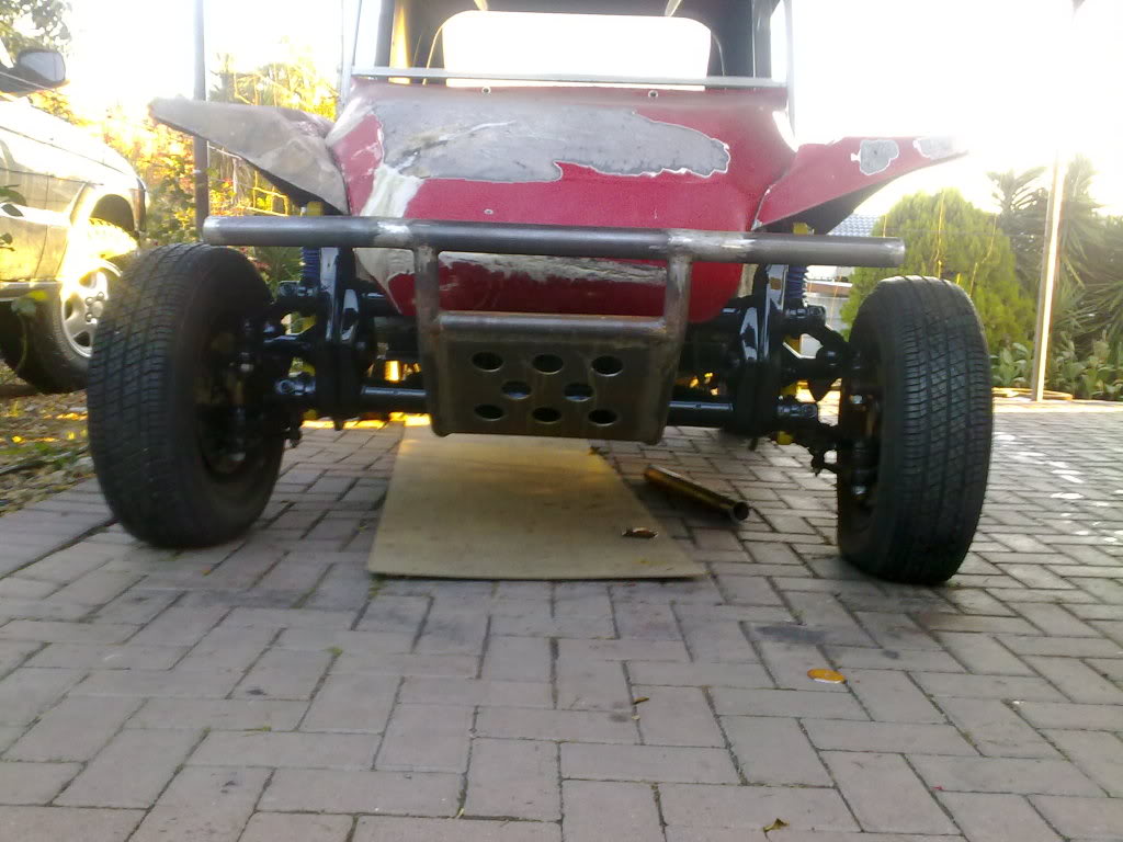

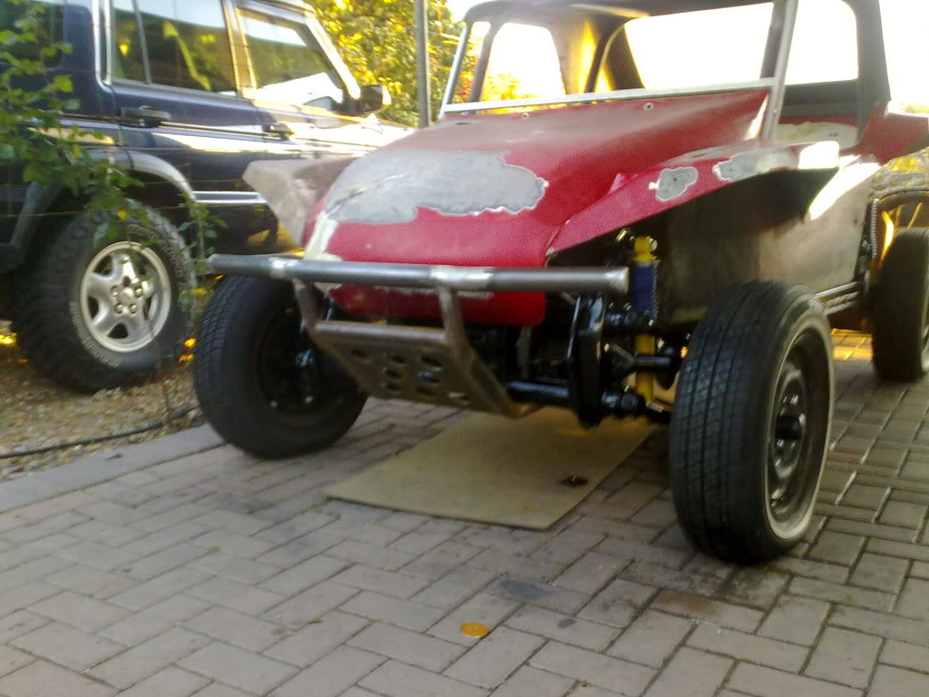

by Tony Z » Sun May 27, 2012 7:30 pm
that looks pretty insane!!!

by alants » Mon May 28, 2012 11:54 am
Wow >>>> way to go !
Just love ther rims - keep the updates coming

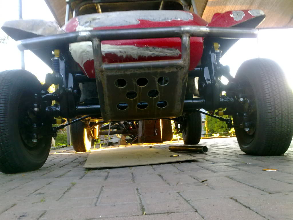

by hitlers revenge » Mon May 28, 2012 6:14 pm
Is that Golf steering racks you are using???

by arnocill » Mon May 28, 2012 6:39 pm
Yes thats correct, mk1 Golf to be specific
