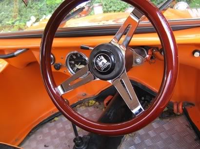

Thanks, Guys. The steering wheel is currently on the Khaki Cruiser - I have done some measurements, and unfortunately it is too large for HW2. It is, however a great improvement on the original Type 3 steering wheel, and I even managed to get the horn working!
HW2 will most probably get a smaller 'woodrim' steering wheel, like HW1 had, in spite of the fact that the bottom spoke of it ripped my top right leg open in the accident...
