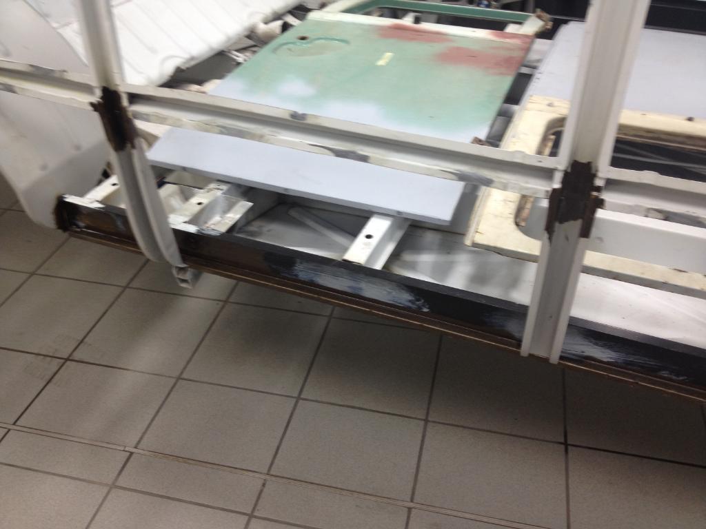

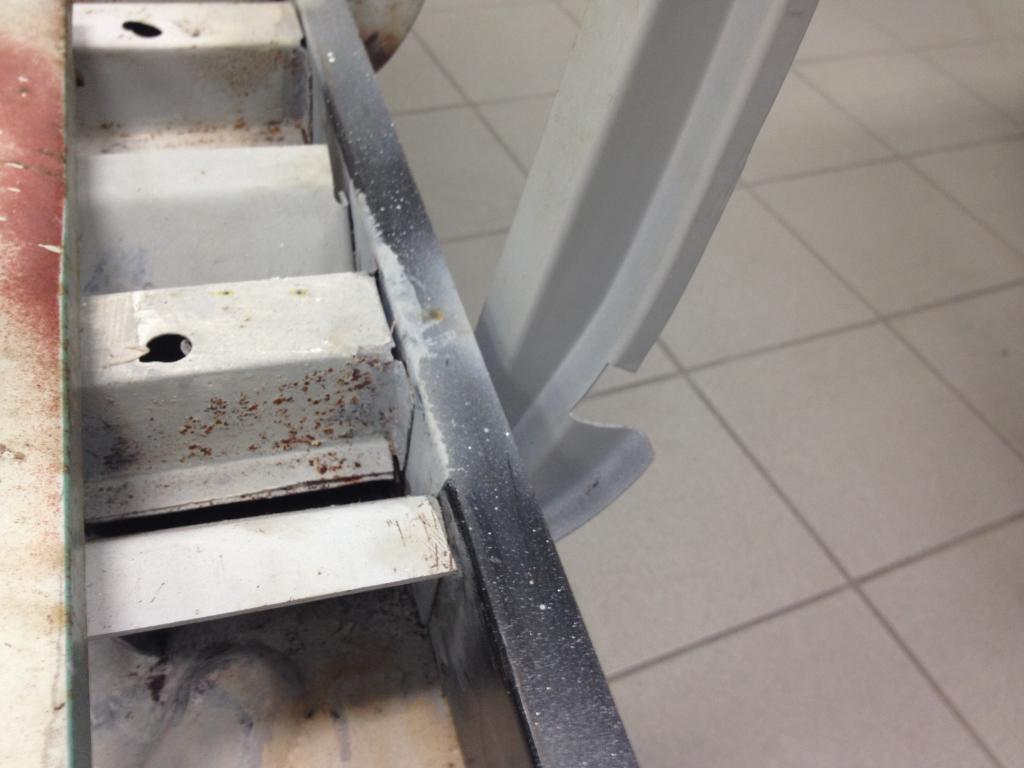

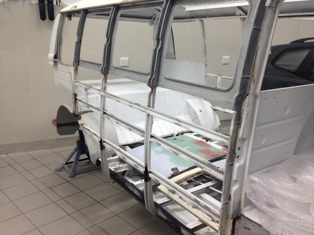

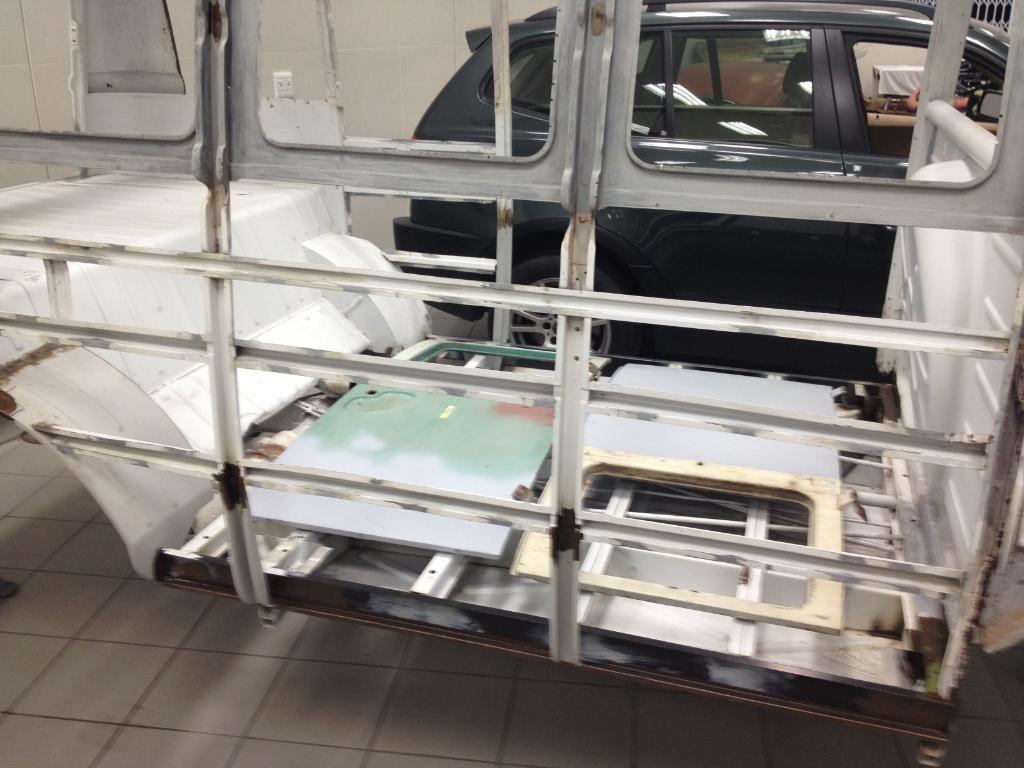

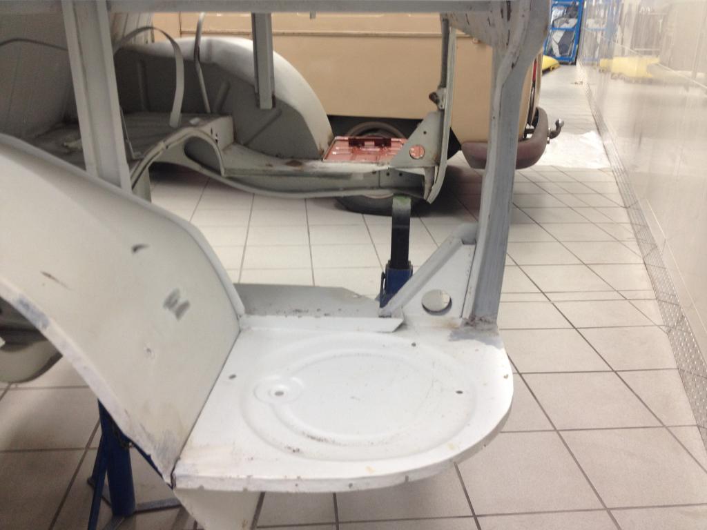

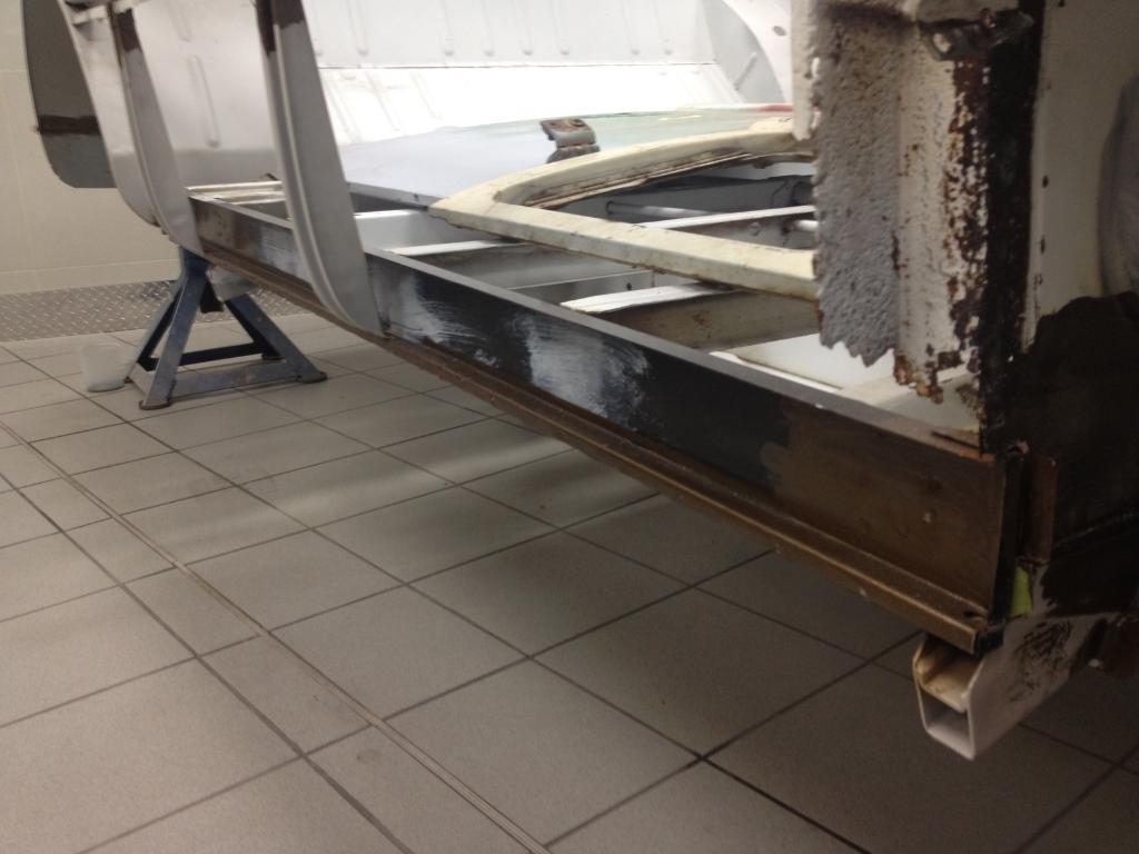

Post by splitbusahollic »
Bugger wrote: post that lesson here then some of the other guys that also get confused have a quick reference guide on this thread
A pillars - the front two pillars that the front doors hinge on.
the inner valance and outer valance is removed, only the headlight carrier panel is left.
B pillars - behind the driver and the one that the forward cargo door hinges on.
only the pillar on the complete right of this pic is the B pillar...the other two are reinforcement pillars !
C pillar - the one that the rear cargo door hinges on.
reinforcement pillars - the ones on the inside of the long panel running from top to bottom.
here are some additional pics of the air filter tray and the battery tray
and these are pics of the inner rocker KF 531 fitted
and these are the Jack points
