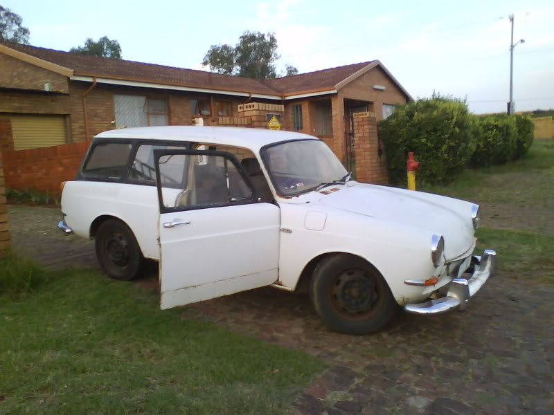

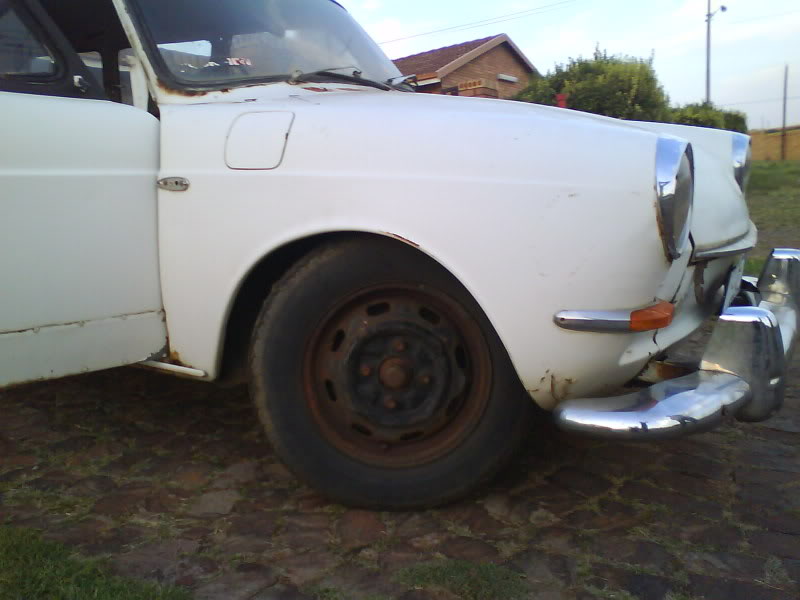

Okay, so the IRS and disc brakes came with this '69 Variant attached
Was by pure chance that I got this car. About two weeks ago, a guy was driving by and stopped after seeing the white fastback in the yard. He told me that he had the Station Wagon version and asked if I was interested in spares. I said no, not really but when he mentioned that it had the wheels with the 4 bolts and Automatic transmission, I suddenly became very interested
He towed it from Roodepoort to my place using a 1500 Beetle and an A-frame
Took something like 2 hours....
I will be stripping this car over the weekend for any other usable bits and get rid of the rest
The disc brakes will go on sometime in the near future, the IRS will stored safely away until the rest of the parts needed for the conversion are sourced.

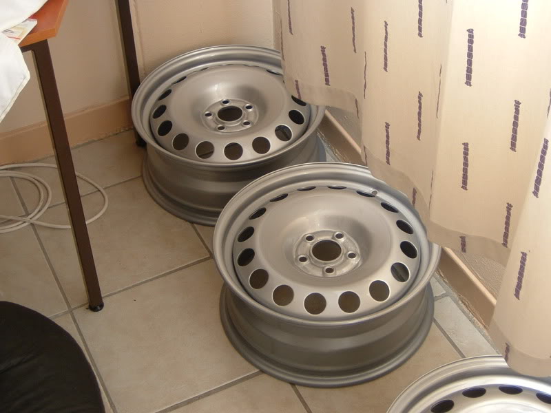

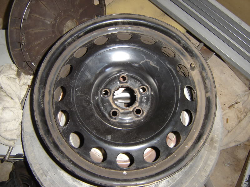

I have finally decided on the choice of wheel. After seeing the Radel Beetle with them one, I have decided that the Jetta steel wheels would look quite cool on the Blitzmobile. I have to mention Karmakoma here - he was kind enough to give me the ones that he had - THANKS A MILLION DUDE
. I picked them up a few weeks ago and they are pretty straight. I only have 3, but have already started looking out for a 4th one.I will put these wheels on after I finalize my disc brake conversion, hopefully in time for Ferdies Swop Meet in August

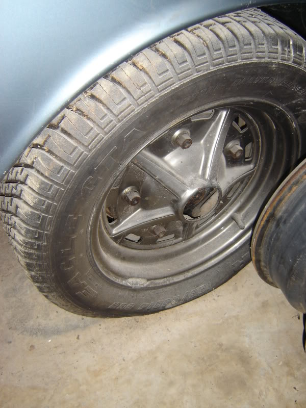

Still standard, complete with brake dust and all
Here is what they can look like - this set was fitted to a forum member's MK1 Golf
The plan is to have the wheels acid dipped and then powdercoated in BMW Silver Grey. The Rostyles that came with the car were in a dark grey colour, so I think that the Silver Grey wheels would contrast nicely.

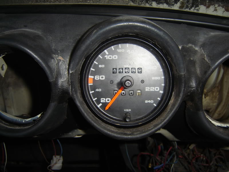

I have also received my Porsche 924 speedometer. Decided to give it a trial fit and it fits snugly with a few minor mods!
Amazingly,the Type 3 cable screws straight on and it works perfectly with no mods at all. The best part of this speedo is that it has a trip meter and it runs off the front wheel, so it should be accurate. It would have cost me at least twice the price to import an original Type 3 KM/H speedo from the UK, so this was a perfect option

Those wheels look great when done in silver! Cool Idea, and fitting a Porsche speedo is also going to look GREAT!
btw. If I remember correctly, I had 205/55/16's on those rims. Nice and wide
