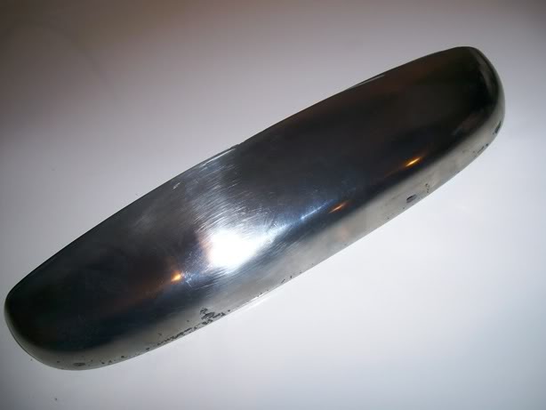

I have started removing the paint of the Ghia housing with a wire brush on a drill, but it is a bit harsh and leaves scratch marks... I wet-sanded a small bit out with 1000 grid paper and then polished it, the shine is quite amazing, but it is a helluva lot of elbow grease. Dunno what it is made of though? Aluminium, or some kind of pewter?

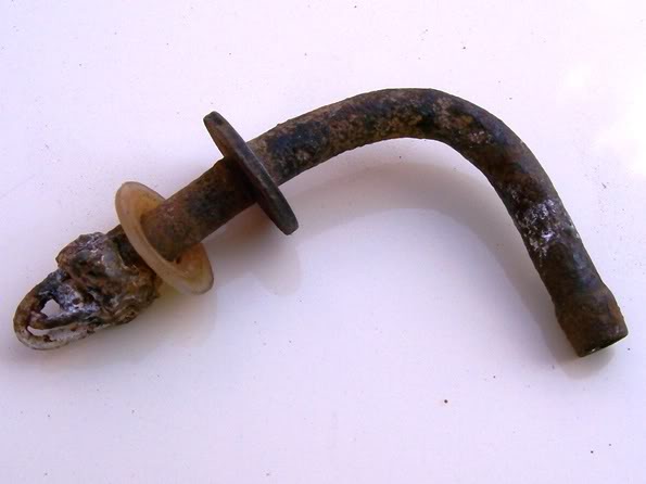

The yellow NAM buggy I bought last year did not really donate a lot of parts to the HW2 project, the chassis was so rotten it was cut up and thrown away, and the bodyshell and other usable parts were put in storage.

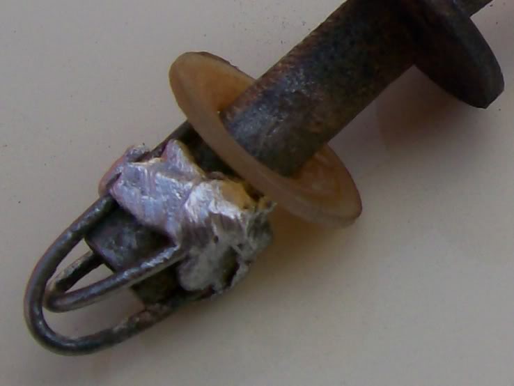

However, this afternoon I removed the little pipe from the bottom of the yellow buggy's fuel tank to see if it is still usable, and found this :shock: :
Like a marine archaelogist, I carefully wirebrushed the part that fits in the tank, I eventually saw what it is - some previous genius brazed two u-shaped wires on the pipe's end - probably to prevent 'large' pieces of junk from blocking the tank! :lol:
Dont fear, my dear friends - HW2 will get the proper strainer inside its tank :wink:
What's wrong with that? I'm sure the engine can handle the little bits this doesn't stop :TIC:
Dutch_Diver wrote:What's wrong with that? I'm sure the engine can handle the little bits this doesn't stop :TIC:
Uhm... well HW2 is supposed to get a Boxer in the rear -
NOT to be confused with an Osterizer :lol:

The Ghia license plate cover is taking a lot of time to get clean - I first used the wire brush on the electric drill, but that was a bit too harsh and I had to sand out all the scratches, starting with 600 grid, then going to 800 grid and then 1000 grid sand paper.... almost done, but there are still a few pit marks at the bottom that needs to go

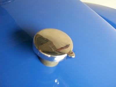

Take, for example the center-mounted filler cap, which is from a Triumph Spitfire - it was destined to be on the bonnet of HW2, but now it won't go there anymore...
....because I found THIS one today :hangloose:
Dunno what car it is from (Mini Cooper, Cobra?), as the bottom says 'England' - but I LOVE it! It is not perfect though, and will most probably need a full rechrome :( (Can you say $$$?)

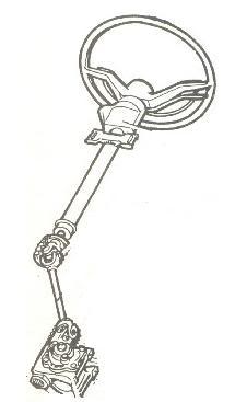

As for the rest of the build, slowly but surely things are getting into place, but the Buggy is still a long way from being finished. One of the biggest obstacles in my way was the fact that the steering shaft mount in the body is not straight over the axle of the steering box. The Lolette bodyshells are moulded with a very specific place where the steering tube passes through the 'firewall', and there is not a lot of space on the dash to move the steering column mount around. This has the result that the steering shaft runs at an angle in the length of the car from the steering wheel to the steering box. In other words, the steering column will not be parrallel with the transmission tunnel, and an imaginary 'North-South' line drawn from the front to the rear of the buggy. I am not very happy with this idea, as it will also mean that the steering wheel will not be parrallel to an imaginary (West-East) line drawn from the left to the right of the car, when placed in the centre of the driver's seat. An angled mount will also put strain on the coupler between the steering box and the steering shaft. My idea was to use two steering knuckles, like this setup in a 1303 - the top one brings the angle down, and to the left and the bottom one justifies the angle to the right.
After going through my parts stash a while ago, I found the top steering knuckle and shaft (which I forgot I had :oops: ), and found the bottom one on a 7-series BMW at the scrapyard this morning. This is the 'dry' setup, looks like its gonna work! 8)
A safety advantage of the setup is that in a head-one collision (which I really, really hope an pray never happens!) the steering shaft will hopefully break 'away' to the side, instead of making a Pine skewer :shock:
