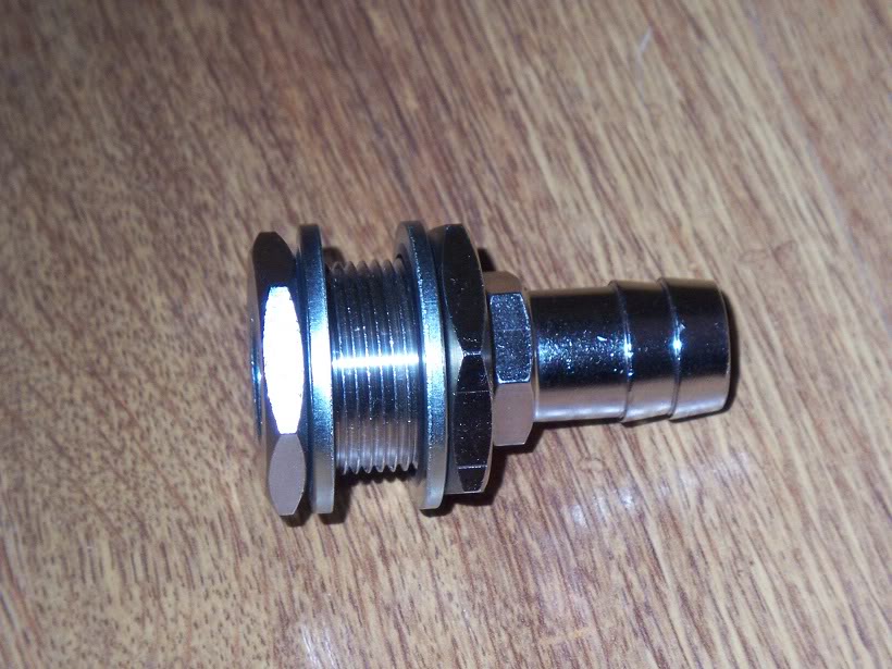

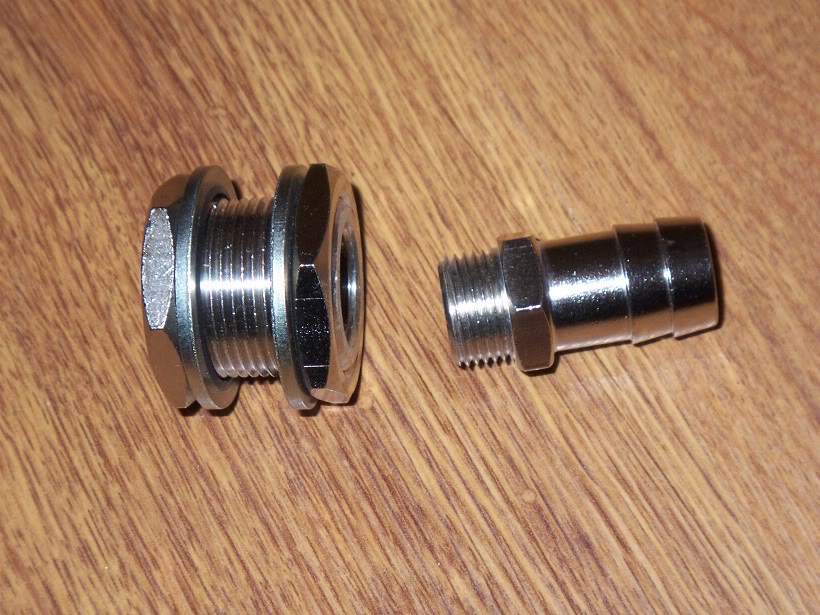

new fuel tank fitting

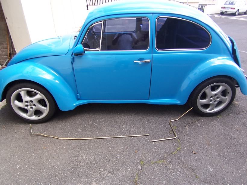

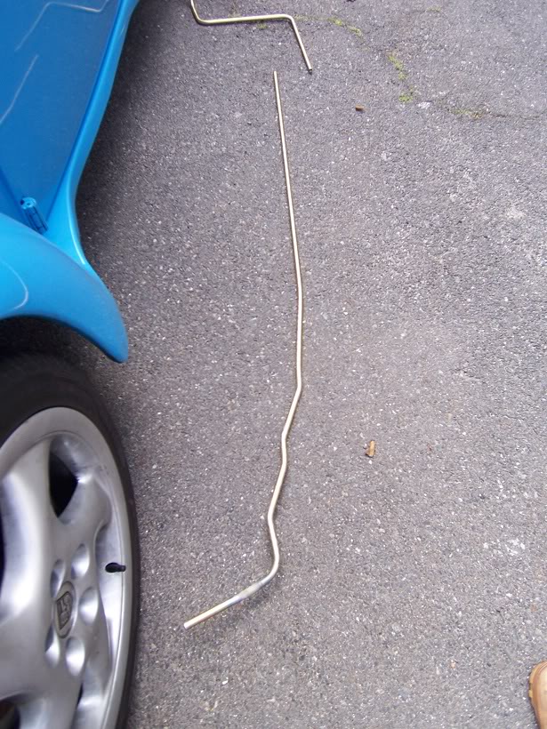

Fuel lines after being made up according to a sample I made. Note, I had to make it in 2 parts to allow the stock jacking point to still be used while not damaging the pipe.

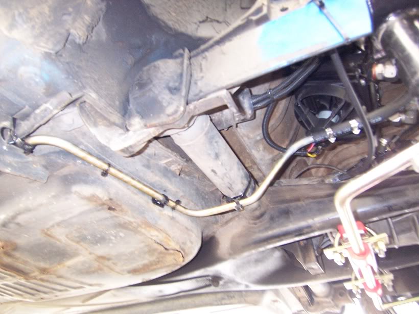

Rear half moving from under the heater channel to near the gearbox - you can also see my nice little oil cooler

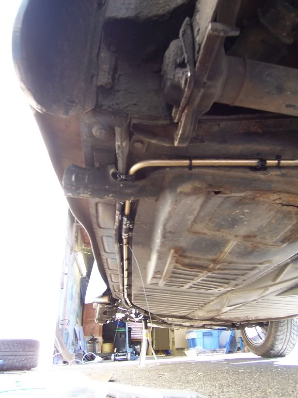

Running from front to rear under the heater channel

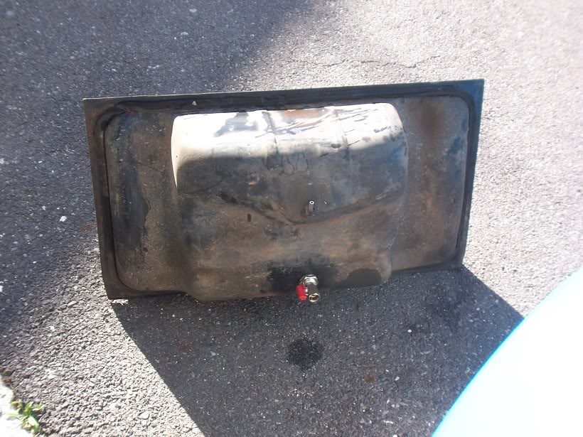

Fuel tank - note the original fittings still in place allowing for me to use the stock fuel line as a FI return line oneday.

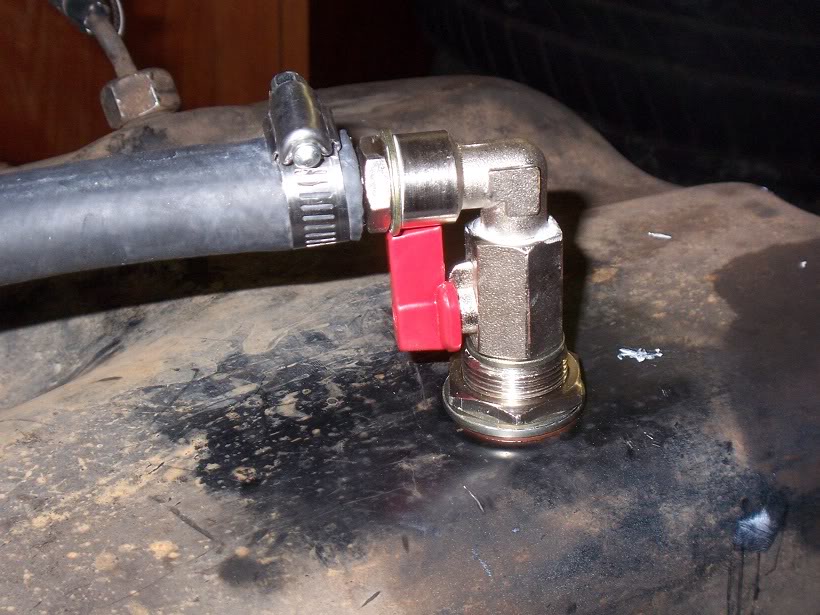

Fuel tank fittings with shut-off valve

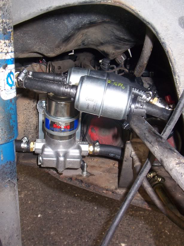

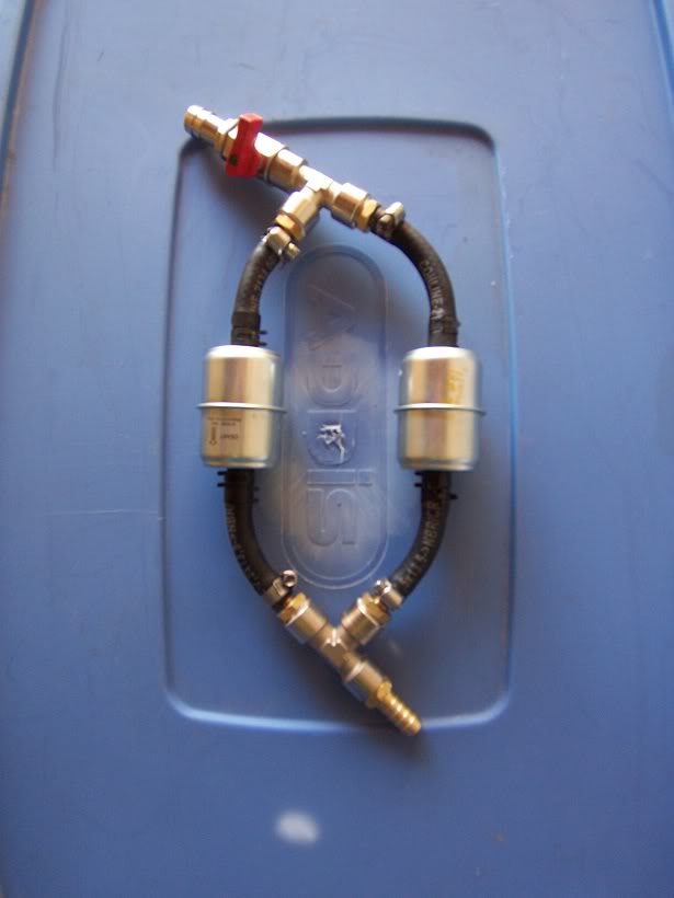

Fuel filters and T pieces - note the shut off valve allowing for hassle free filter changing.

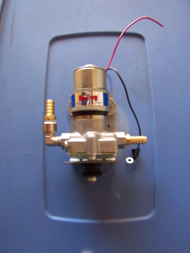

Fuel pump - Holley Blue
All installed and tested

Nice work ! Are the fuel shut off valves easily available? Great idea ..............
- Posts: 14992
Re: My bug - ANGRRR - the ongoing project (new name)
any hydraulics hose supplier will have them
