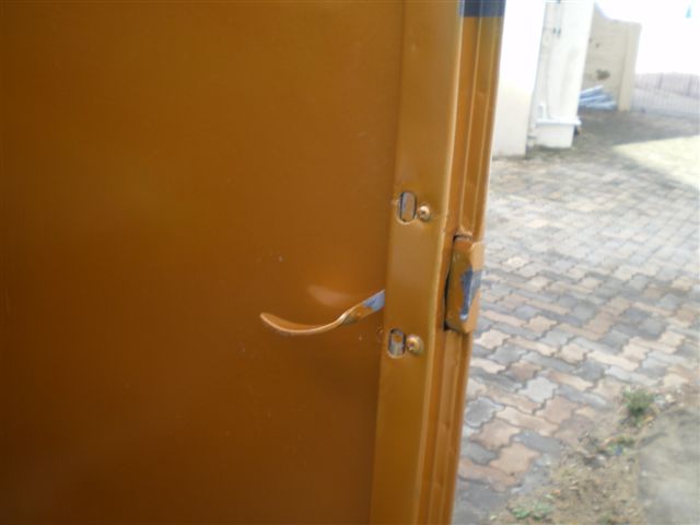

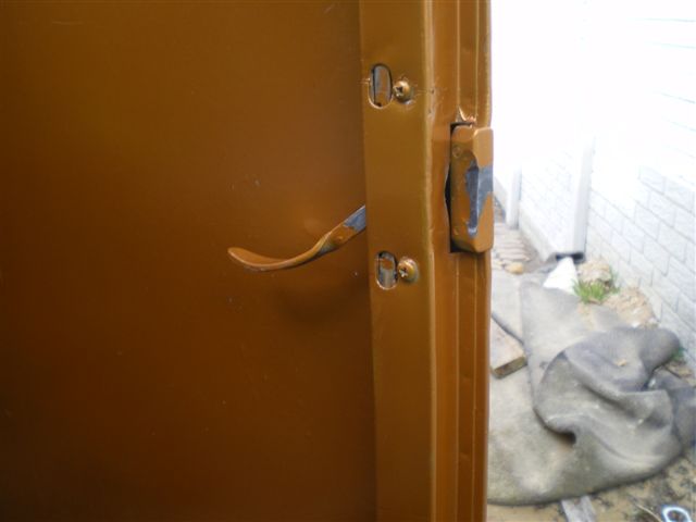

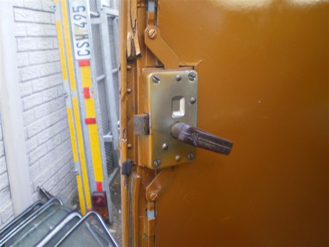

Mark, here are the pic's of the door latch you asked me about, hope it helps.
This door has no latch to the other door, only two slides that run up and down into the body, and has a big steel block for the other door's latch to kick against.
The block you see on the 2nd opening side door, does not move, its just a block for the other side to lock behind.
This door also has two slides that go up and down to lock into the body, as well as the latch you see here.
