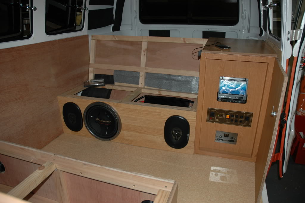

Dutch_Diver wrote:BF...the lights are for a ZIG unit that I purchased in the UK and bought back in a suitcase. It's a cool piece of kit that usually in fitted in campers and caravans. It allows for you to plug into site 240v electrics as well as hook up a leisure battery & car battery charging both when connected to 240v or when driving. I have all the internal electrics now on a leisure battery so that the bus will always start after a hard night of partying :) I gave the fridge a miss as I could find on in SA which could do 12 & 240v and was a proper fridge not a cool box. Looked for ages and I couldn't fit a UK one into the suitcase :(

I have some plans to build a Zig unit. Haven't really checked it out in detail as I am going with a National Luna dual battery setup.

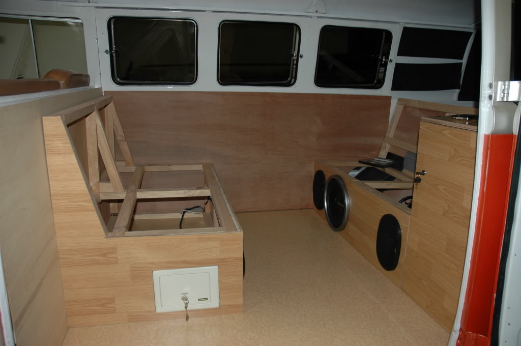

please tell me the 6x9s and the sub dont share the same box...
They do but it's an American Amps 4 channel and 3000w...sounds great!
:) I think it might be more a case of the sub's throw that could damage the cones of the 6x9's
Is that what you were thinking tony?
Posts: 15010
yip, the pressure made from the sub moving will force the 6x9s to move, thus distorting their sound
Oh.....balls....the holes are there now so I think I'm too late. I will see if I can put a few dividing partitions in to separate. Does the box have to be nearly airtight? or is it just a matter minimising the air flow between the speakers?
Posts: 15010
just put a small box around each 6x9 if you cant put the sub in a box.
BTW, a sub is supposed to be in a box to make it sound better.
I thought once the seat top is in place it would be in a box....just one big box (110 x 40 cm)? Will look at now as heading out to garage.
Posts: 15010
yea, it will be. Problem is pressure from the sub moving in or out will have to find a way out in an attempt to get back to atmospheric pressure (rules of nature and science) and the easiest place to go is to move the cones of the other speakers. Put the seat on, disconnect the 6x9s and run the sub hard.... watch the 6x9s bounce
I tried that tonight and the funny thing was everything bounced.... :) I though a Taxi was going past :D. I need to work on this more.....I had no problem wiring but really didn't understand the science behind sound....
I'll try more ideas over the weekend 8)
