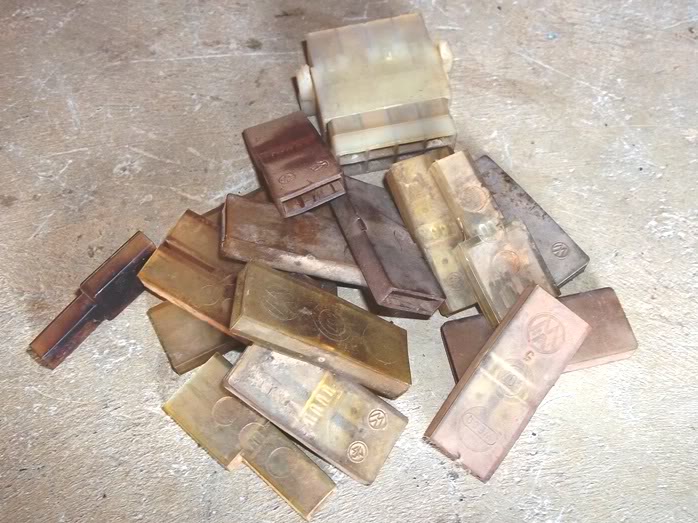

As I mentioned earlier, these are the original VW connectors I am using for wire connections and splits - absolutely NO insolation tape and coloured 'Hypermarket special' terminals were used for the buggy.
This is what the terminals look like after they are sourced at the scrap yard (R 5 each at Volkspares, R 2 each at vdBrinks)

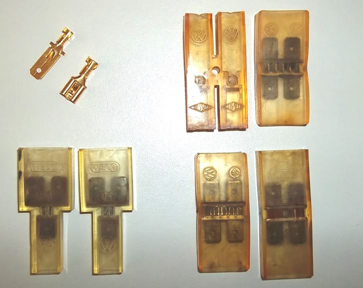

After a cleanup (i.e. throw them in the washing machine with a bunch of clothes), they look a lot better :wink:
The two at the bottom left are the most difficult to find - not a lot of Beetles have them, but they are used on all 411's and 412's - they basically split a circuit into two (i.e. flasher left rear and left front)
The ones at the right are common on Beetles, and splits a circuit into three - at the top left you can see the brass male and female terminals I am using. More pics to follow soon! :wink:
The left two are also used on bay window busses. Late bay in any case.

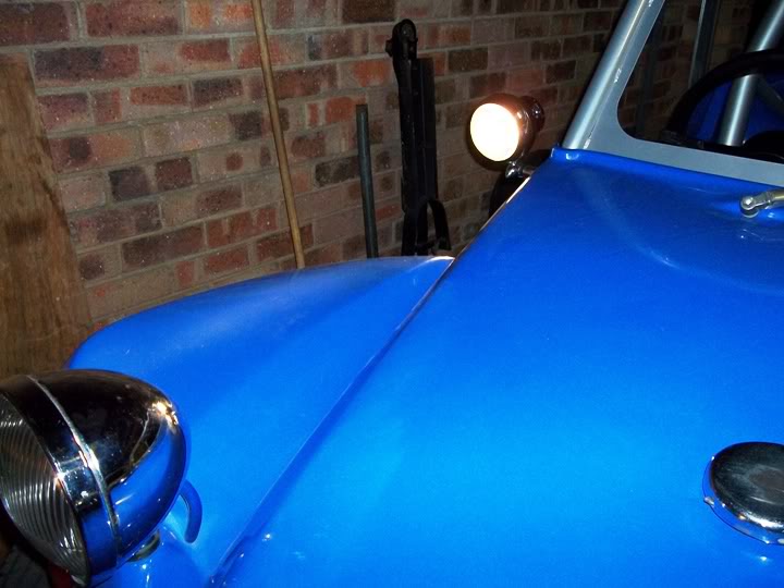

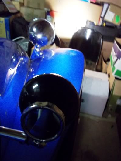

After struggling to get the correct side mirrors (i.e something that can actually see past the rear wheels) I decided to try the Hella spot light/mirror I got at Piston Ring a while ago, on the drivers side - modified the stalk a bit - and it works perfect!
