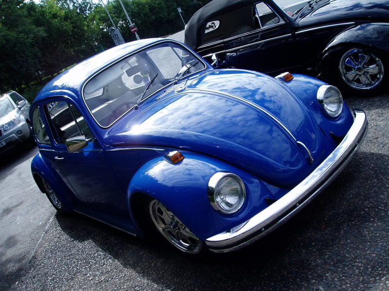

Thought you guys might like to see my other half's 1972 1300 bug which I built for her.
The colour is the original colour - L53b Gentian Blue. People always ask if its a Porsche colour! Its a one year only colour from 1972.
The car was stripped down and every nut and bolt was cleaned, zinc coated and reused in exactly the same location Same goes with 90% of the parts which were cleaned and reconditioned back to OG spec. It had a little bit of welding which was all done seamlessly to original specification so you can't see its ever been welded. The car was debuted at Volksworld Show which is Europe's top VW indoor show where all the best rides are selected to debut each year.
I'm gonna put the full build up pictures on my website once I've been through the 4,000 pictures of the build! :shock:
The car is all original specification apart from the fuel tank which is now gloss black instead of matt black, and the suspension is lowered one inner spline at the rear and a 5 inch custom narrowed beam with shock towers which I built. The wheels are fully polished original Porshce 2 litre Fuchs. Only new old stock and original equipment parts have been used in the build. No Taiwanese shit on there! Front wings were reproductions when we bought the car, so were changed for genuine VW new old stock ones. Bumpers are original VW and were rechromed. The list goes on!
The interior is all original, except the carpets which are original spec Perlon and identical to the original carpets which were there. The engine is original and has been cleaned and reconditioned and all tinware powdercoated to original specification. All running gear is fully detailed and the floorpan is gloss black inside and outside. The paint on the inner arches and above the gearbox is as good as the paint on the roof!

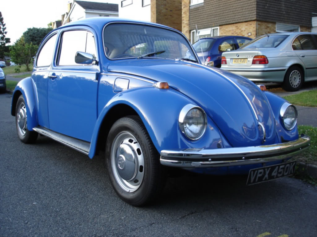

This is the car that we started with..

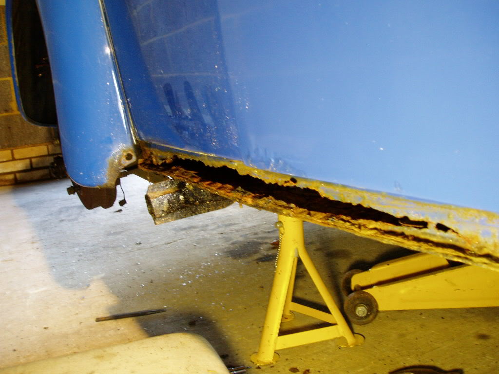

While the car was solid, there were some sections which weren't..
All repairs were seamless and invisible. You can't tell that its been welded at all.

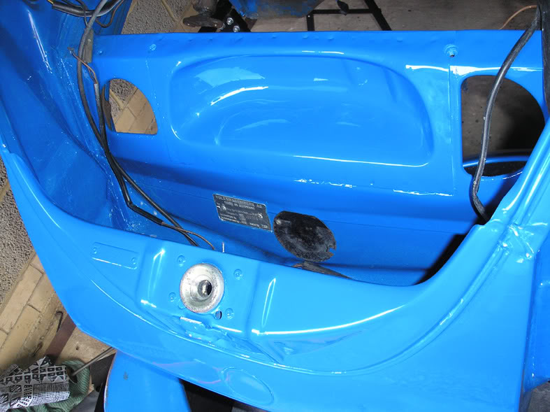

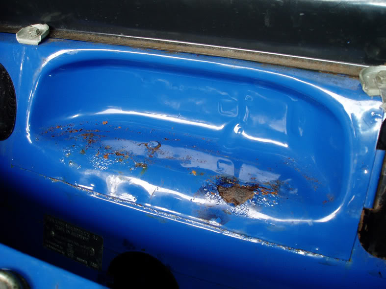

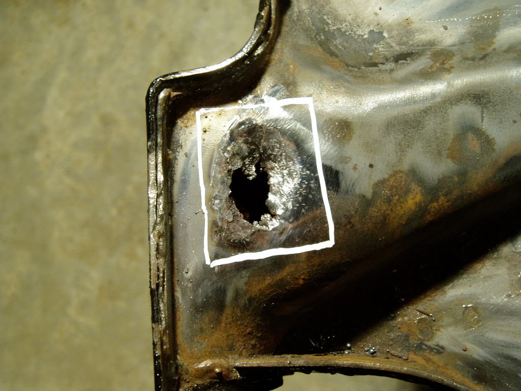

Take the washer bottle shelf for example - it was rusted all the way through..
So the spot welds were drilled out and a section was cut from a donor panel and seamlessly grafted in and the panel was spot welded back in exactly the same place complete with factory spot weld dimples.

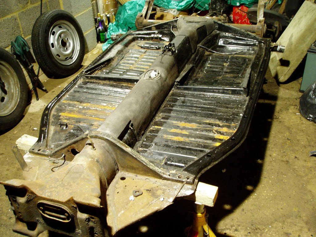

Floor pan was a bit worse for wear so was stripped to bare metal - only hole found was on the framehead which was also seamlessly repaired.
repair done..

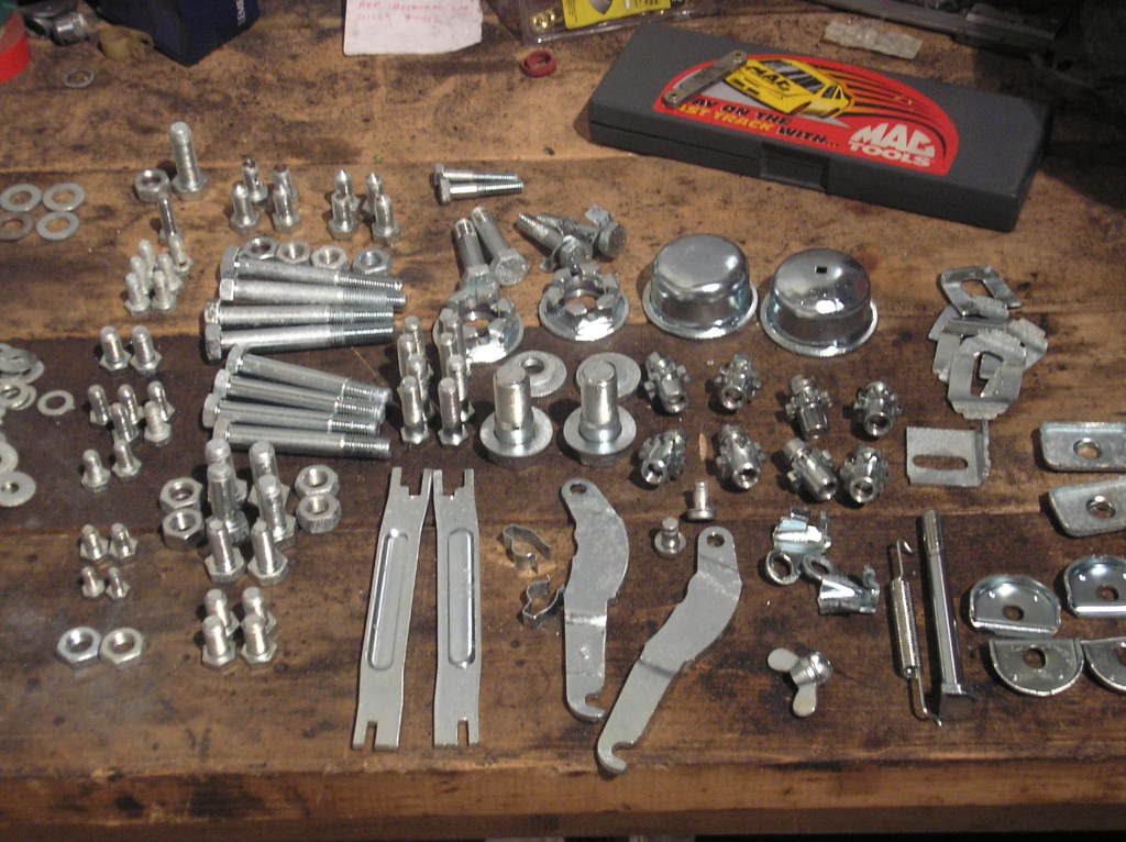

All original KAMAX nuts and bolts were acid dipped and zinc plated. You can't buy KAMAX bolts anymore and using new bolts just wouldn't be original!

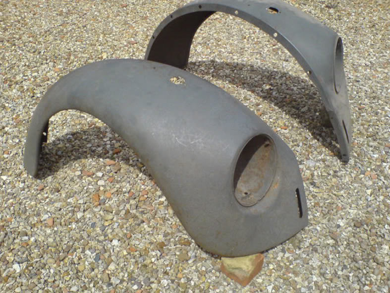

Original NOS VW front wings were sourced - one was found in sweden and the other was found in a swapmeet at a VW show.

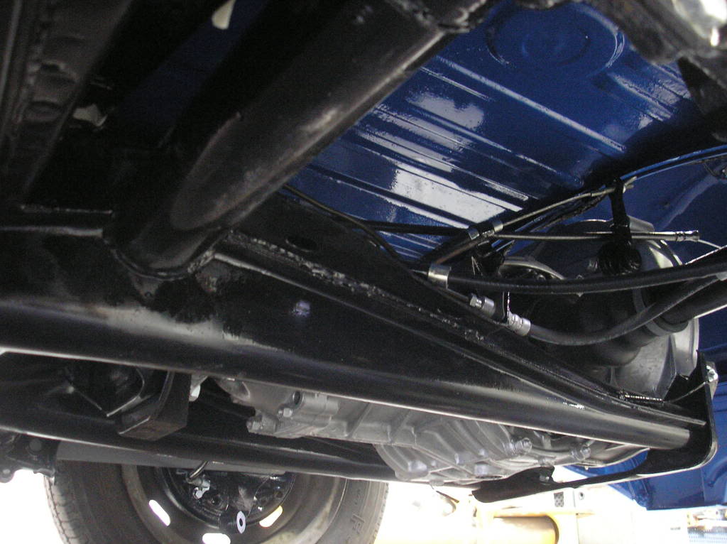

Chassis was stripped and coated in high gloss black

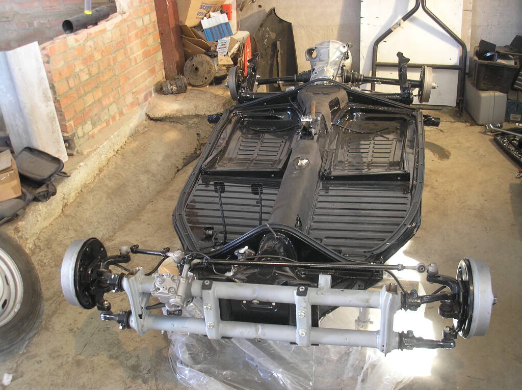

Then built up using all the detailed reconditioned original parts, buts and bolts. Note the front beam is the original one after blasting. The bodyshell was in the paint shop being painted so the 5 inch narrowed beam can't be built until the body is back on to allow for the custom shock towers to be made with enough clearance from the body.

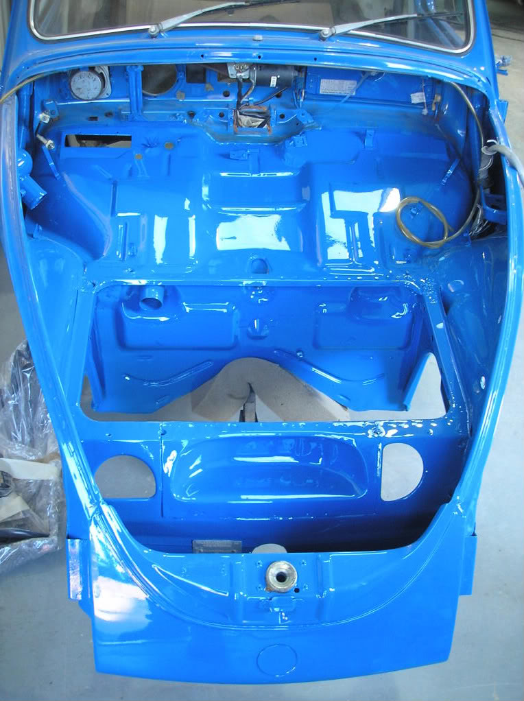

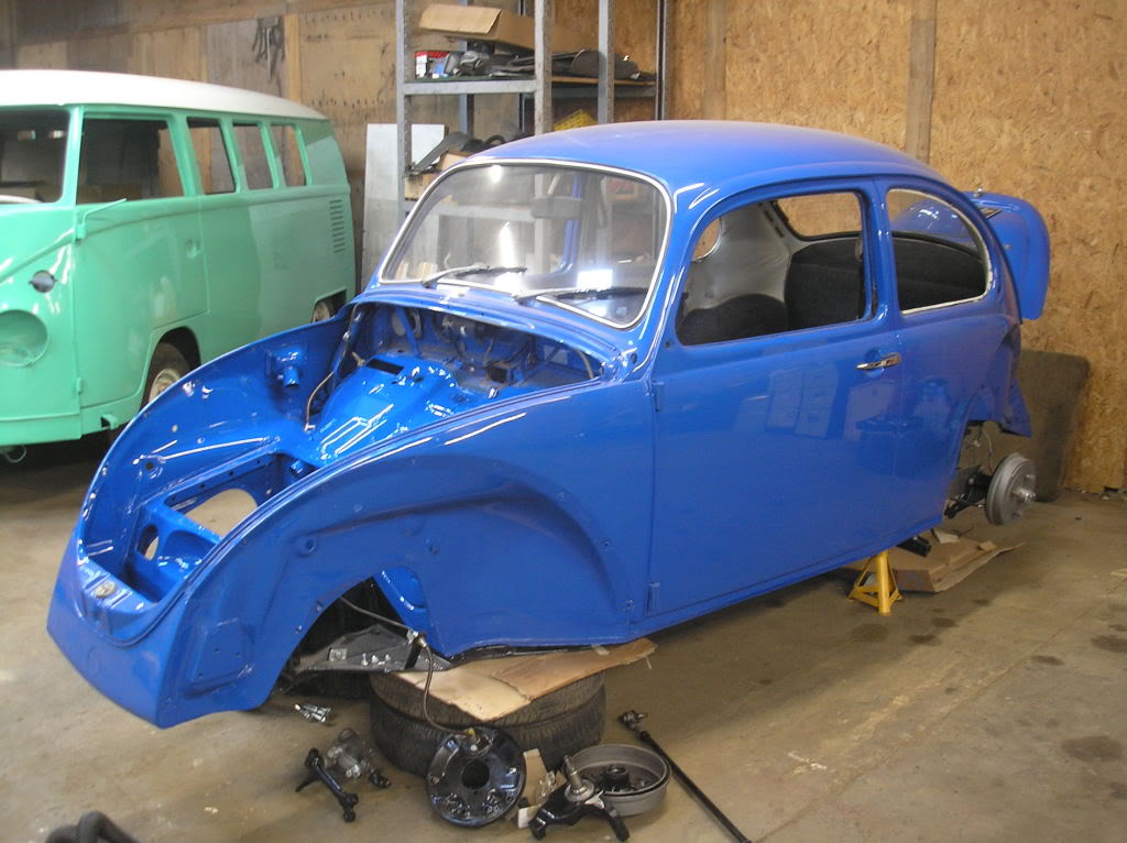

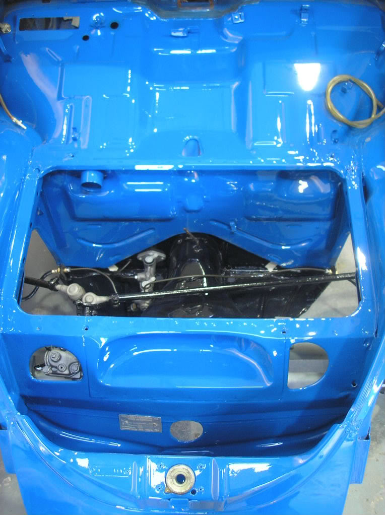

Under bonnet area after shell was back from paint.
Placed on floorpan and buildup started.

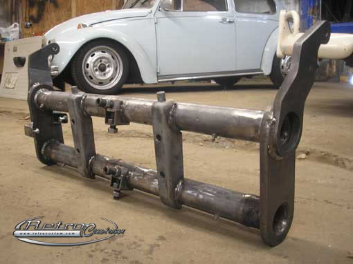

Buildup continues - front axle stripped while I built the 5 inch beam..
5 inch narrowed front beam..
