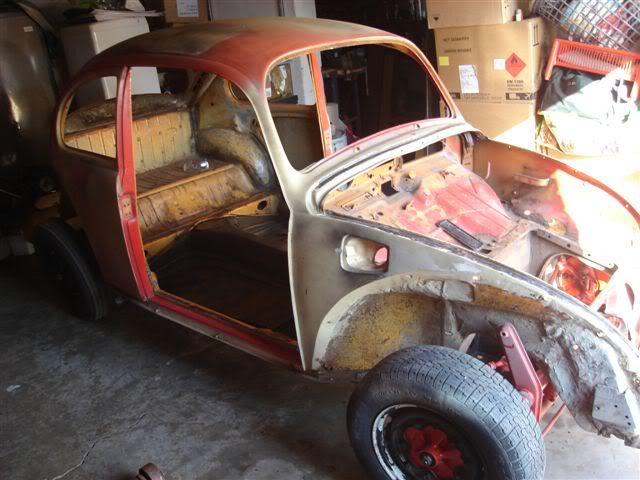

No 1 pretty std except for the pan, front and rear susp being cleaned and sprayed.

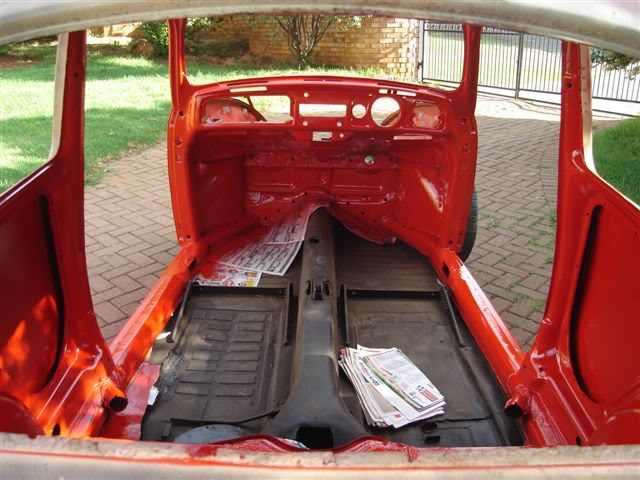

No 3 the worst cut of all, saw this effect in a recent vw mag and I am hoping it will work ok if not off she comes.

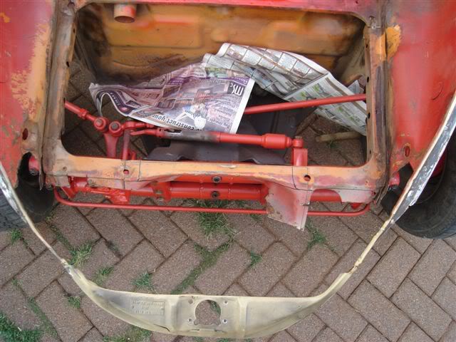

No 5 The pan is sprayed with chemical resistant paint, mat on the inside and gloss underneath.

I hope you are going to weld that beam all the way round otherwise it will break as well as sweat grease.
Make sure you only weld a little at a time and make some sort of jig / frame & clamps to keep things straight, as it is going to pull skew with the heat. :zhelp:

Yep I had it CO2 welded in small amounts, took the guy about 2 hours to weld it up
