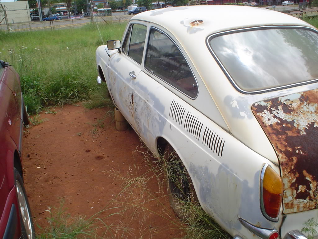

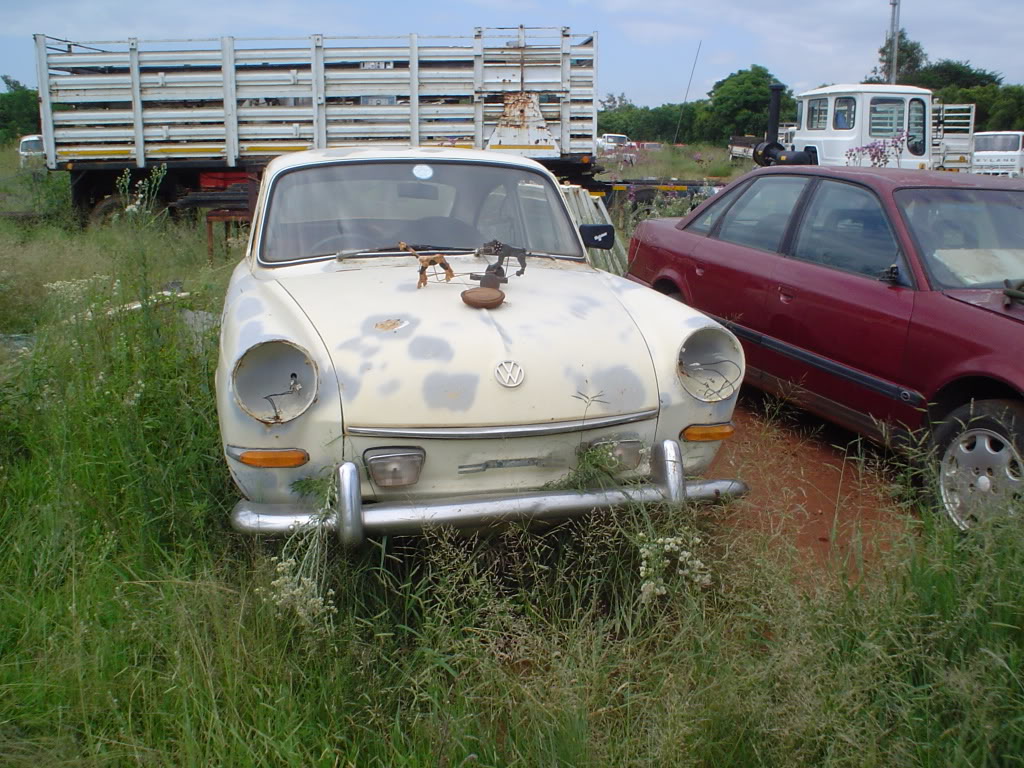

At the Camp Out you asked me about the 69 fasty from last year.
This morning, I drove out to see if it was still there.
The following are the pictures that I took this morning.
I hope this helps

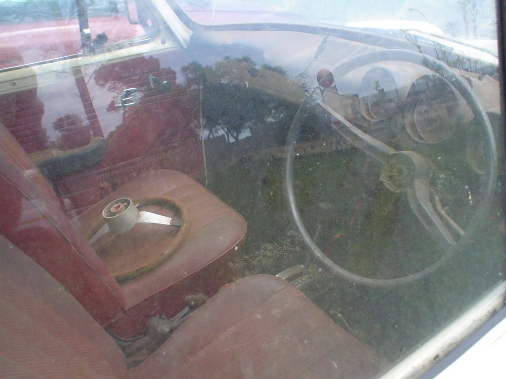

I like those front spotlights YUMMY and the red interior stil looks good

I did not specifically check out the chassis on the car, but a brief lookaround did not show up a major rust or damage problem

I also had a look at this one last year. Failry solid still. Built in March 1969 - one of the last type 3's assembled in SA. Been in a bad front smash at some point. Poorly repaired - lots of wrinkles visible under the fenders and around the fuel tank. Both front fenders & bonnet are from a '68. Chassis rotten around the pedals and under the battery. Driver's door bottom hinge torn out of body. Electrical wiring in very poor state. Engine??? Looks like it hasn't run in years. This one will require LOTS of time & money to put right. I considered buying it as a spares ship but decided against it when I found my Notch.
