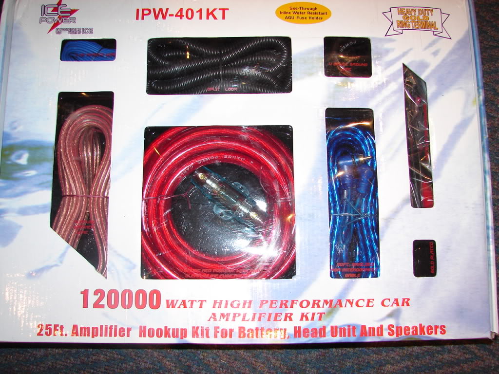

This is a sample of the bull :bn: that consumers are subject to in the car audio industry.
You fork out your hard earned cash for a wiring kit to hook up your mega watt car audio system.
You pick the fancy box at the "too good to be true" for you only price and head home.
But when you start the installation, you find that the 4# power cable that looks like this in the box:

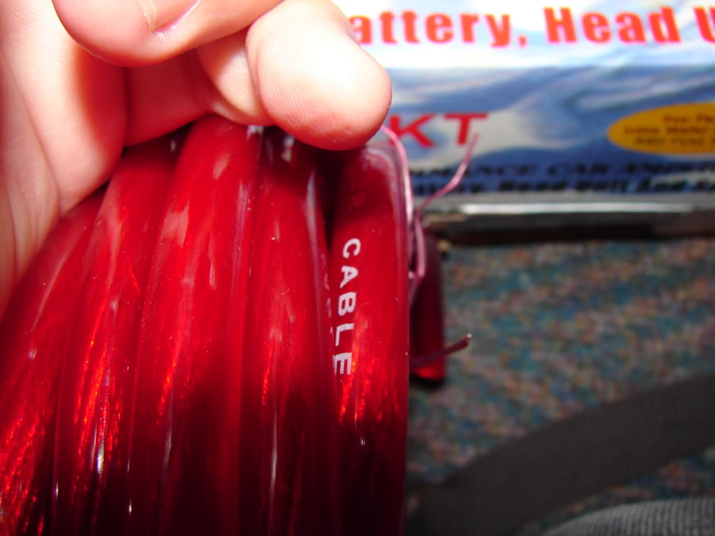

actually look like this when you compare it with an actual 4# cable
I appreciate that most of us are watching the finances very carefully, but it really "pays" to pay a bit more for the good stuff. Spend your money wisely and beware te slick salesman.

The printing on that box screams CHINA!!!!!

Make sure the box actually does say 4 gauge and not number 4 or 4mm2. 4 gauge is a specific size, as is 4mm2 but if its number 4... well who knows

I would love to see you take that to the shop you bought it from, and hook up the claimed 120 000 watts through those wires and watch the cable set the store alight!

Another thing to look out for is the copper content of the wire.
The higher the copper content and the finer the strands, the better the wire - Rockford Fosgate and Stinger currently use 100% copper.
Some kits contain 10% copper. The actual strands are then normally made from whatever rubbish metal was melted and the concoction is then sprayed with copper dust during manufacture.
If your fingers get a copper coating and the wire turns silver when you handle it the chances are that you've been had and you can start to prepare yourself for the molten fuse holder syndrome.

the 120 000watt claim on the front of that box should have been enough to let you know what type of a kit that is.

:lol: 120kW :lol: :lol: :lol: that's 150hp. You'll need three ACVW engines to drive that!!! And all of that throught that piece of wire... :lol: :lol:

Why would you want cabling to handle 120KW when your amp only puts out maybe 500w RMS per channel???
