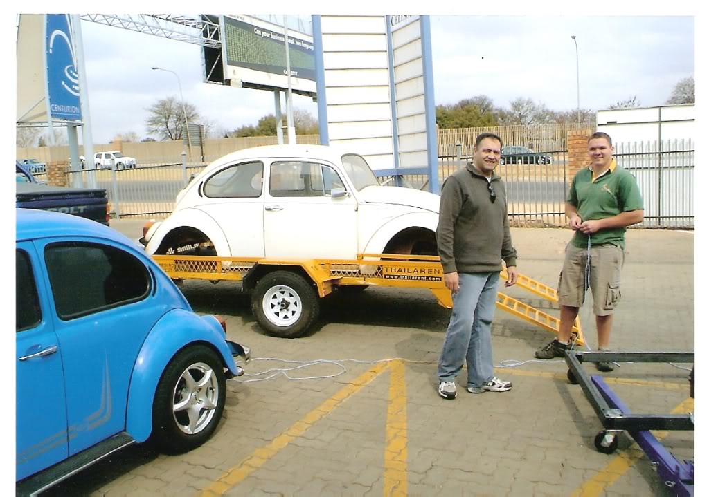

The day we collected Twobucks

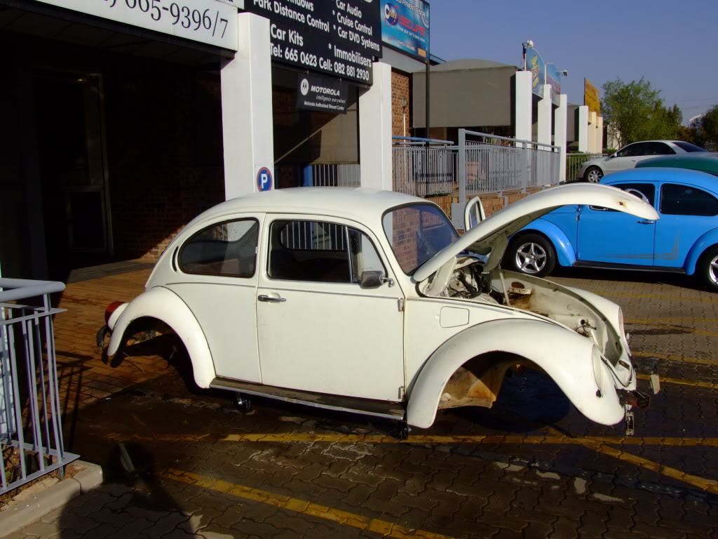

The body was mounted on a specially made frame with castors to facilitate easy moving
As can be seen, the body is in excellent condition.
The left door needs to be replaced as blocked drain holes allowed rust to form at the bottom of the door.

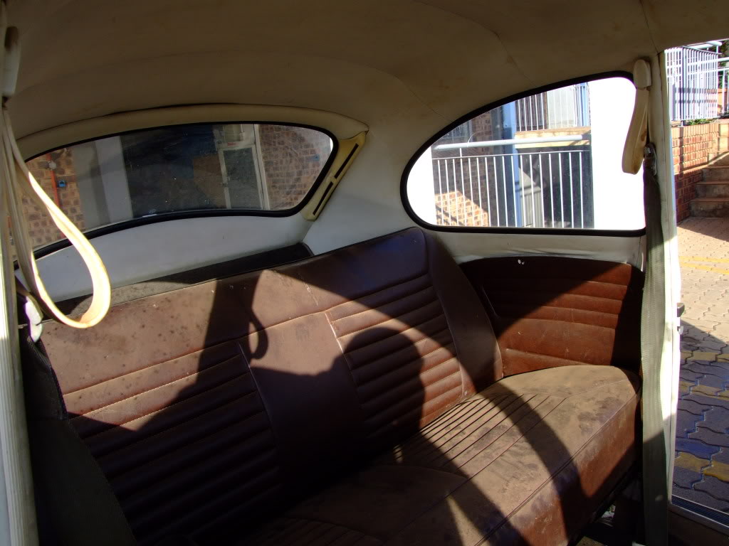

Even the original upholstery was in good condition.
Fortunately, the dashboard is not butchered.
The two way radio that was fitted left a 20mm hole in the center of the roof and the rear apron is slightly creased. Small challanges really.
We have since stripped the body completely in preperation of bodywork and paint.

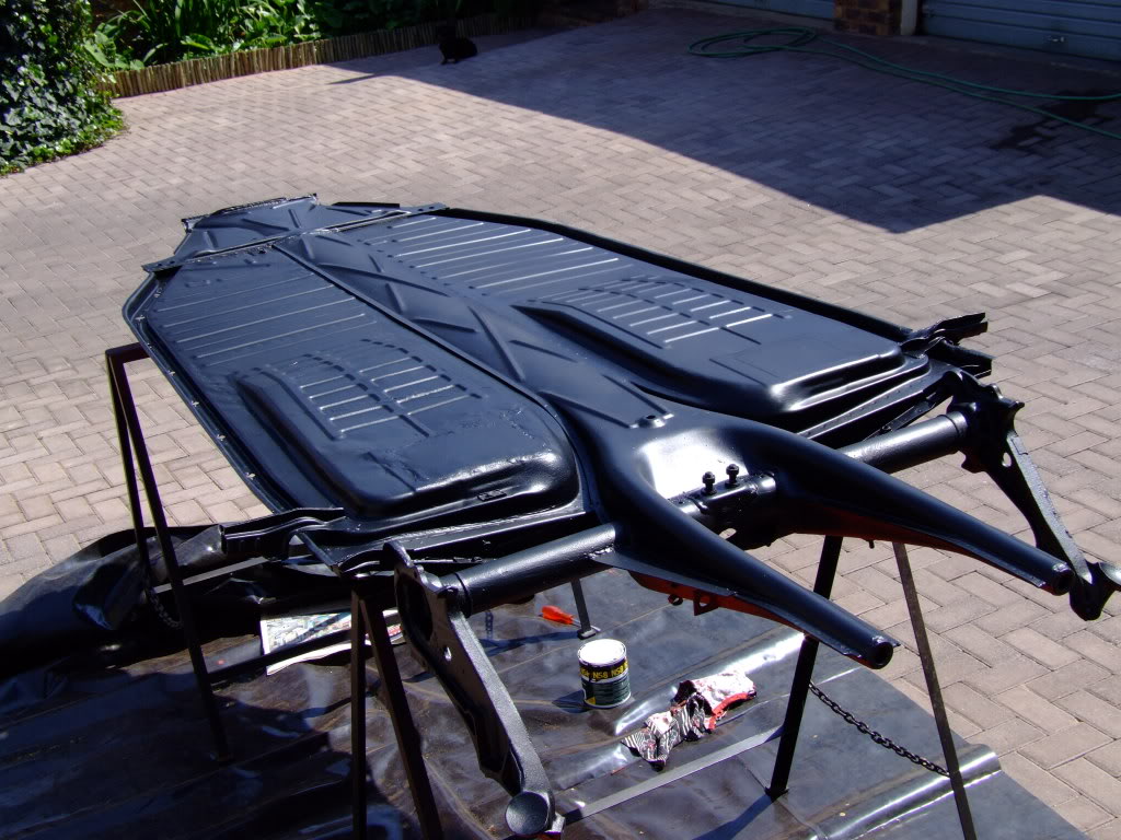

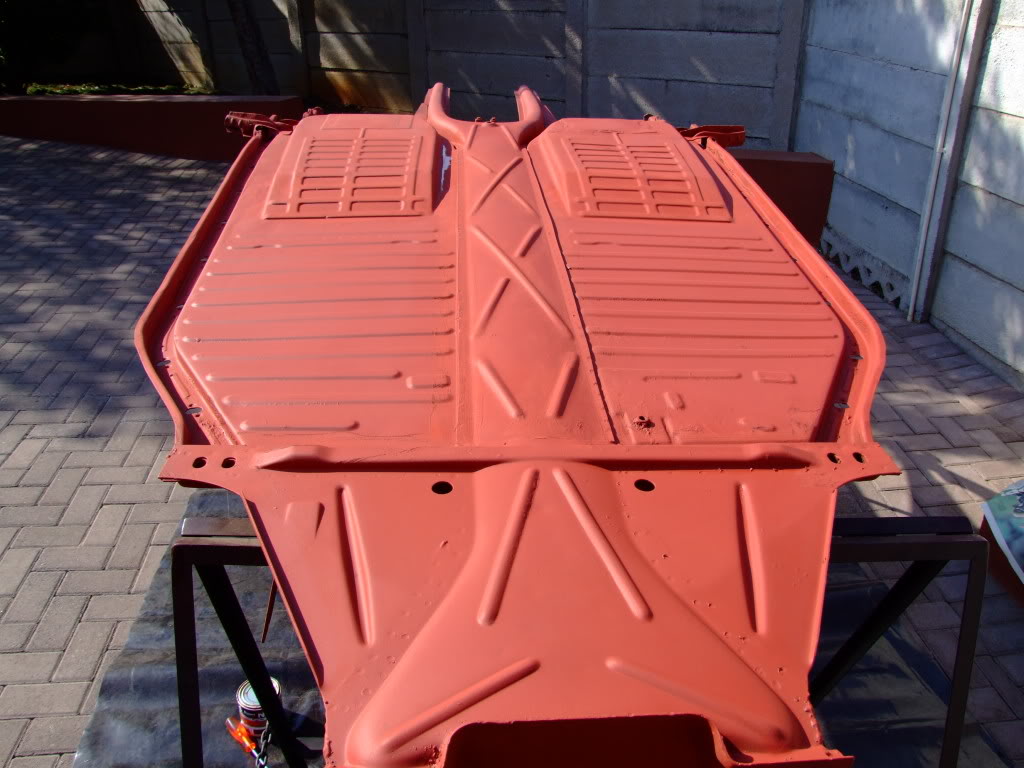

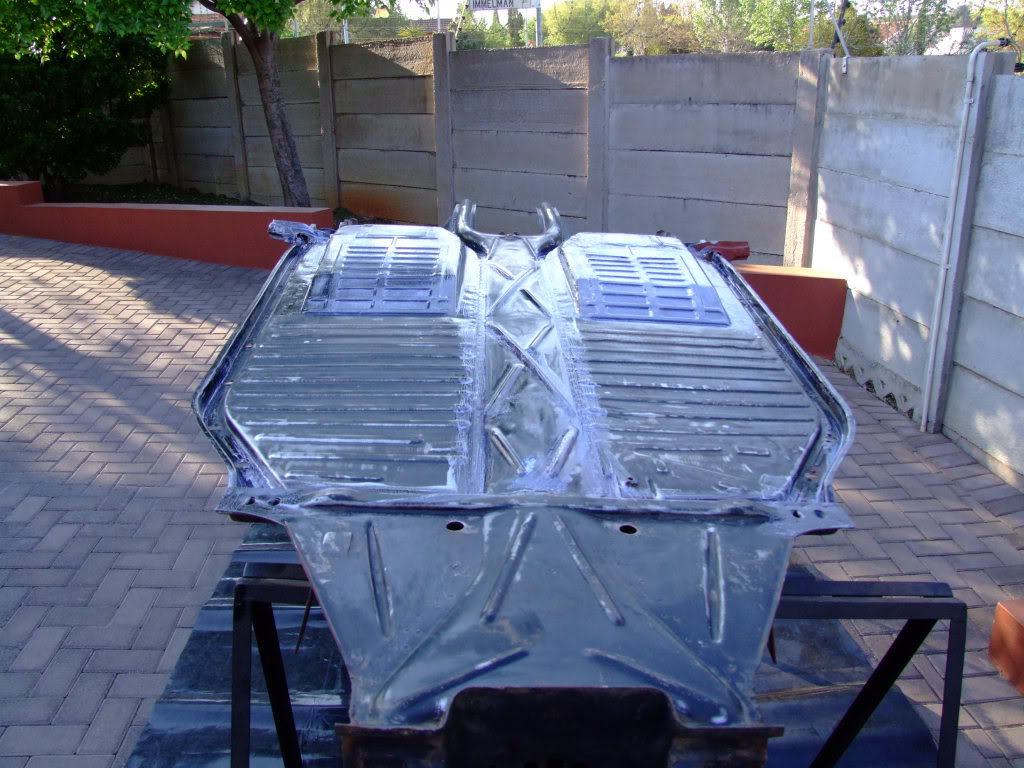

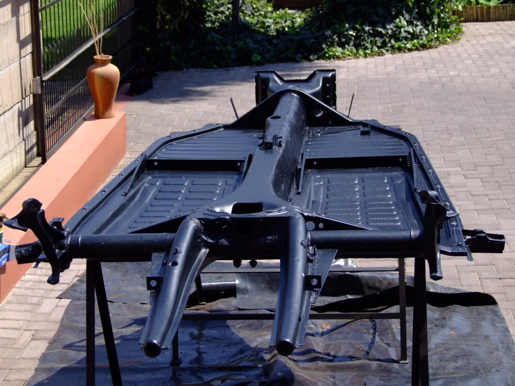

Andre, my partner in crime, found us this pan.
He did all the hard work to clean it, fix the battery induced rust and paint it. The man is a machine.
Now we need to get the front suspension and gearbox sorted

Jmvv, that pan looks very nice. Andre sure knows his stuff.

jmvv wrote: Even the original upholstery was in good condition.
I love the leg restraints in this pick... :twisted: makes for easy access to the cockpit.... :twisted: :twisted: :flash:

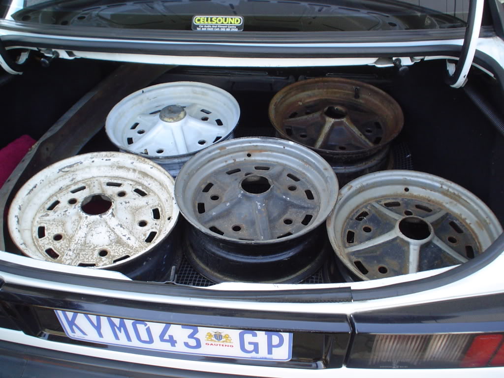

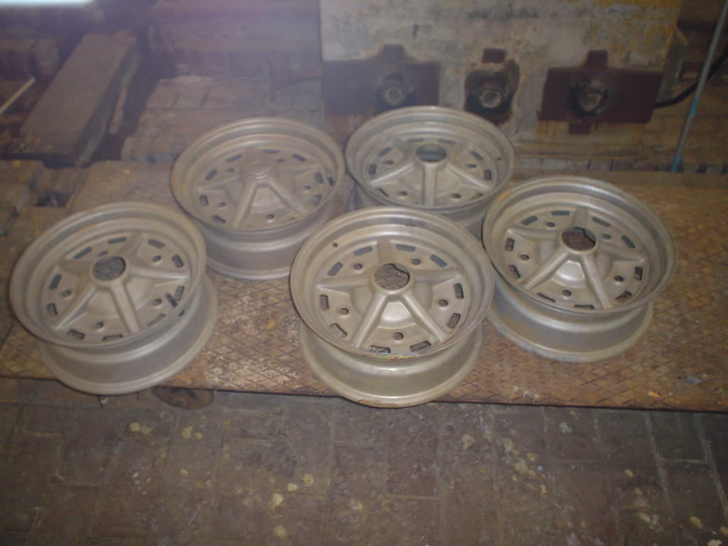

Thanks to Greenbean's dilligence, I managed to get a set of 5 14" rostyles together.
I had them acid dipped as I am not too fond of the finish to the metal after sandblasting
The idea was to have them chromed.
After contacting all the local Chromers (Edisons, Sheffields, etc) they all told me that the rim needs to be split before chrome plating. The halves are then welded back afterwards. As the center of the rim is originally welded directly to the rim, I was worried that the new welding will discolour the chrome.
I think this is a B.S. procedure, as chromed rostyles were available new from the Guestro factory in P.E.
Nonetheless
So, plans have changed. I've decided to paint the rims in the original colour scheme (silver with black inserts) and then fit bikini trim rings. (Jeez, but i am showing my age)

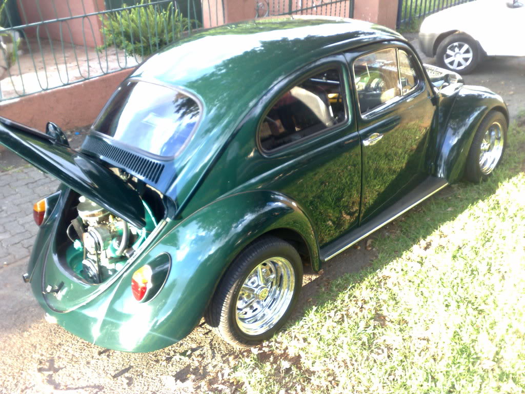

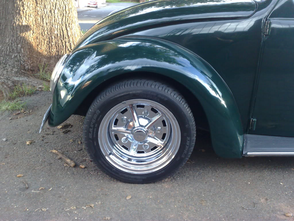

Concerning chromeplating rims, I found this guy that can plate just about anything, it is called Crazy Chrome. His name is Karl and his number is 083 447 6992. he is also in the Pretoria area. Not too sure about the pricing.
He has done these ....
I will use him in the very near future.
