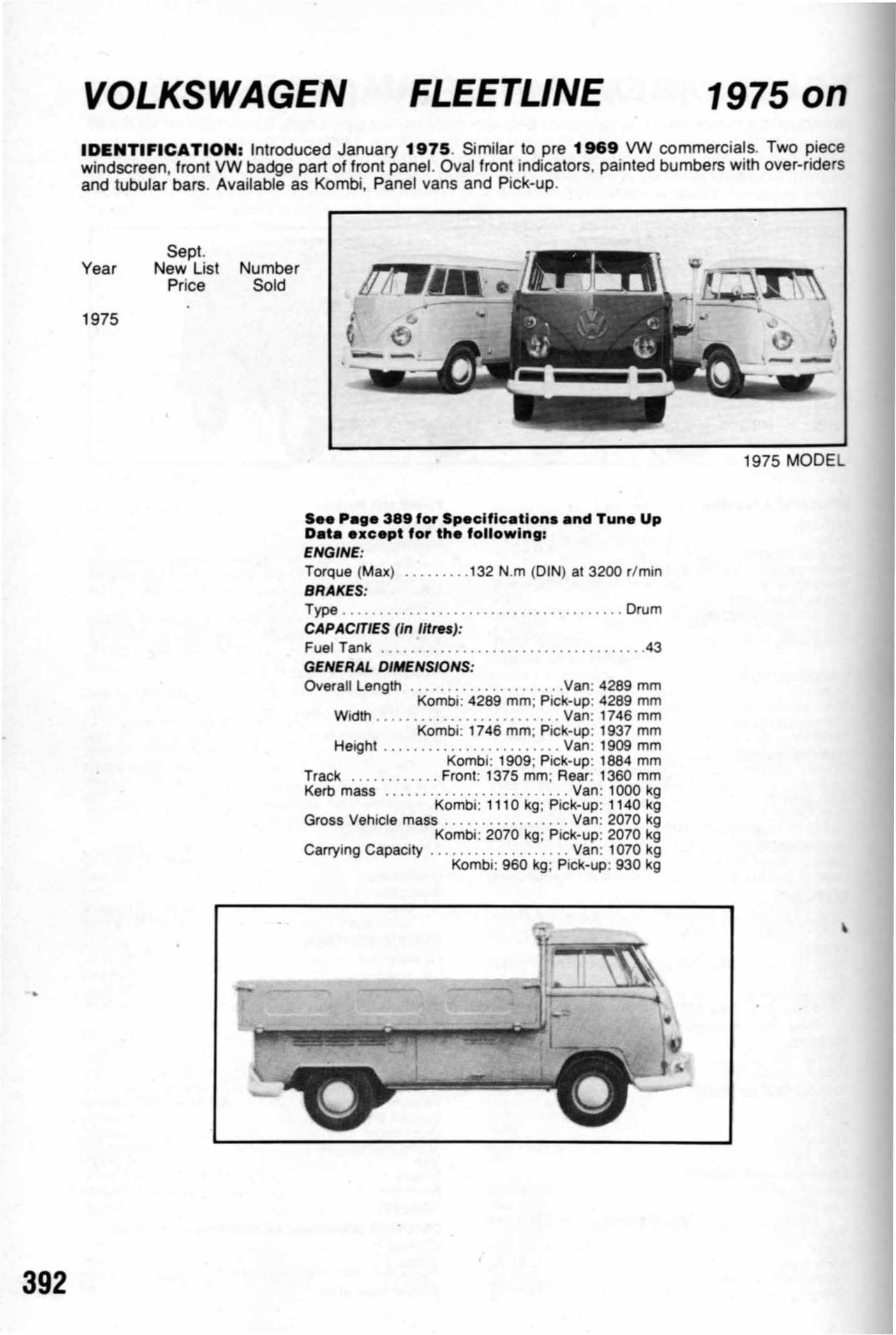

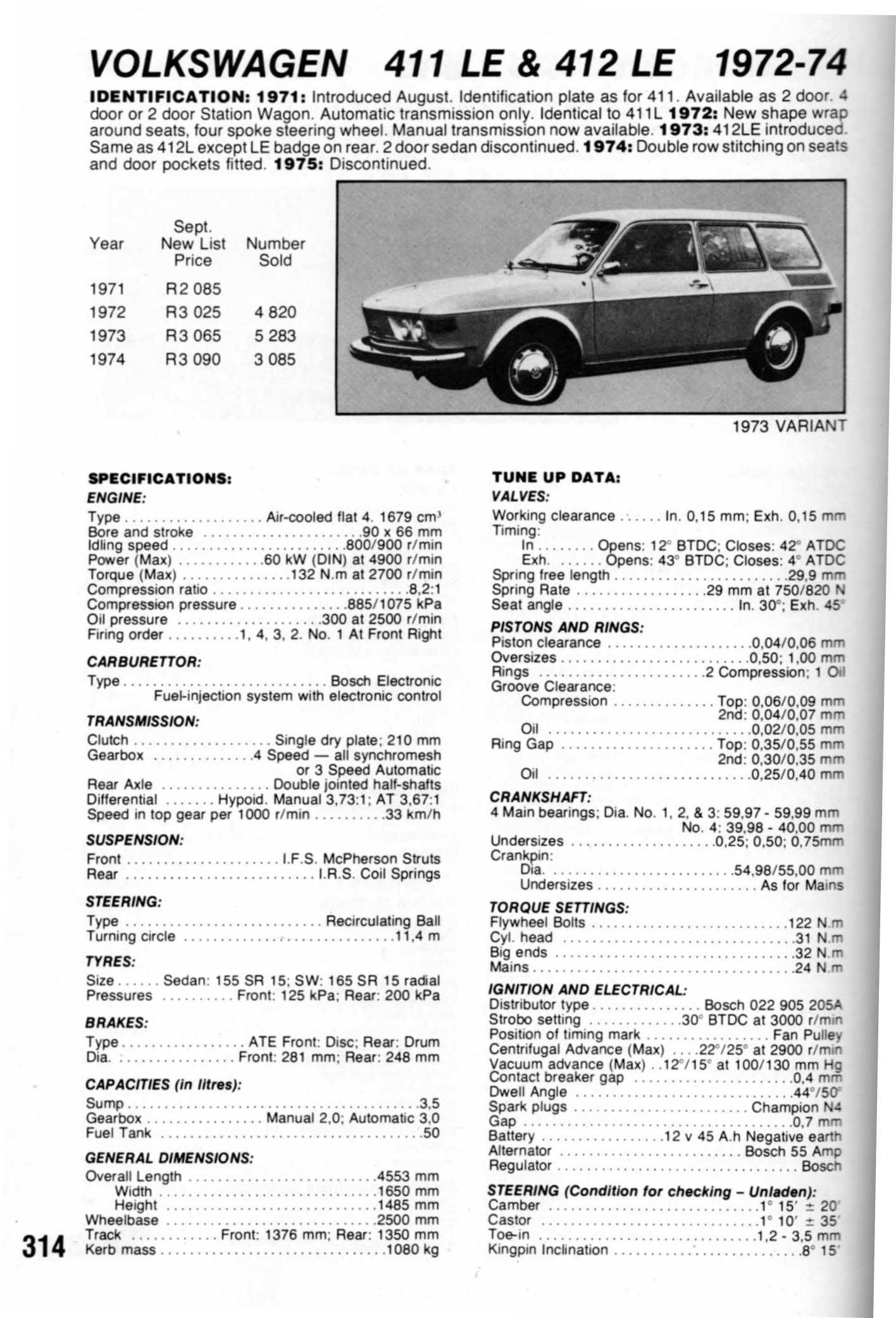

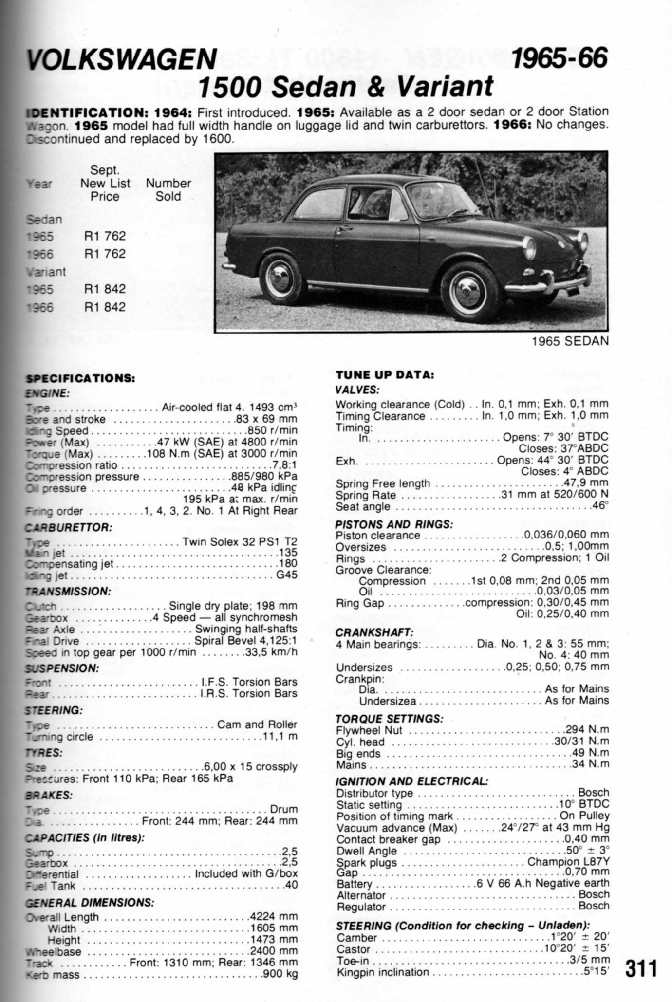

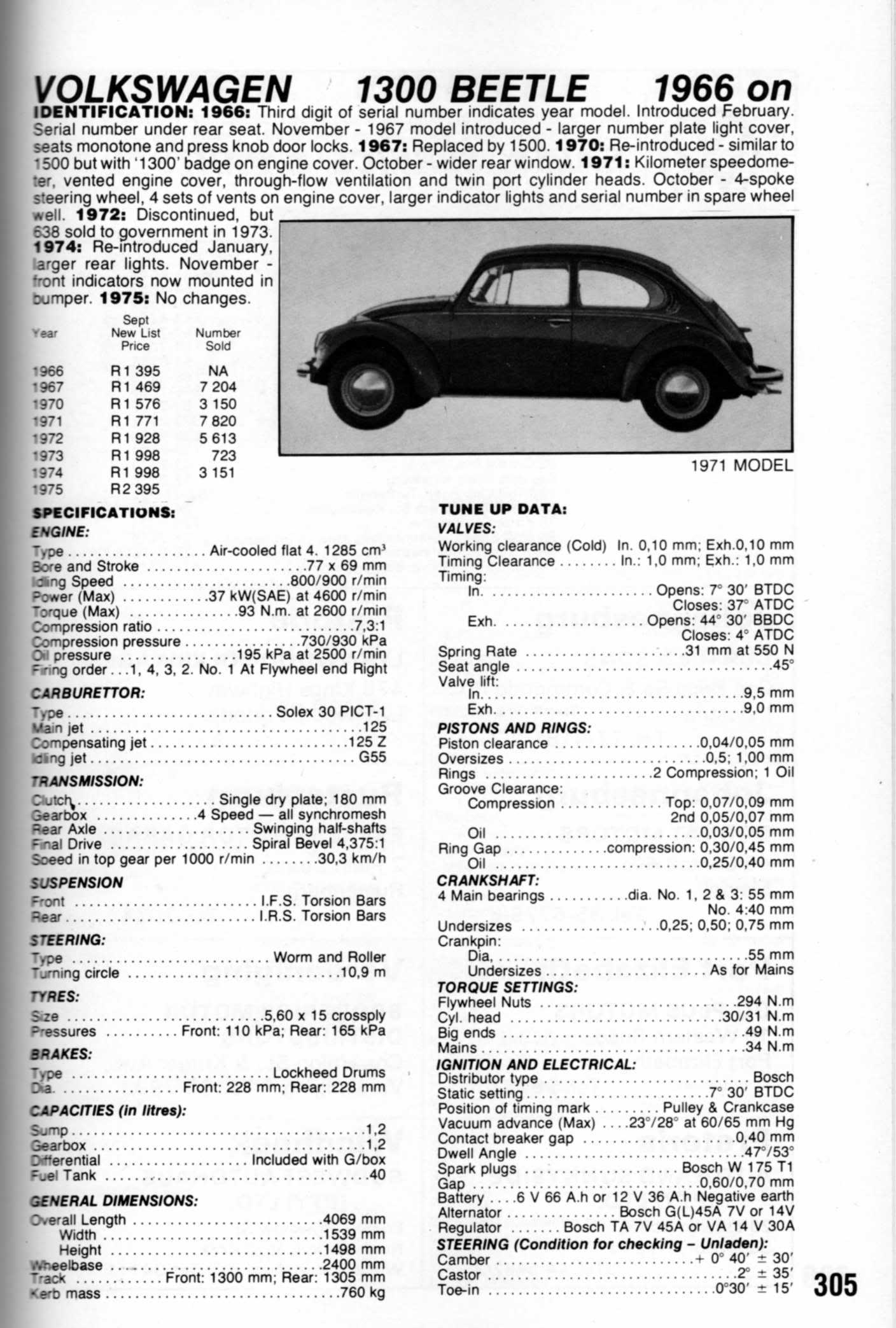

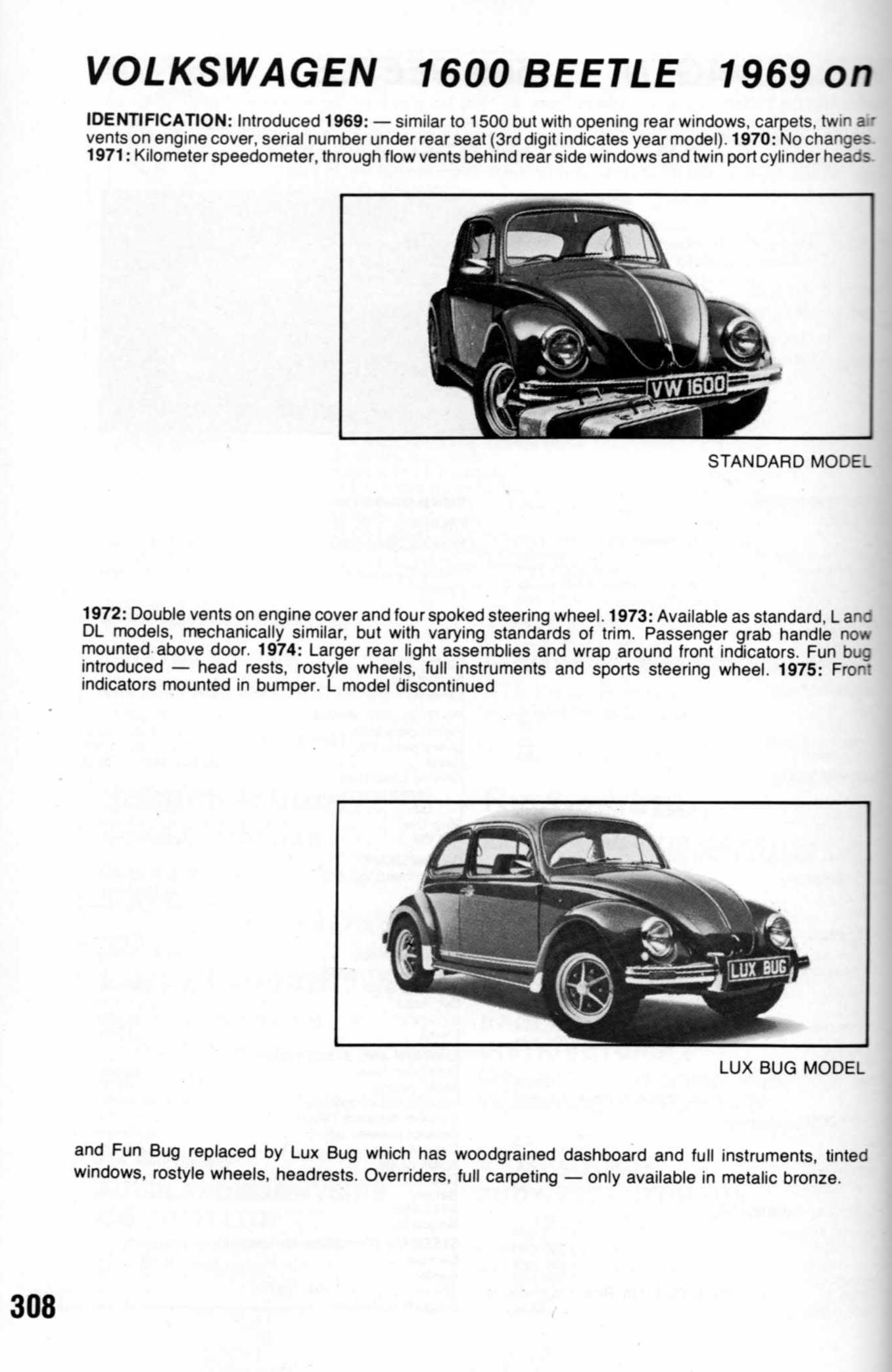

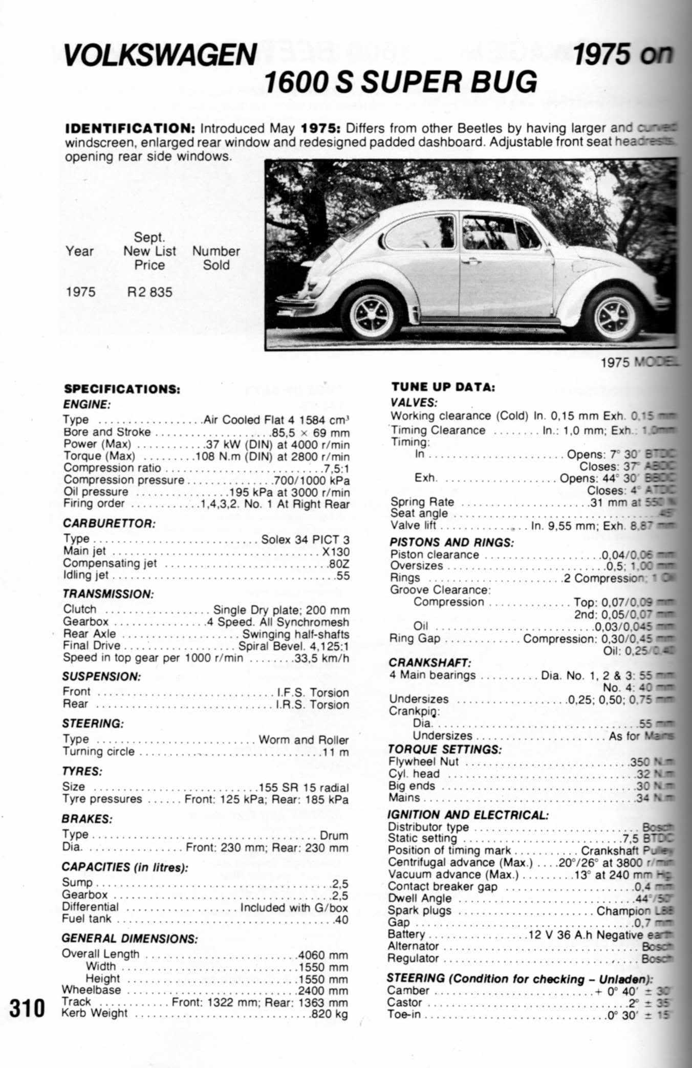

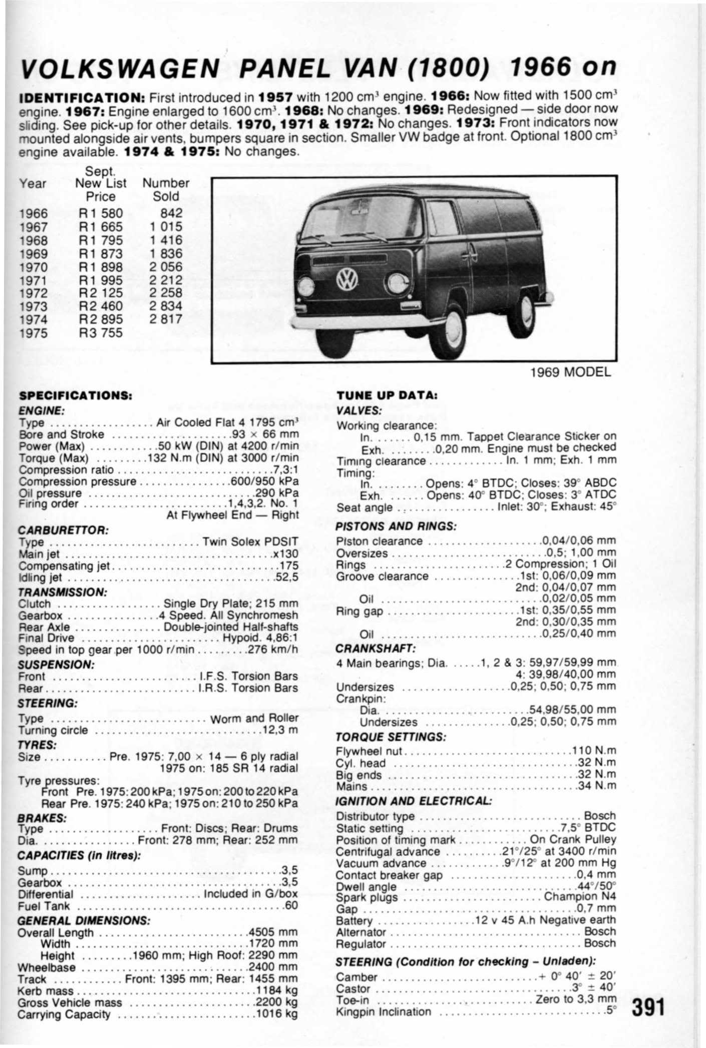

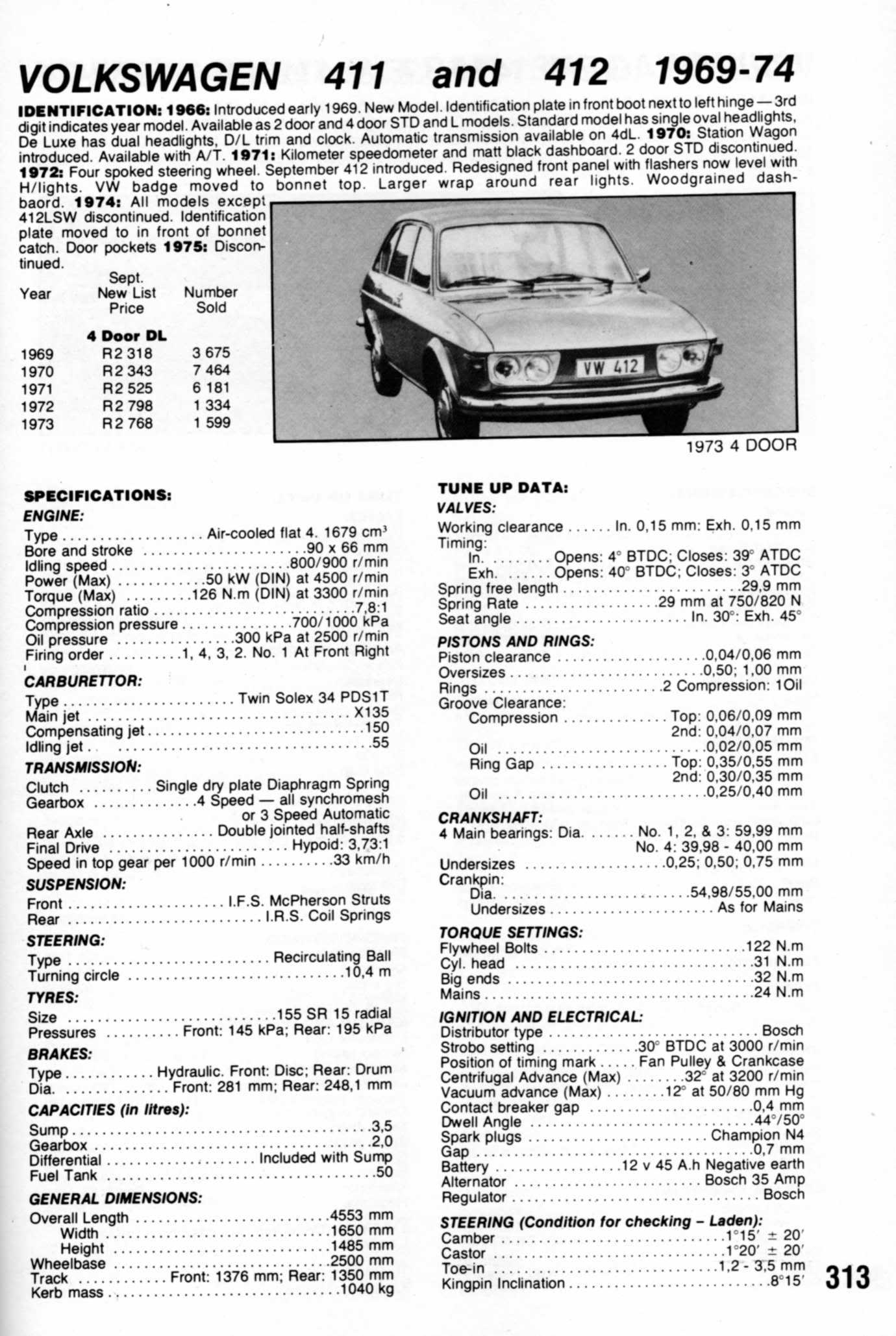

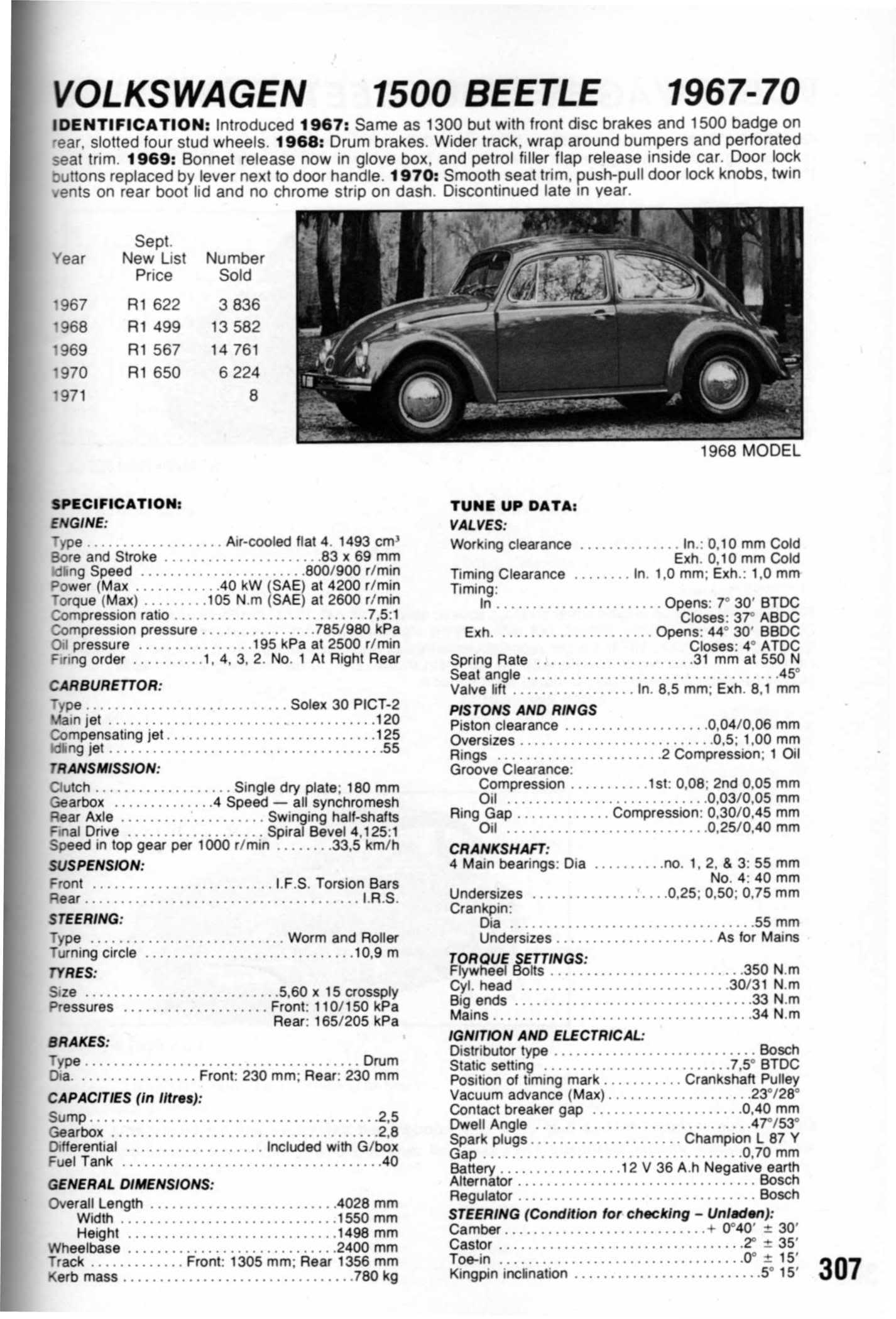

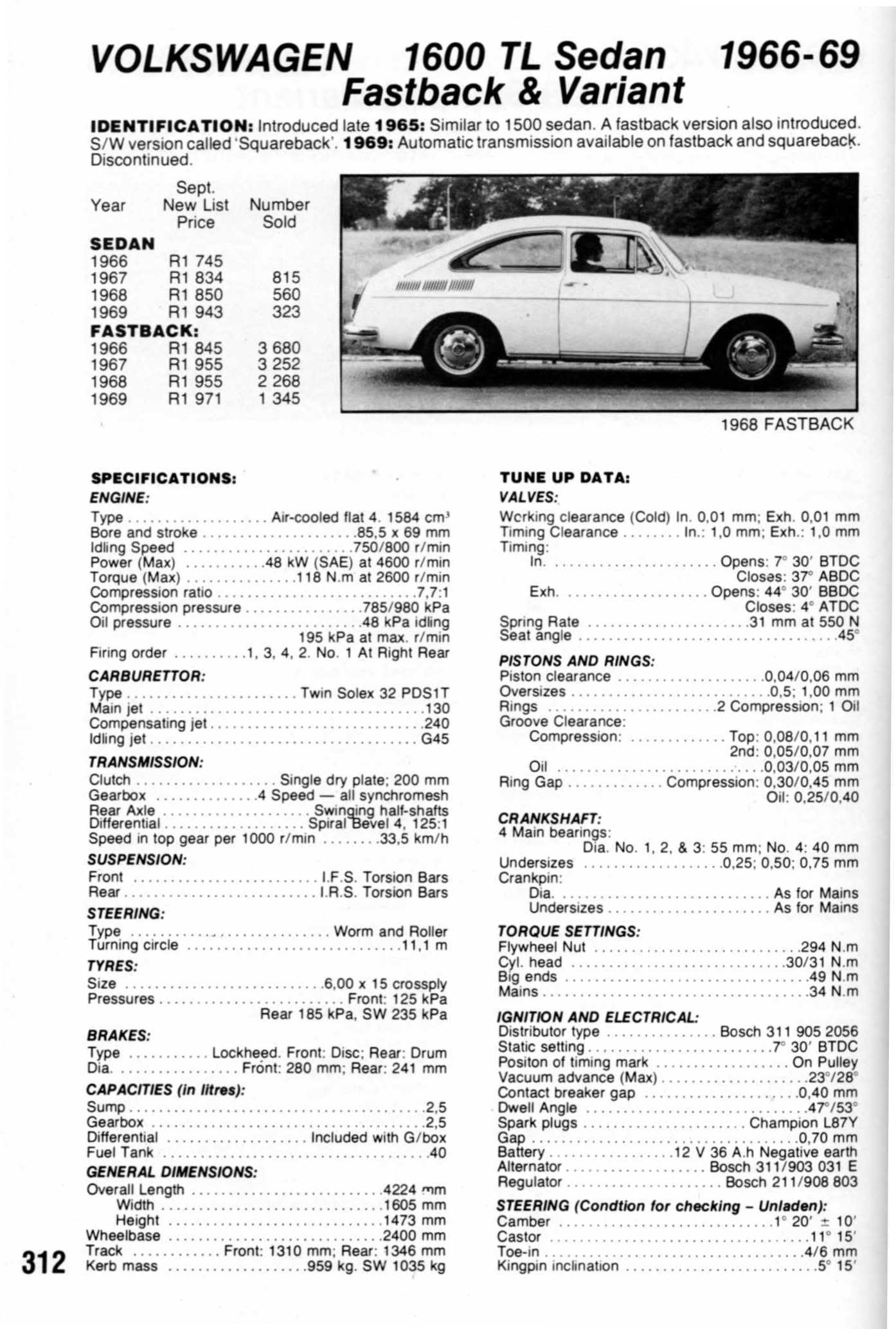

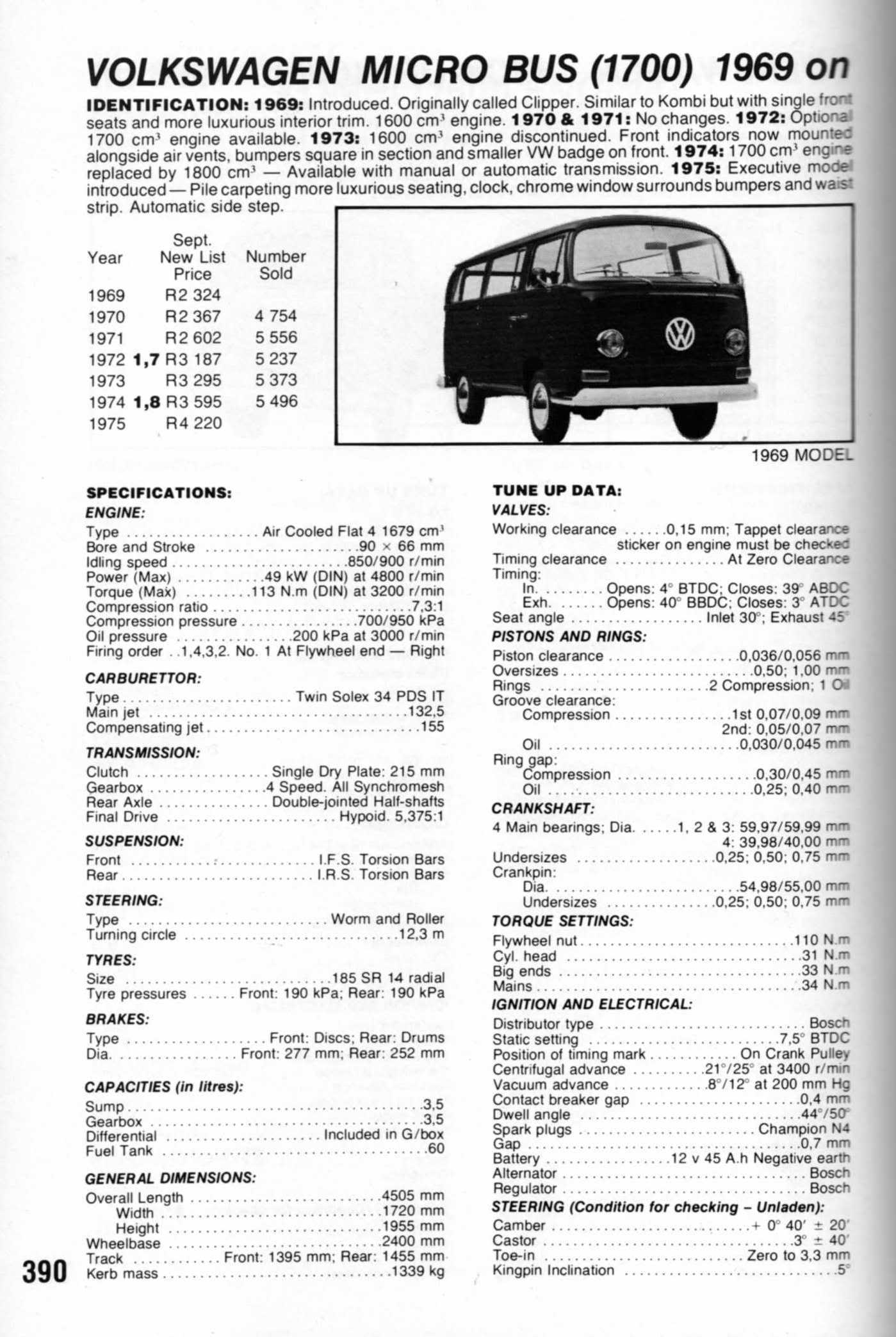

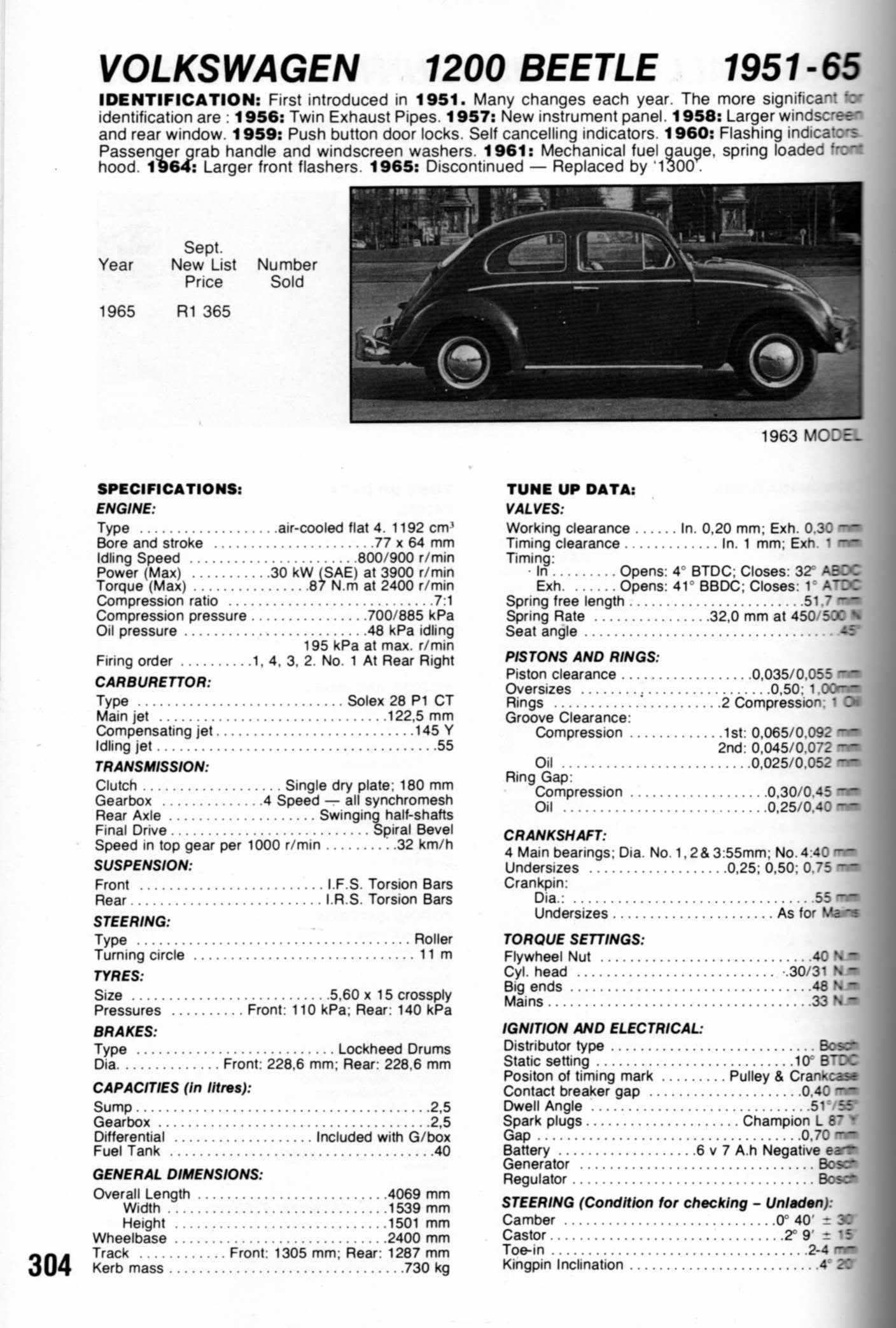

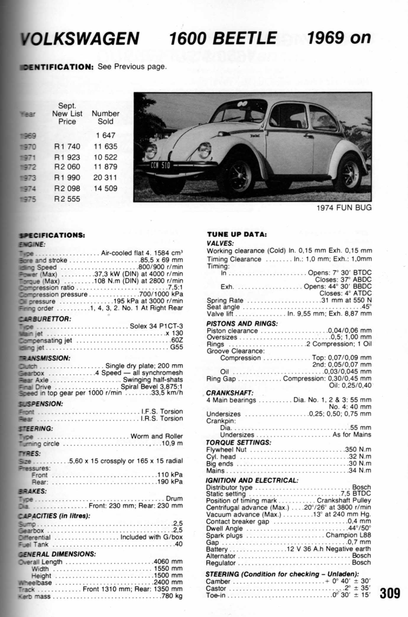

I scanned these from a 1975 Auto Data Digest, which covered the entire South African air cooled VW range to date. Not sure about the accuracy of all the figures, but whathehell - will also forward it to Eben for the resource library :wink:
Type 1
Type 2
Type 3
Type 4

My bug use to be a FUN BUG like the one in the ADD. I see that the reg no is CCN 510 , my one was CCN 44380. The CCN use to be for Uitenhage and PE was CB in the old days.
