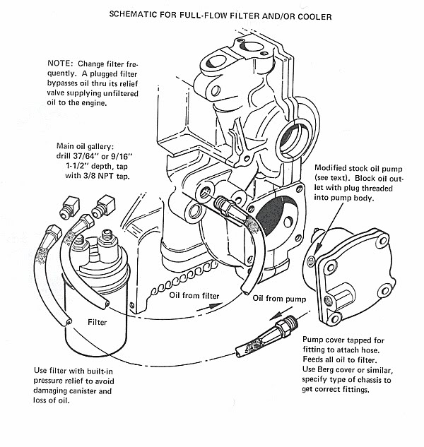

full flow oiling diagram

When doing this mod, dont forget to plug the pump and the case...
Also, make double sure you plumb in the filter properly. If I remember correctly, they flow against logic (mine anyway). The oil must flow from the outside of the filter to the centre.

Thanx for the pic edmond.
Hi tony, please explain what you mean with 'plug the pump and case'? Im still a appy. Thanx.

You take the oil out of the pump from a new opening. The stock opening needs to be closed (plugged). Then the oil line in the case, where the pump would normally pump into, that needs to be plugged too to prevent oil coming back from the main oil gallery and leaking slightly. Not entirely necessary to do both (my opinion) but it is better.

I have a modified and plugged 30mm pump at home somewhere I can show you sometime if you want

Ok, thanks tony, now im with you. That plate that covers the pump with the oil line opening; can i make one myself, or do i need to buy one?

With a milling machine you can make one youself... much easier and cheaper to buy one I think

bugoff you can get a full flow oil pump cover from calooker(Rui) or Dave Rowley im sure volkspares also sells them
