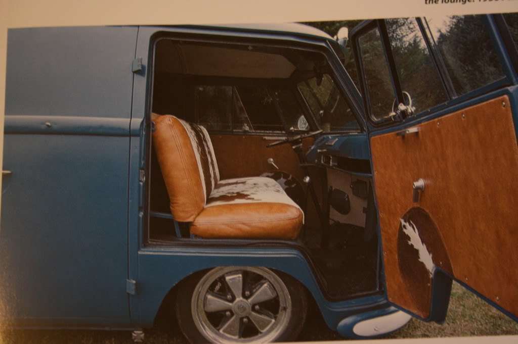

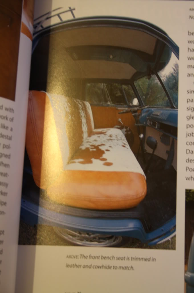

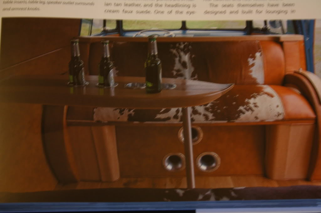

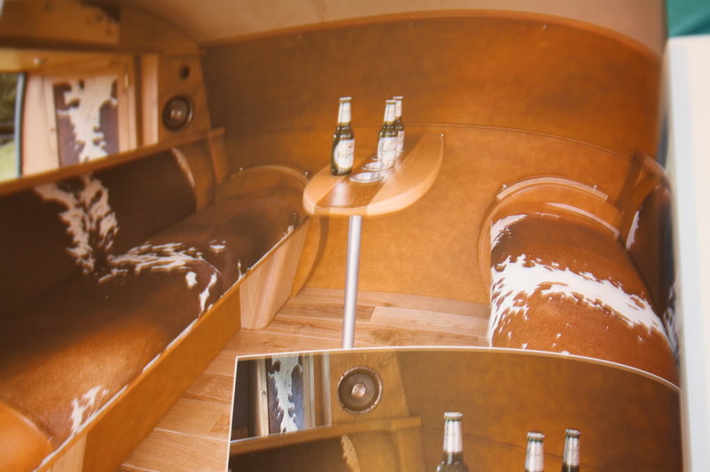

Interior:
I'm having a full bench made up with a lovely cow hide purchased in the Natal Midlands.
Yes, the seat will be hide, booya!. Other than that, the dash will remain totally standard, but the air vent will have an oil temp, pressure and fuel gauge in it. Sound will be installed but not sure how, most likely just an iPhone jack going into an amp somewhere.
