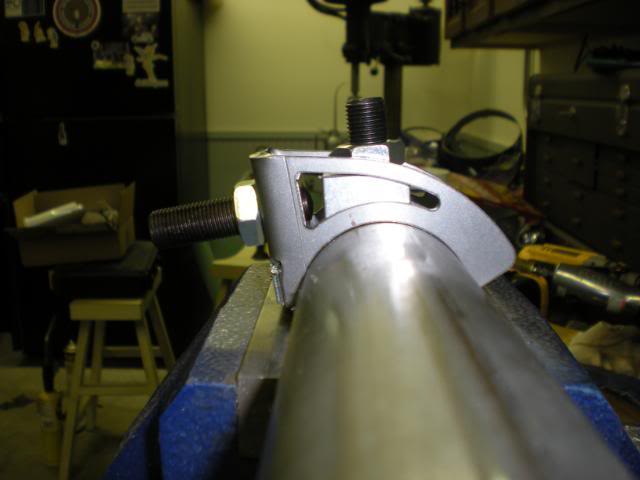

- 1972
- Posts: 1670
- Location: Pretoria_Gauteng
Re: Narrowed beams
Ive made the templates for the adjuster guides going for something that looks like this.
