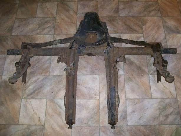

With 'clip' I mean the rear part of an IRS Beetle suspension, I got this one (off a 1302), which started the whole IRS idea

Do you then cut the rear suspension off the current pan and weld the entire clip on?
I've seen conversions on volkszone where they weld brackets on to the cross tube. The gearbox mounting 'horns' need to be dished a bit to make room for the drive shafts - which concerns me a bit as this must reduce the strength of the horns?
This way you need the gearbox, driveshafts and trailing arms only - and you maintain the structural rigidity of the tunnel by not having to cut it?
- Posts: 15033
Re: IRS rear suspension
Yes, the same process for cutting and re-welding, like shortening the buggy chassis.davetapson wrote:Do you then cut the rear suspension off the current pan and weld the entire clip on?
Personally I am not very fond of that idea. The IRS pivot points also need to be aligned perfectly before and during welding to keep the rear geometry of the car 100% true. Remember, this was done on a jig in the factory, and it can be a bit tricky to do without a jig - unless you make up your own. (Speak to Merlin - Eric who did his IRS conversion might still have the jig he made for the welding.)davetapson wrote:I've seen conversions on volkszone where they weld brackets on to the cross tube. The gearbox mounting 'horns' need to be dished a bit to make room for the drive shafts - which concerns me a bit as this must reduce the strength of the horns??
(And the pivot points as well, they can be bought new from Volkspares). But I don't think you need to worry about the structural rigidity of the tunnel. If it is cut and welded professionally, it will most probably even be stronger as the day it left the VW factory.davetapson wrote:This way you need the gearbox, driveshafts and trailing arms only - and you maintain the structural rigidity of the tunnel by not having to cut it?
