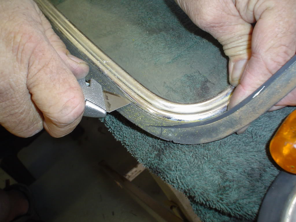

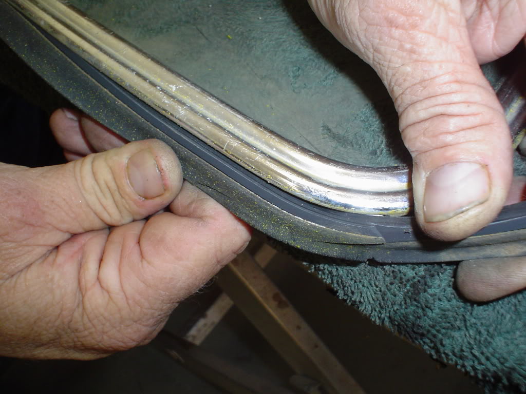

This afternoon, I started on one window to replace the rubber and try and spruce it up generally before installing it.
The rubbers were so hard that I ended up cutting them and pulling the remnants from the channel

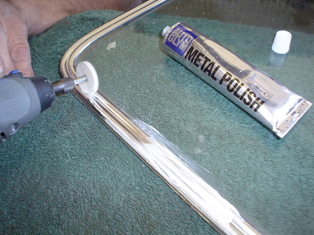

With the rubber removed, I decided to try an polish the aluminium frame. Elbow grease ended up being too tedious, so the trusty Dremel with buffing wheel stepped up to the plate.

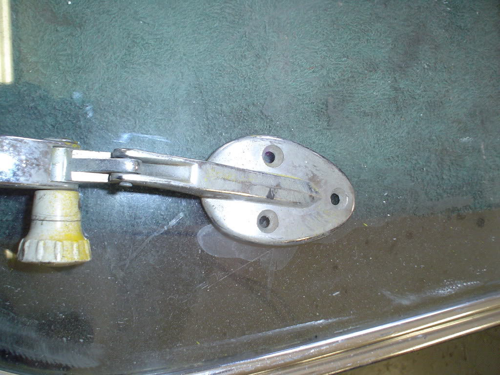

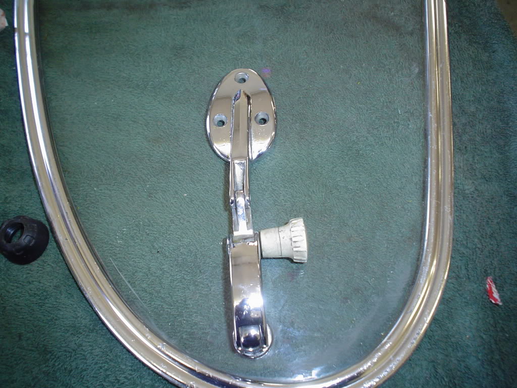

The window clip showed the most improvement (It gets MOER hot under the buffing wheel; so be careful)
Before
After

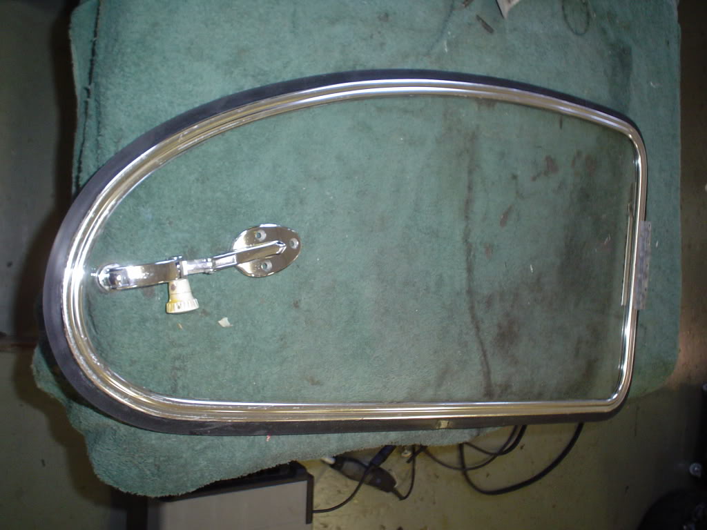

All the previous overspray as well as quite a few years' worth of gunk was removed.
The window is now refurbished and waiting for installation (Thanks Callooker for supplying the rubber. It was well worth the wait)

The glass was fairly badly scratched, and as a last resort I polished the glass using the Autglym metal polish and the Dremel. Only the very deep scratches remained, but they are no longer so obvious.

hitlers revenge wrote:Please supply the price and supplier of that tube of metal polish. Thanks
The polish is Autoglym Metal polish
The local distributors are Ezecare in Gauteng
011 908 5446
Speak to Martin or Henriette Skeggs
They deliver on site and the Autoglym product is really excellent. I have been using it for about 20 years now
