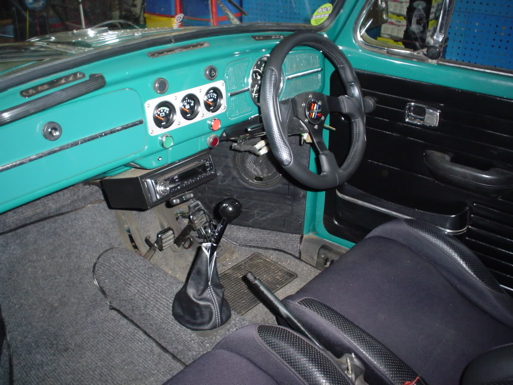

btw jmvv your dash and interior look bitchin!
I'm going for a similar blue colour and black interior... Looking around that combo seems to be quite popular.
