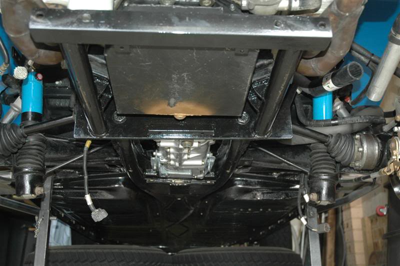

Original Manx wrote:Well it's an epic day today .... after 2 years of development we now know it works. For sure. It drives. And it's awesome.
Thought I'd start a new thread about these boxes and conversions as my 4WD Manx one was getting full of discussion about the topic and should really be about the Manx.

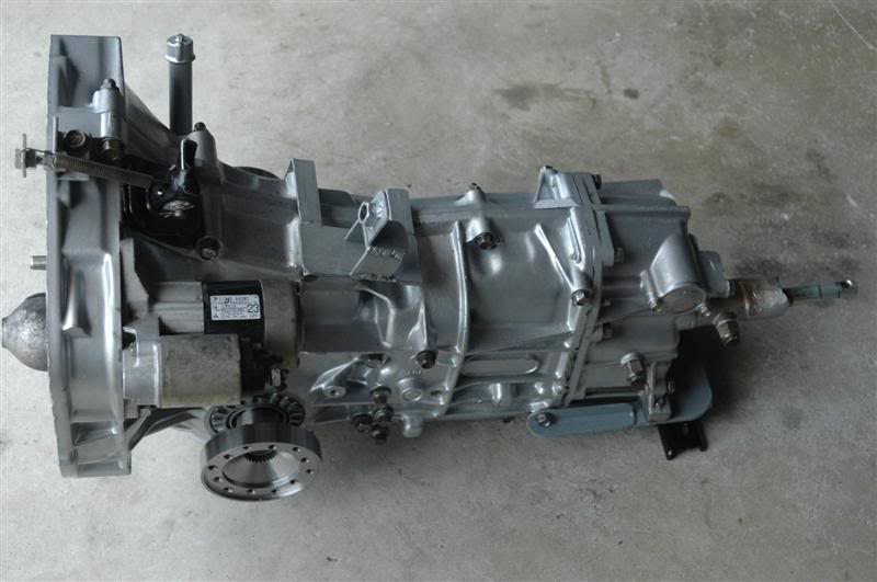

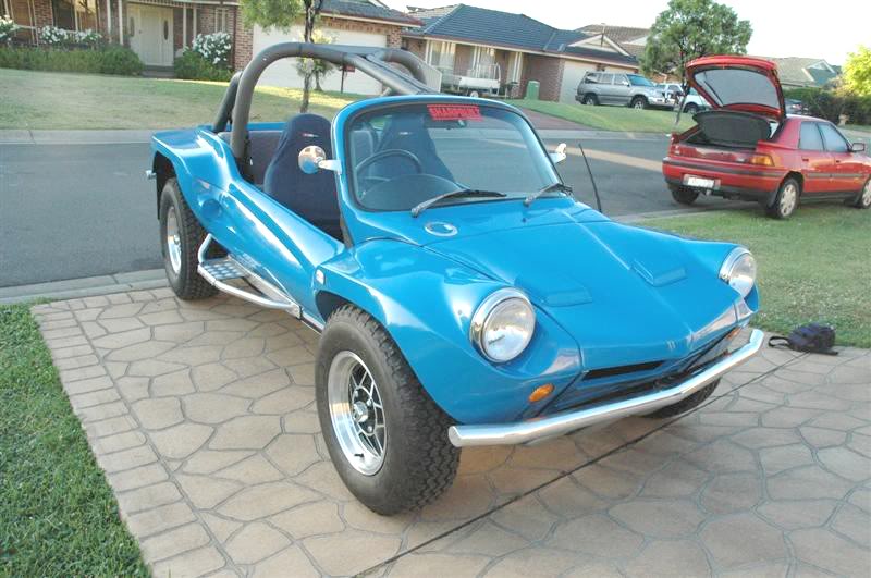

The test reversed 5 speed Subaru was fitted to a Sharpbuilt V2 buggy here in Sydney, powered by an EJ25 quad cam naturally aspirated. This motor puts out around 160hp standard. This motor runs a standard ECU and the transmission has been converted to 2WD and shortened so that it fits into the pan without cutting the torsion bar.
The box I built as a test transmission houses the original Impreza gears, the weakest gearset I can fit, just to see how it holds up in this application. The buggy is a LWB buggy which is licensed for the street and should come in just under 1000kgs (2100lbs) or so.
I used a Subaru cable operated transmission as opposed to hydraulic transmission just to retain the original clutch cable and bowden tube in the test buggy. I could have used a Subaru hydraulically operated transmission converted for cable use with my adaptor, but no need at this time.
We fitted a 3.9 final ratio reversed ring and pinion to this setup as it was the first one I produced, this is the standard WRX 2000 ratio. The owner of the buggy had wanted a different ratio more like 4.4 because of his tall tyres and sand dune driving.....but we needed to get this done and driving. More ratios will be trialled in this setup soon.

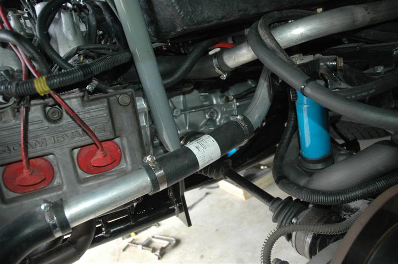

Here's the engine and box in place

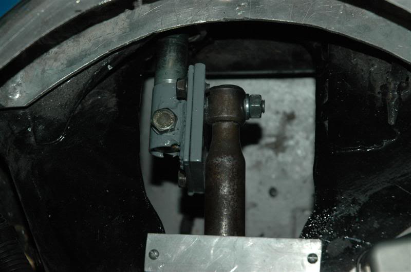

The simple shifter connection, 2 tubes welded to 2 plates and bolted together

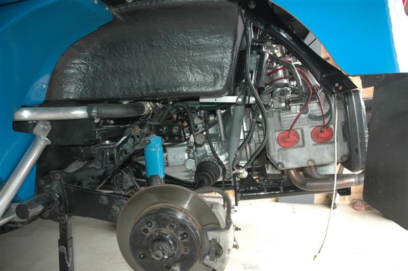

Here's how well it sits underneath, Subaru motor is fitted with a shortened sump

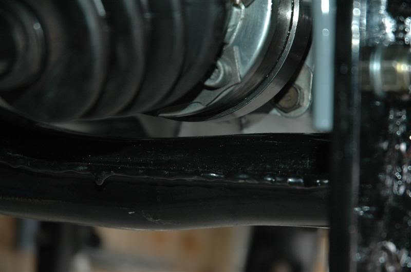

CV joint clearance to frame horns
The buggy was fired up and taken for a long drive around the block tonight. The owner commented to me that he was surprised that the 3.9 ratio seemed quite good actually, with 4th gear 60kph at 1600 revs.
He also commented that the cable clutch with bowden tube worked well and softly, no problems at all. He made some bowden tube holders to fit on top of the Subaru transmission as you can see from the photo.
The gearbox selected all 5 gears and reverse but he did comment that the sideways gate selection was shorter than his old 6 rib kombi box. Forward and backward was fine. We will try some different width plates and see if this makes the sideways movement to select gates a bit larger.
I'll update this post with some more closeups in the next few days and hopefully a video real soon so you can see it going through the gears. :D
