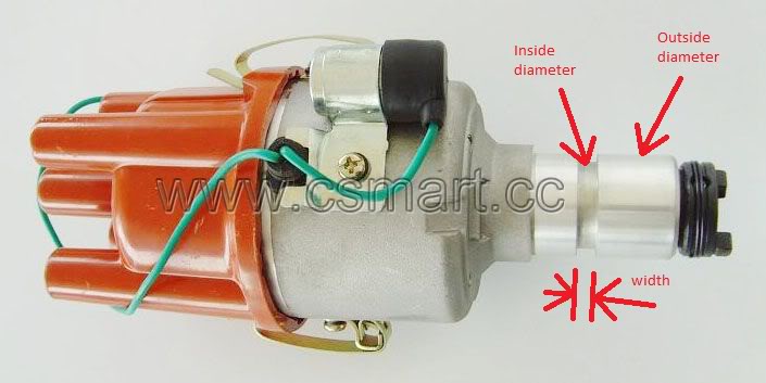

Does anyone have a spare beetle distributor lying around that they can take some measurements from for me?
Please view the picture.
I need the diameter of the dizzy shaft that fits into the case
and also the dimensions of the O-ring groove.

OD 27mm
id 22mm
groove width 5mm
groove to bottom of dizzi 18mm
groove to top of shaft Where hold down clamp v\fits 12mm
total length of part that fits inside block 35mm

I forgot to ask for the diameter of the part the clamp fits onto.
Could someone also measure that for me?

The clamp takes the last 2mm from the top so the dia is still 27
from the end of the tang the total length is 41mm
