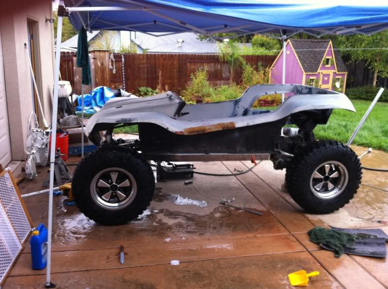

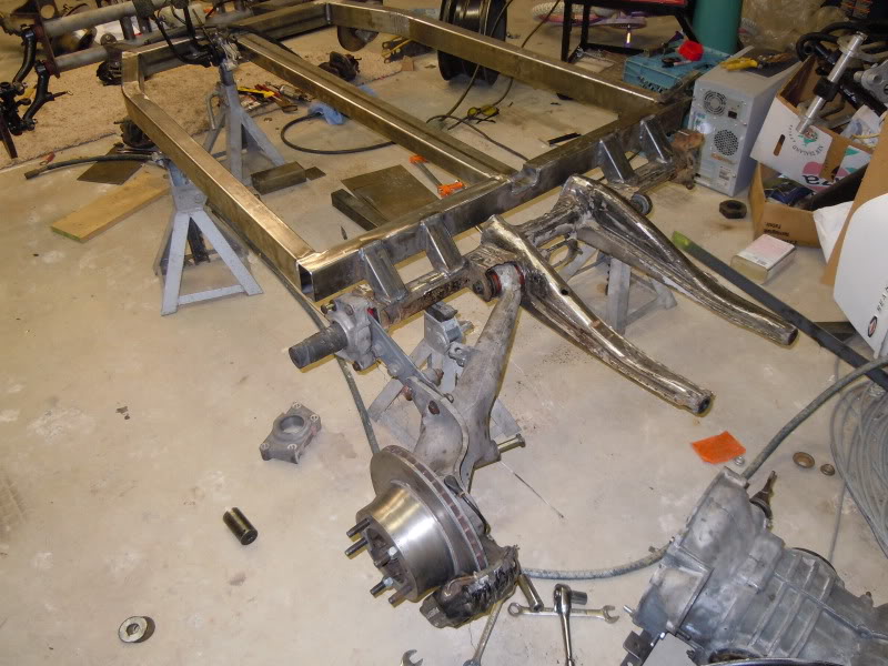

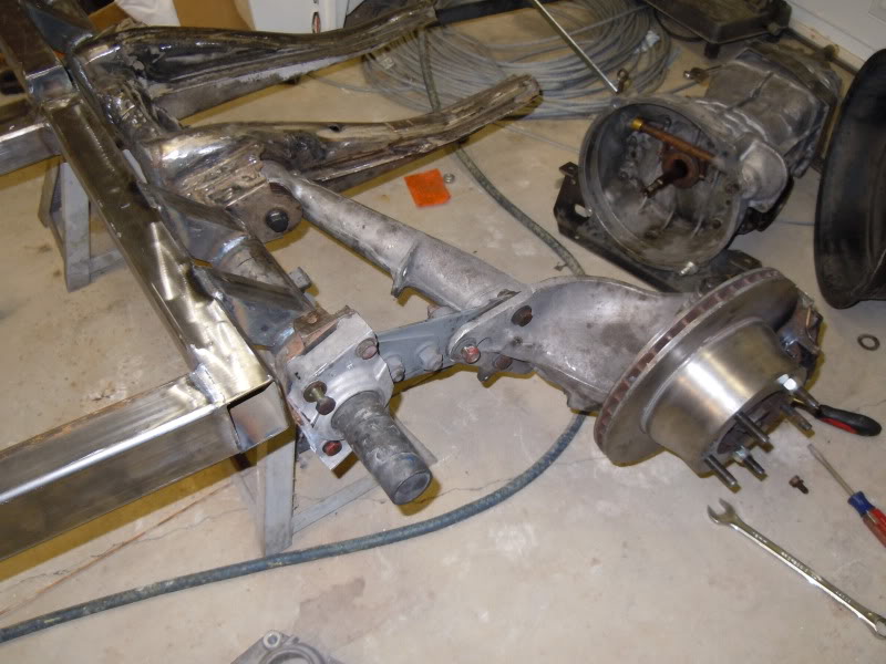

diffdude wrote:My wife wanted to buy a Yamaha rhino to take camping, I told her could build her something cooler. So here's what I have so far. The rear trailing arm are porsche 944 ther 75mm wider than stock vw with 4 piston brembo brakes. I turned the front 944 hubs to take linkpin bearings and made some caliper brackets.
