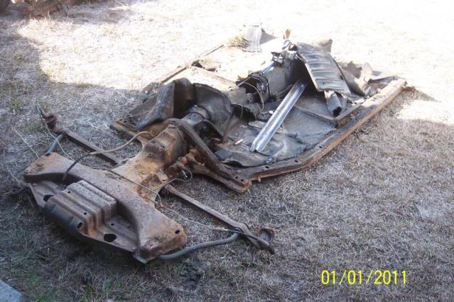

Ive seen a 1308/pregnant beetle floor pan now for the first time and are a bit shocked about the lack of strength in it.
The shock towers for the mc Pherson struts are the inner fenders ( not very thick ) which seems to bolt on the pan only with one bolt on each side.
So you have two strength boxes –one in front of the fire wall/dash and one behind it ----- hold together by the thin neck of the pan.
And the rest of the wheel /brake assembly are attached to the car with a flimsey rod ---not even triangulated properly.
This floor pan would surely not have lasted on our SA dirt roads for long and would never have ended up in beach buggies
No wonder Ralph Nader had sleepless nights about the rear engine cars.
