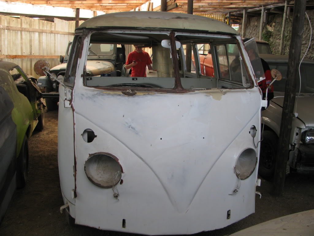

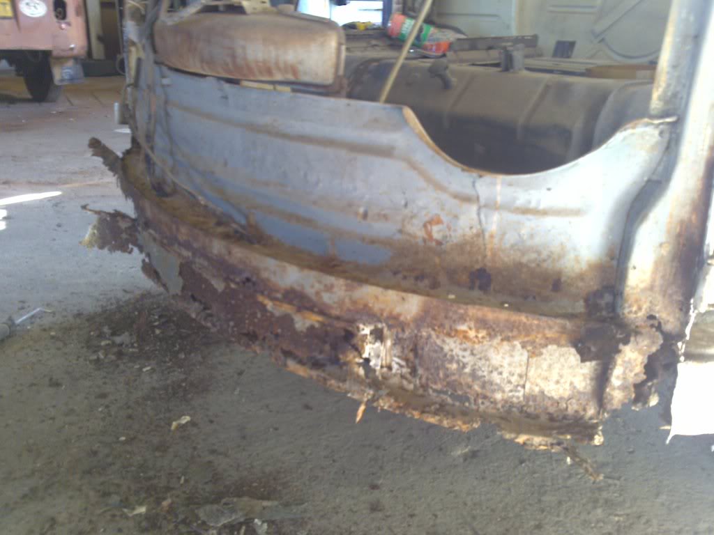

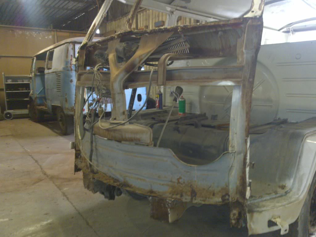

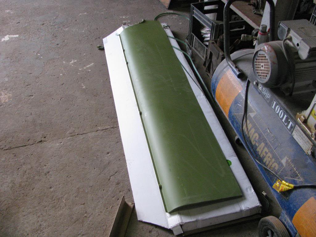

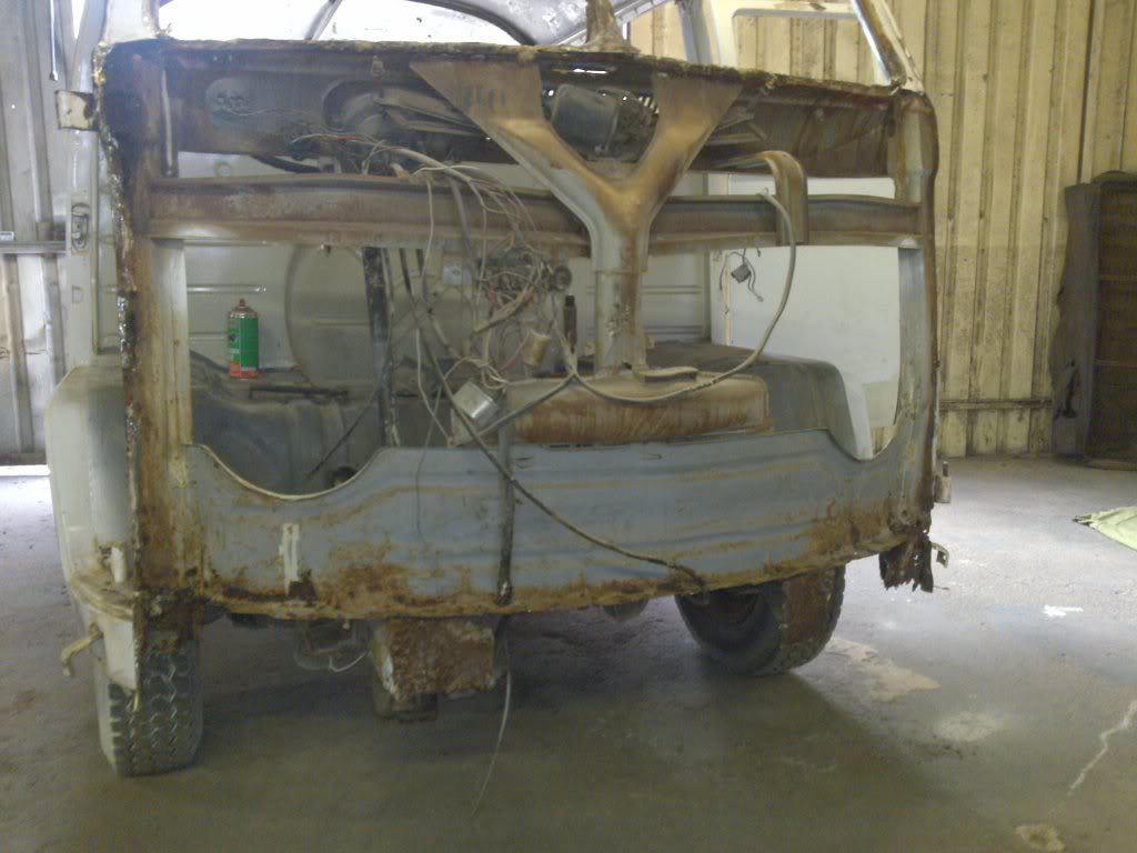

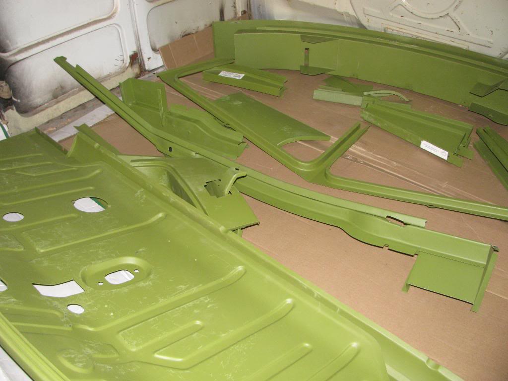

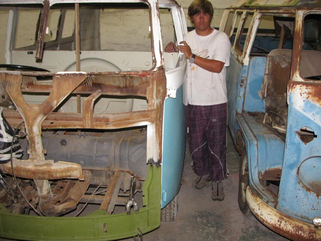

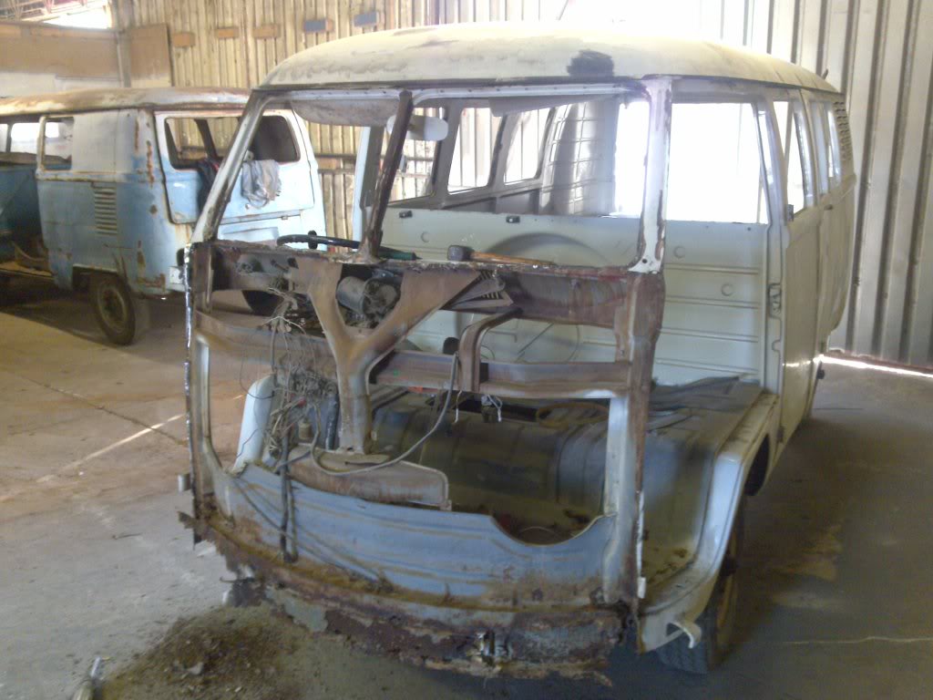

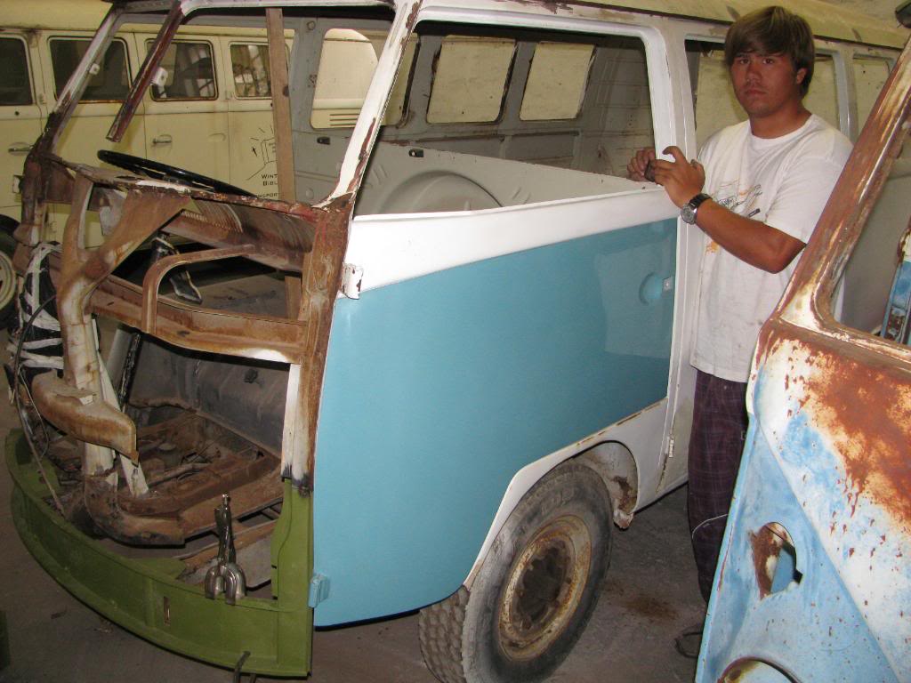

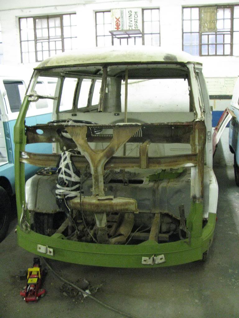

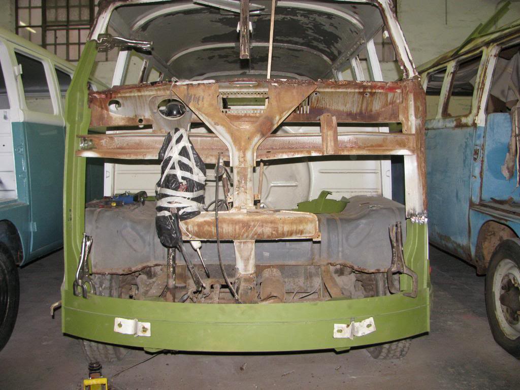

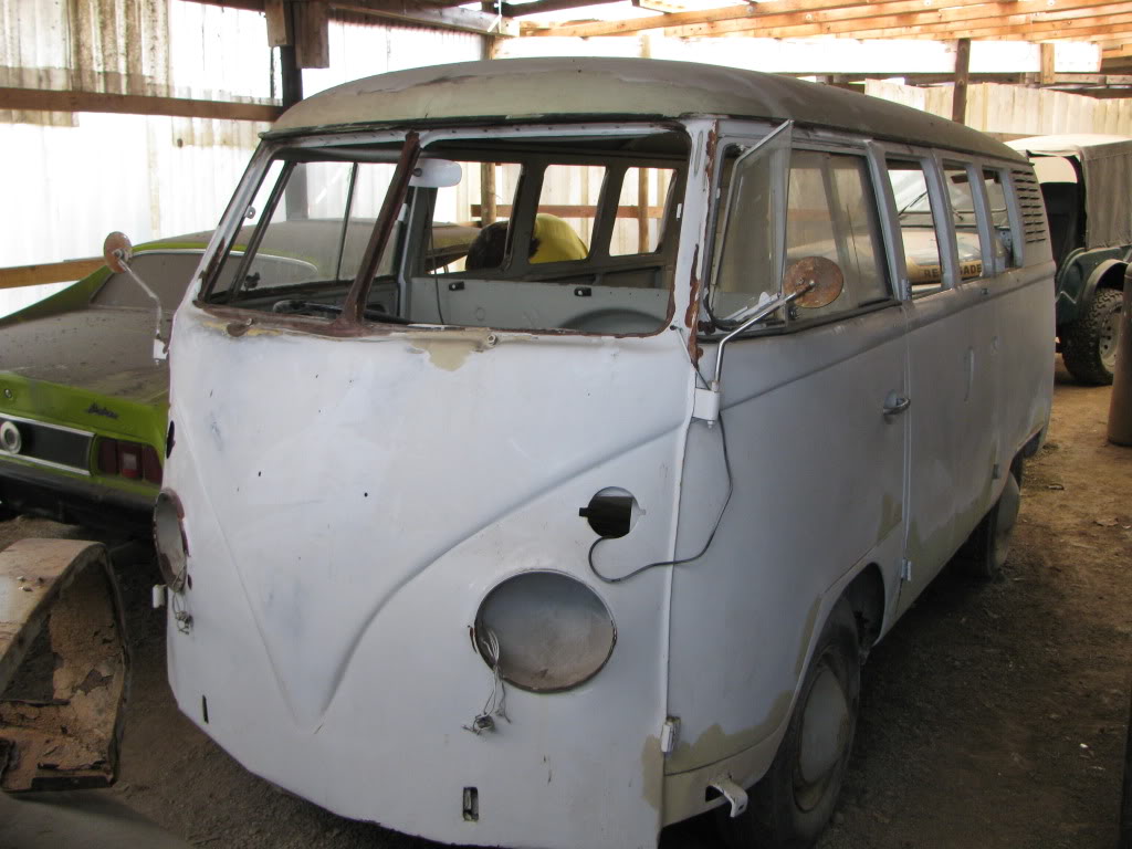

strated scratching around on my '67 australian bus ....it's amazing how good they can look from the outside :D ..but rotten on the inside :cry: ...nevertheless...rather fix and know what you have than patch and be unsure every time you drive it !
took a few pic's

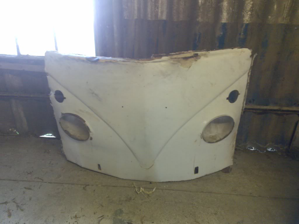

removed the nose and valences....and about 5kg's of body filler on the front...rest of the bus is great except for the obvious sills and valences.....
so now we wait for the replacement front to come and some "A" pillars...etc...
keep you posted.. :hangloose:

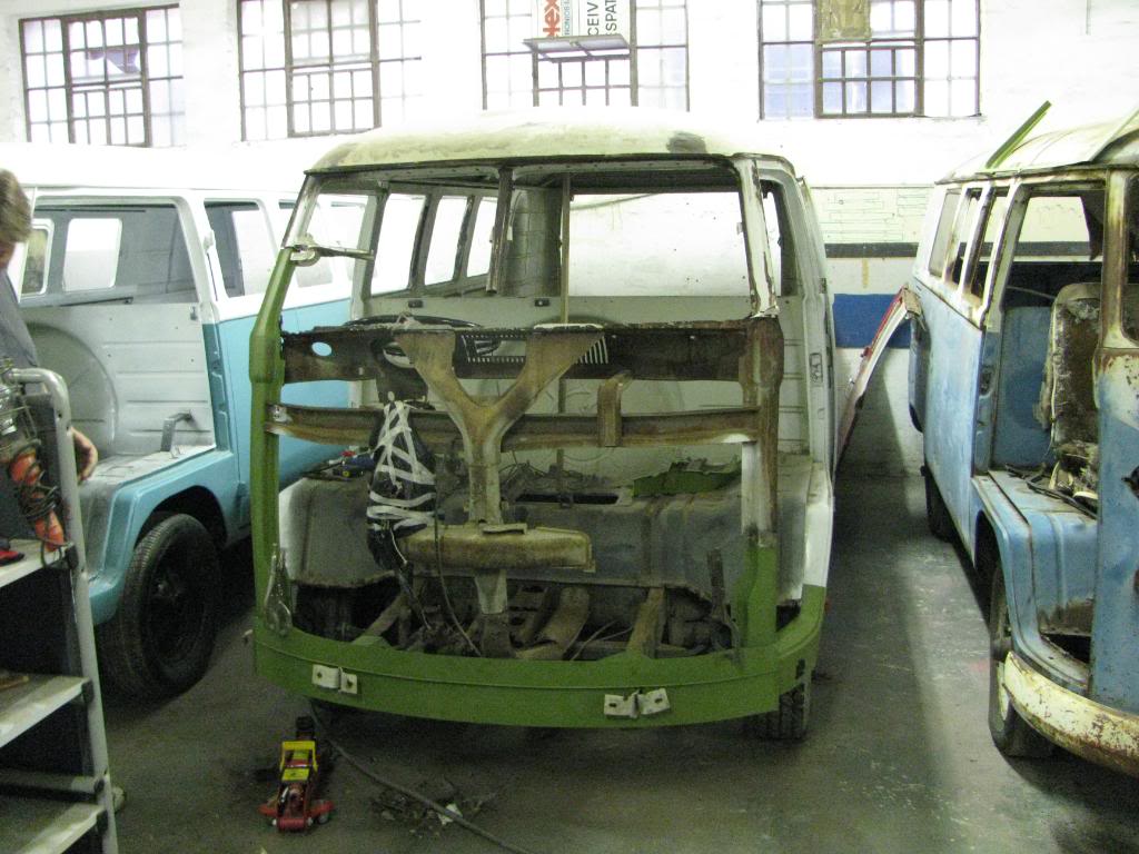

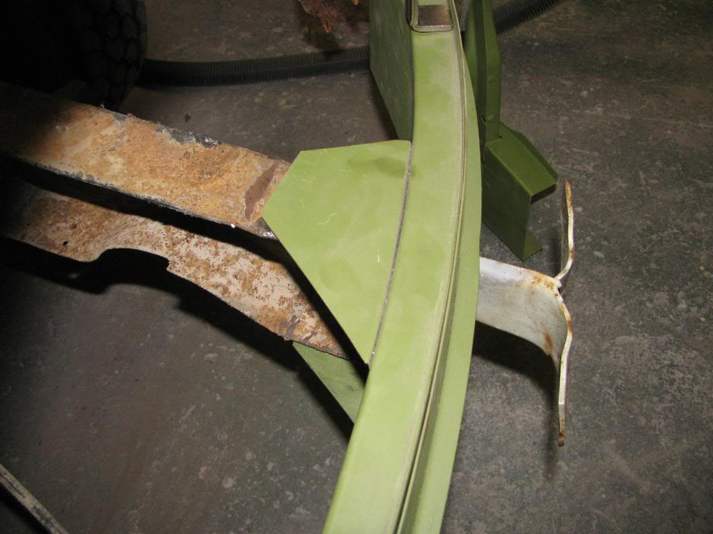

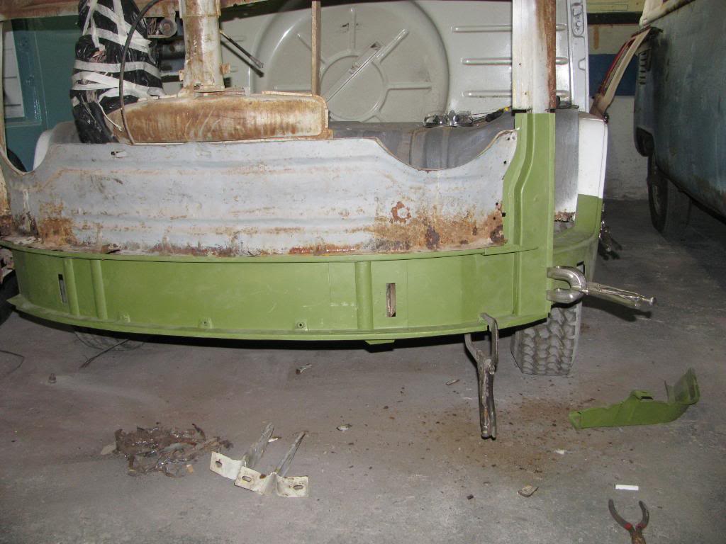

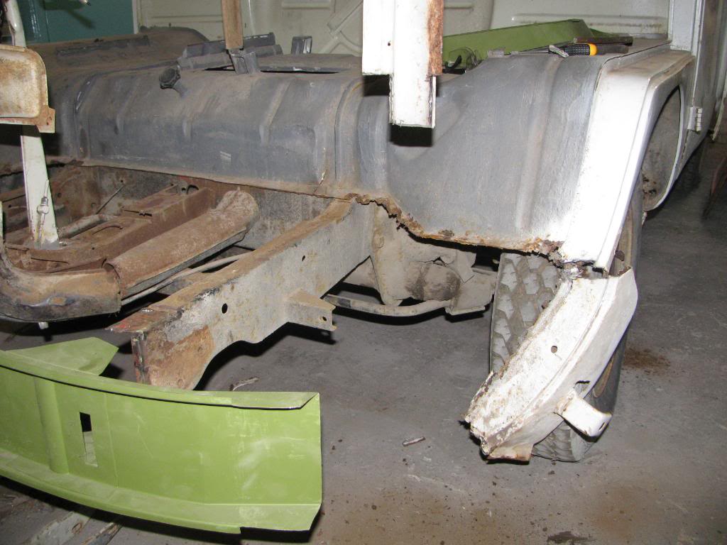

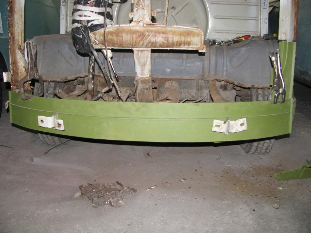

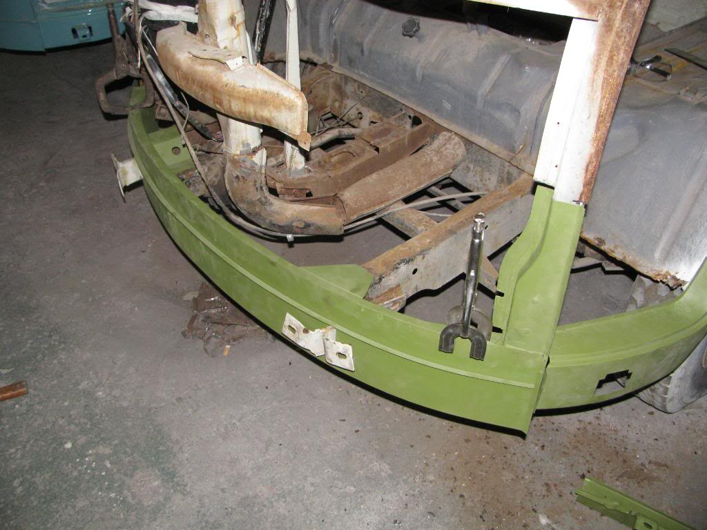

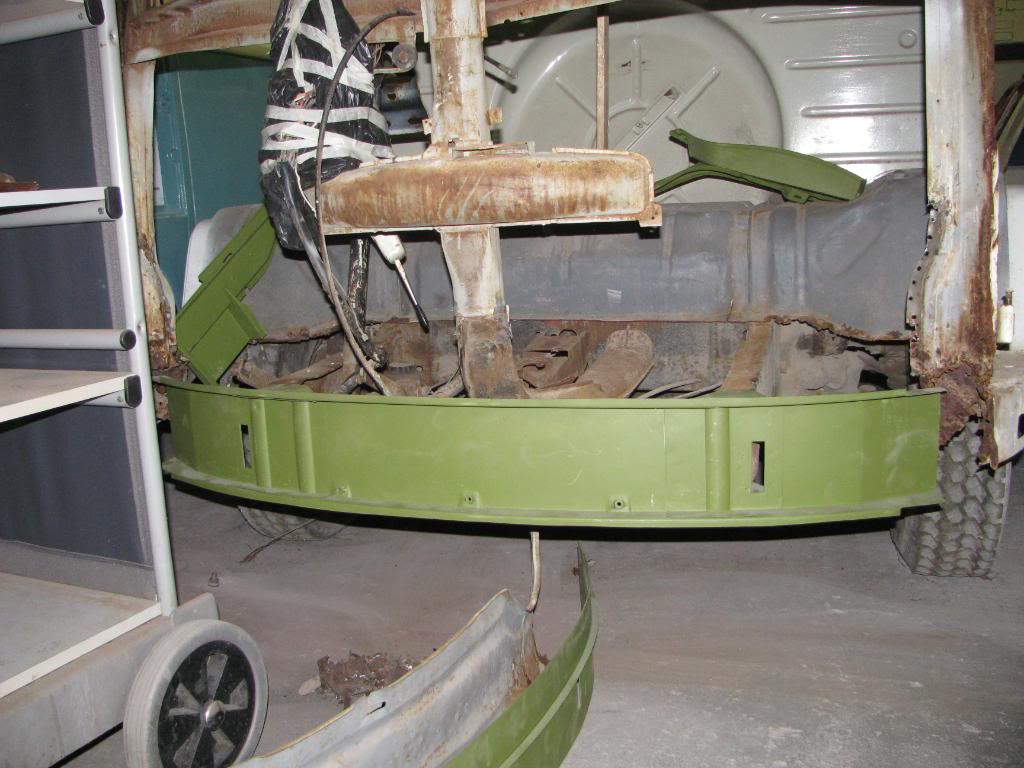

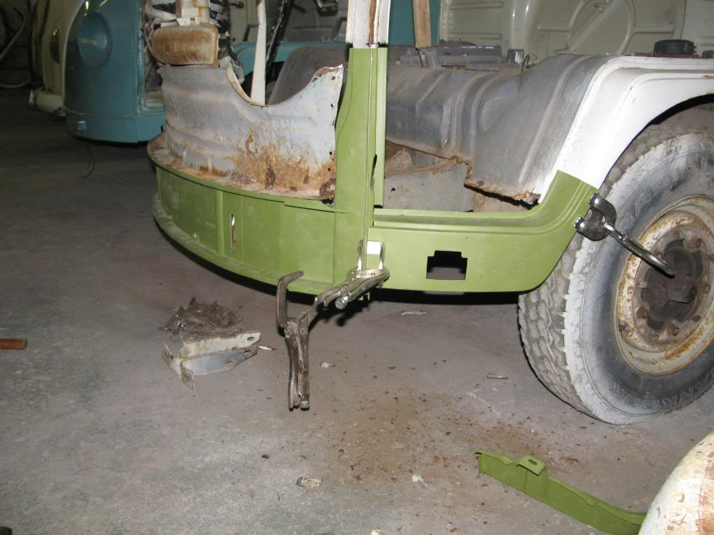

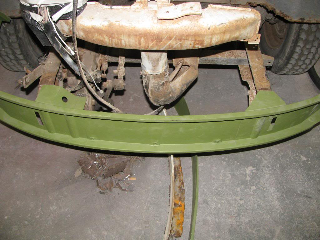

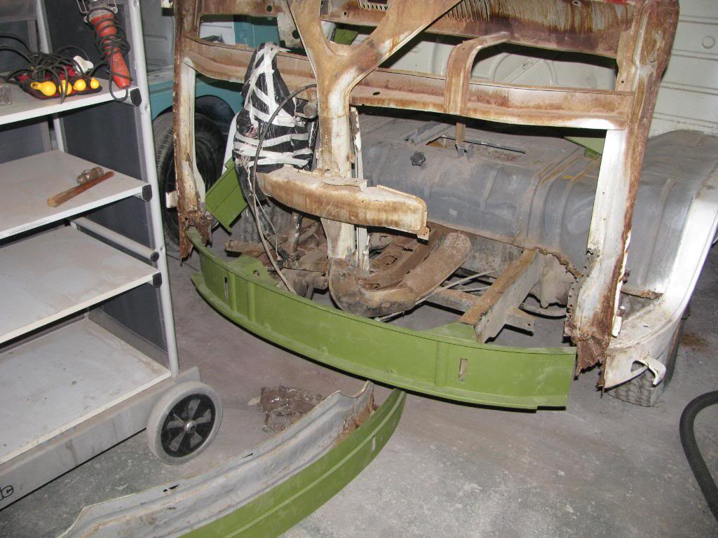

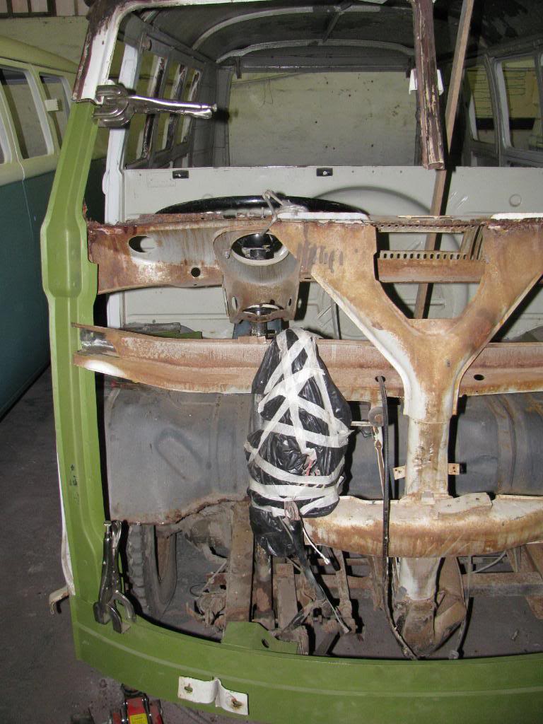

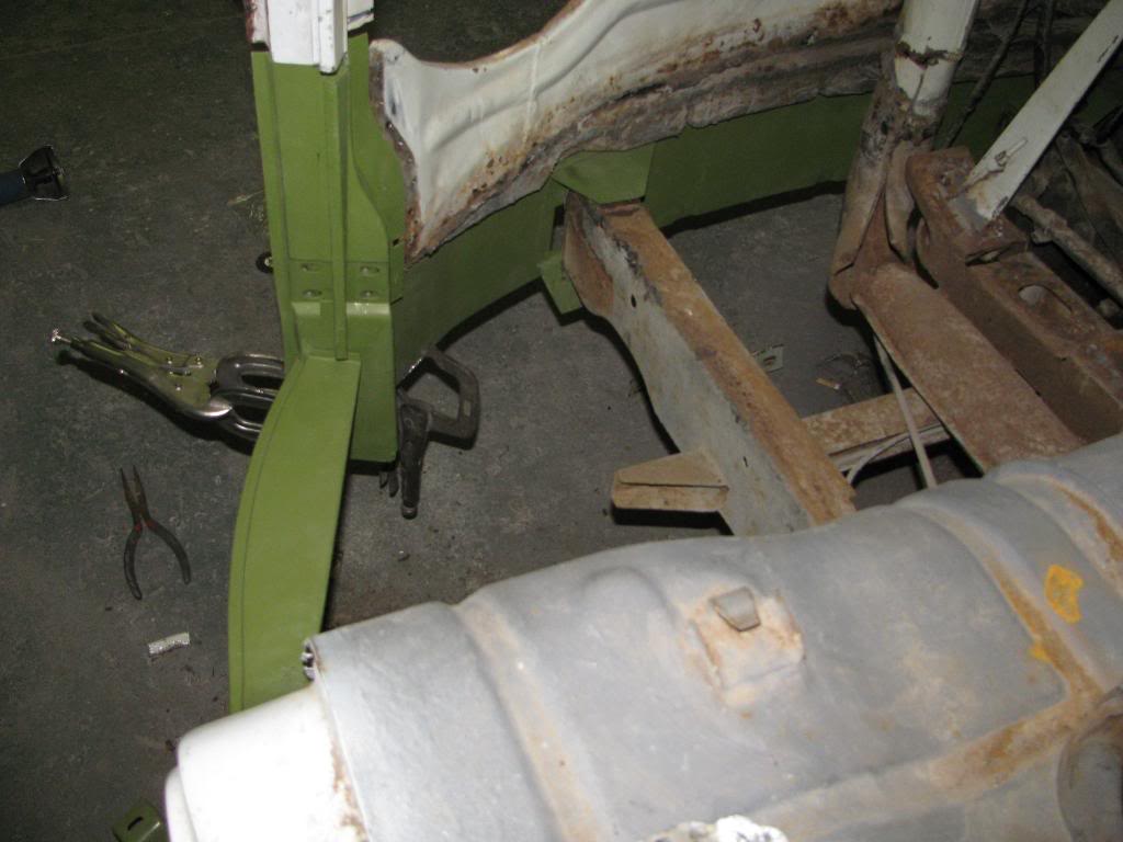

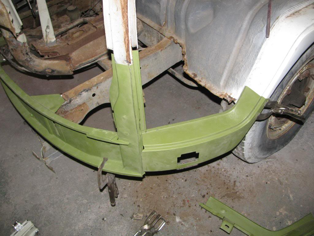

did some more stuff on the Ozzy bus today.....
took off the headlight bucket support panel..and started to prep and trial fit the new inner valance...

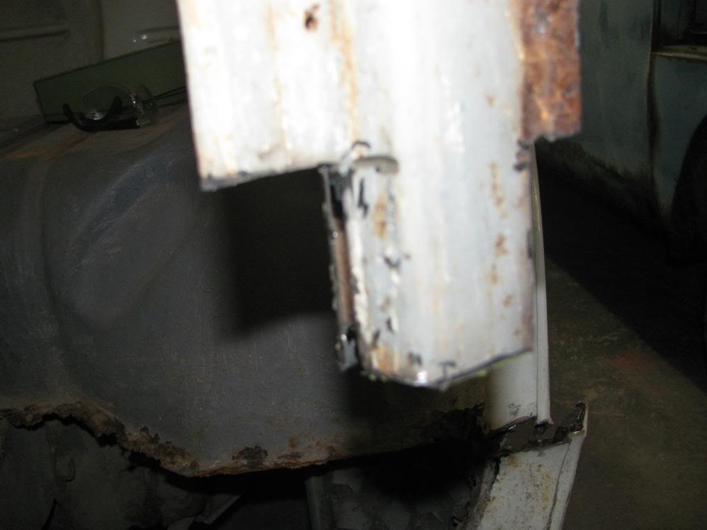

cut the left side A pillar...trimmed it up and crimped it slightly to fit inside the new one as a guide and to add strength...
trial fit....
placed the bumper brackets to see if everything lines up ok .......
i do have one or two little snags here and there...like trimming the A pillar a touch too high...but i can fill that in so no prob. !
all looking good so far ! :hangloose:
i am getting a new headlight bucket support panel...just used the old one to check alignment..in case any one was wondering... :lol:
now i have to prep all the surfaces and paint the inside of the new panels before i fit them...once fitted i won't be able get in everywhere behind to paint and seal.....enjoying every minute of this ! :D

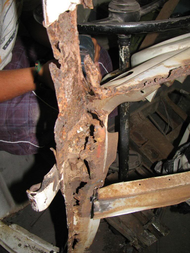

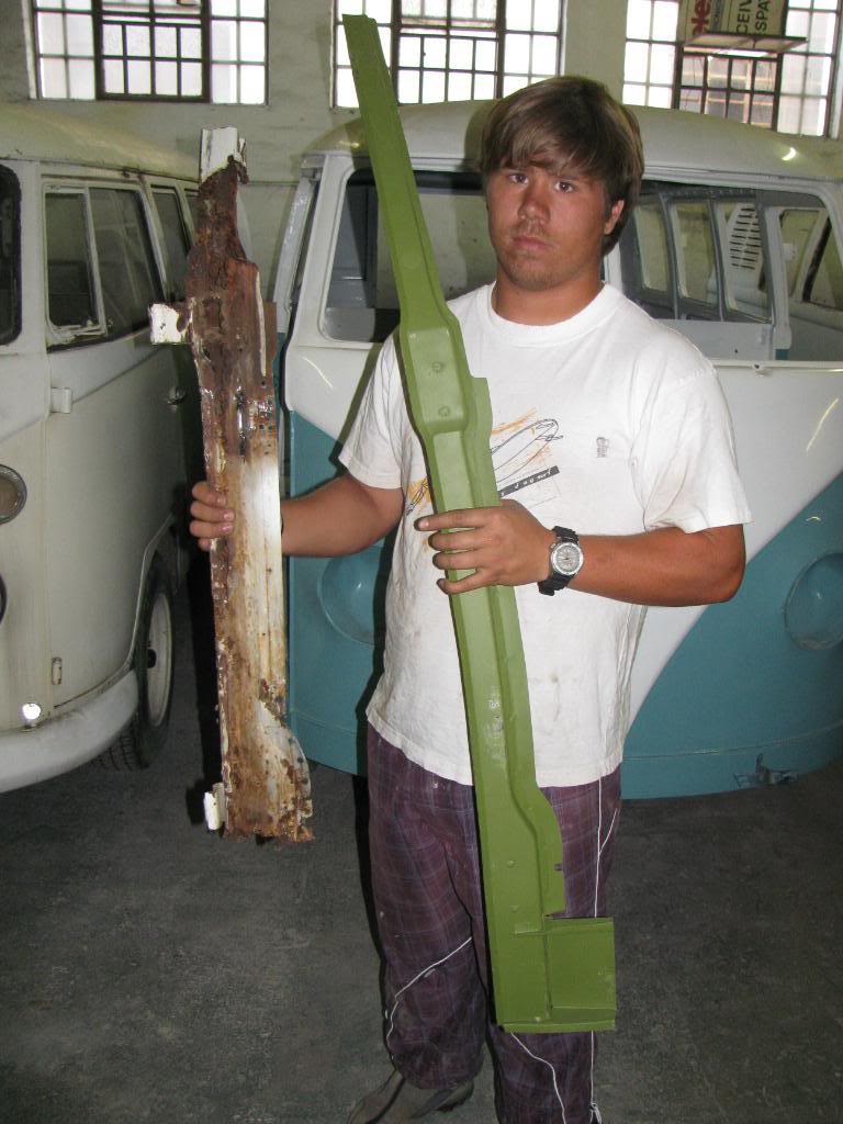

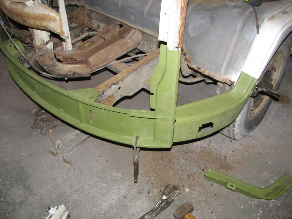

did a bit more today....trial fitted a door to see if all the Gaps are correct (even though i measured through out the operation)
decided to cut out the rotten drivers side A pillar and fit the new Gerson one...
all coming together slowly.......
