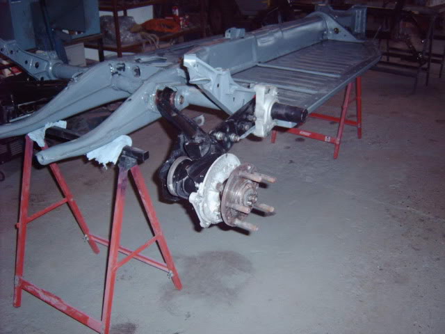

A good platform to work on----this guy is building a Covin 911 kit car

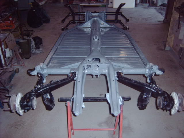

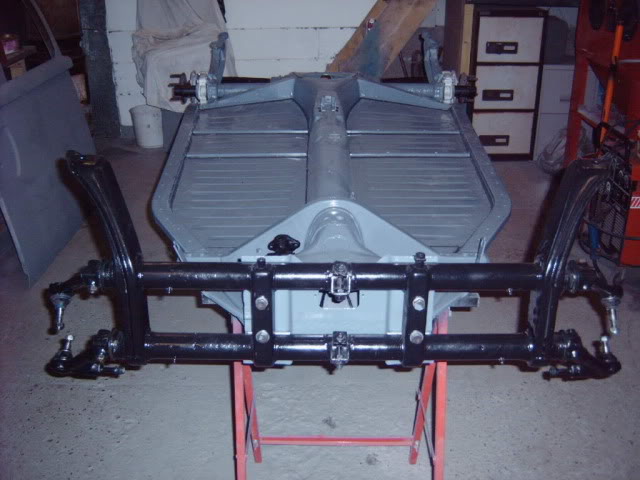

The rear end of the pan is vw1303 and front end type 1

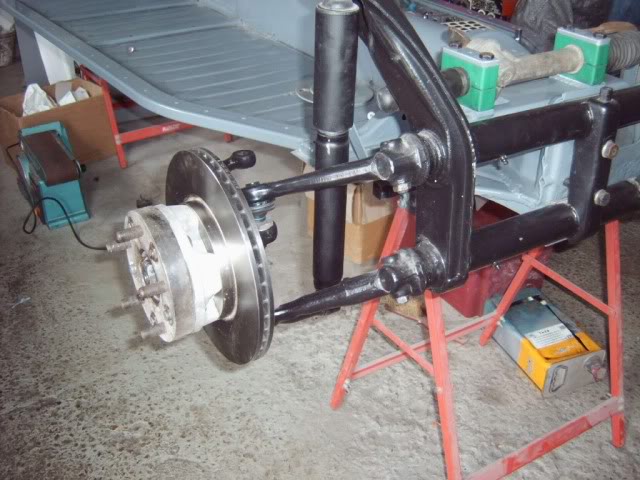

Chassis with part of the suspension fitted:

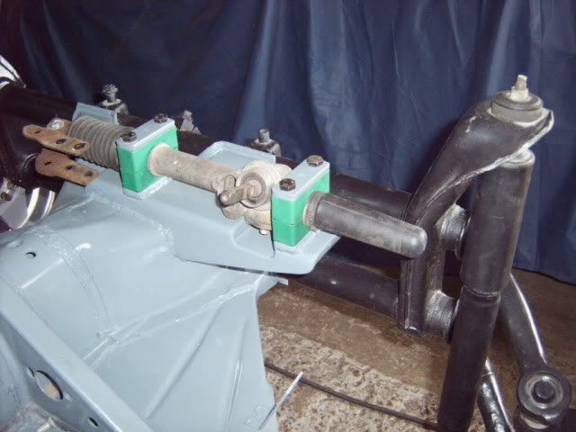

Rear: Porsche 944 torsion bars/torsion arm covers/adjustable spring plates/complete 944 diagonal arms and polyurethane bushes.
Front: Type 1 beam with adjusters/polyurethane arm bushes and new ball joints.
The 944 front hubs are at the machine shop being modified

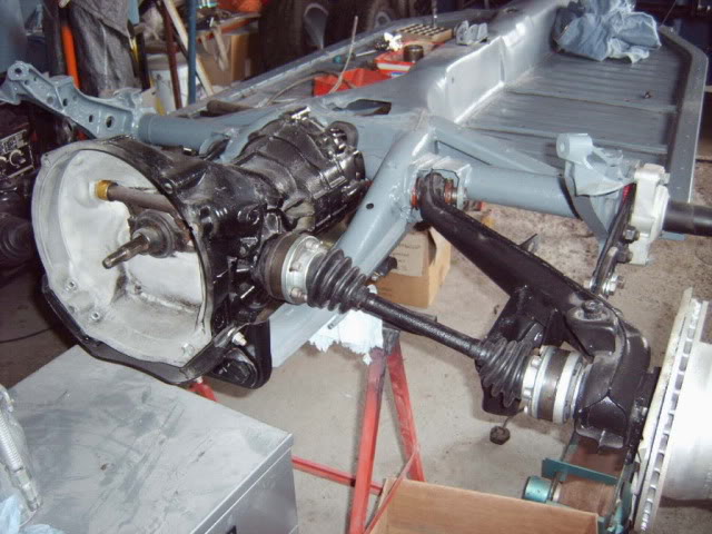

Porsche 944 front hubs and discs fitted, VW Polo rack, Beetle 1303s gearbox. Also now have a Subaru EJ16 engine
