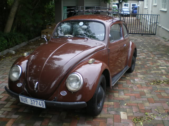

Hi YaAll,
As a project I am going to post my 1959 Beetle In the BEFORE and After I am Done with It.
This was a project, but now I want to up it to be MY Beetle, lets see if it can be done.
Here it is when I started,............

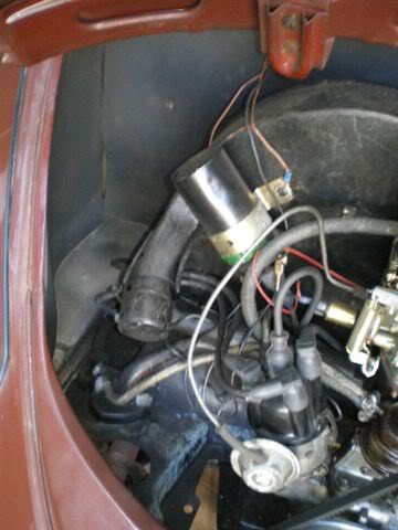

The most magical part of this car is that the engine bay is perfectly clean, no oil anywhere.....BUT the motor is covered in OLD oil, blow out oil from the breather, and oil dripping from all joints, YET there is NON on the engine compartment as can be seen from the photos here under????????????????????????/
Image Image
As the motor is not the same as the Papers, now it becomes a mission to get this thing onto my name, ... what joy..... :roll:

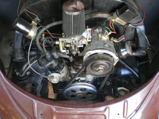

Hi, i am busy with my wiring on my beetle. I see your alternator is the same as mine. Where does that 2 wires go to, I know the one goes to the battery.

Eugene Pfeil wrote:Hi, i am busy with my wiring on my beetle. I see your alternator is the same as mine. Where does that 2 wires go to, I know the one goes to the battery.
Hi,
All Gennies, and alternators look alike, beware.
If it is an alternator, find out if it has the voltage regulator inside, if yes, normally one wire to the battery and one to the charge light.
But if not sure, have a auto electrician look at it, as you may blow the voltage regulator.

Here is the picture of my alternator on my 68 bug. I got some wiring diagrams. It seems that the alternator warning light connects on to voltage regulator

Eugene Pfeil wrote:Image
Hi,
With a 4 wire, this normally means the voltage regulator is out side, so the light will be on the regulator.
Your engine looks good, nice work.

Thanx. I am still learning on how to do all the stuff, as I am only 17 years old. Which models had this type of alternator, because I can't get a diagram on the samba. And is this a alternator or a generator? I got diagrams from another guy and on the diagram stands that it is a generator. I am very confused.

Its an alternator with an external regulator.check out speedy Jims' home page

Think that alternator with external regulator was only used in 1974 type 1 engines.
