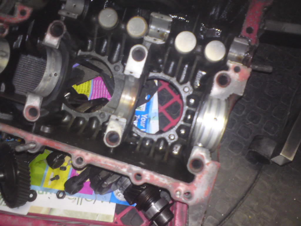

When stripping down the donor engine it was obvious that it was still in very good nick

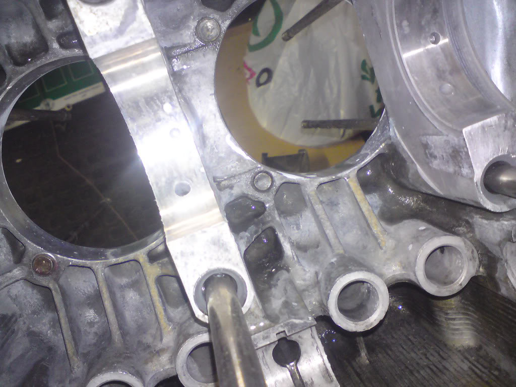

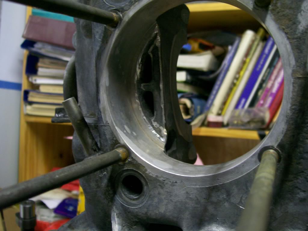

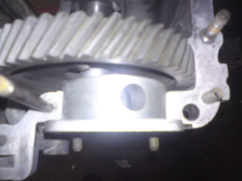

The casing was line bored to 0.5mm over to clean up imperfections and the cylinder spigots opened up to fit the big bore kit. bothe cases were trued up at the sealing sufaces.
this pic shows the thickness of the cylinder ledge after boring for the cylinders
this pic shows the std ledge

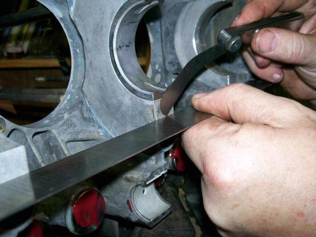

this shows checking the center main saddle for distortion (none found) this is also the reason many builders skim the casings before boring as many engines are distorted here.

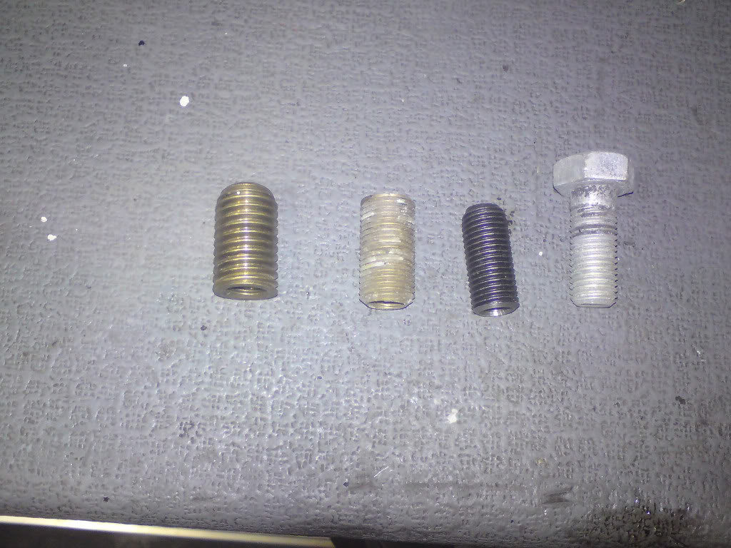

the studs were removed and newer style inserts fabricated and installed this work was done prior to machining the spigots so as to ensure accurate faces

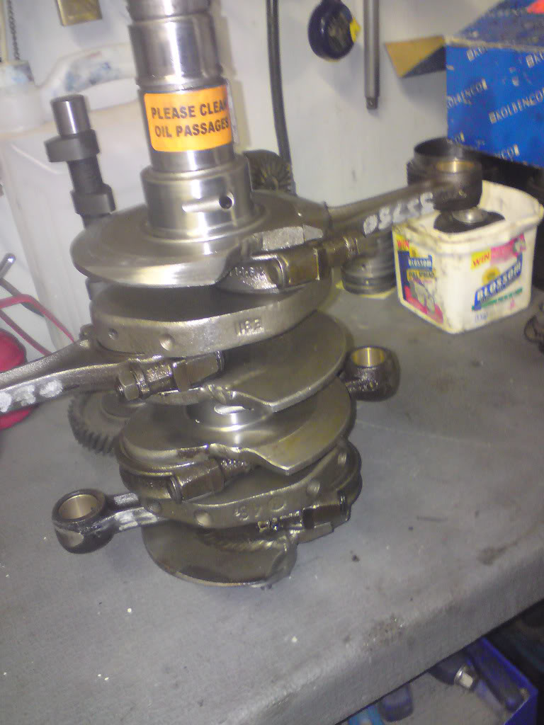

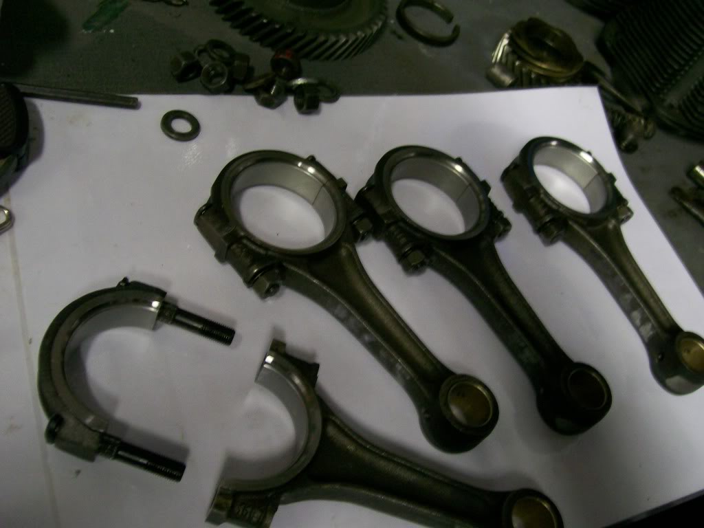

the conrods recieved their share of work. bothe big ends and small ends were re machined to std dimensions

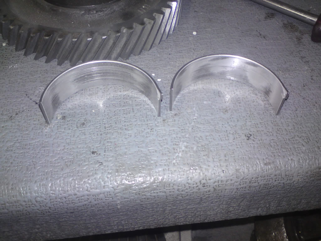

The photo shows wear on brand new bearings when the customer tried doing it himself and didnt believe me that engine lasted 3 km (Not Figs engine :D )

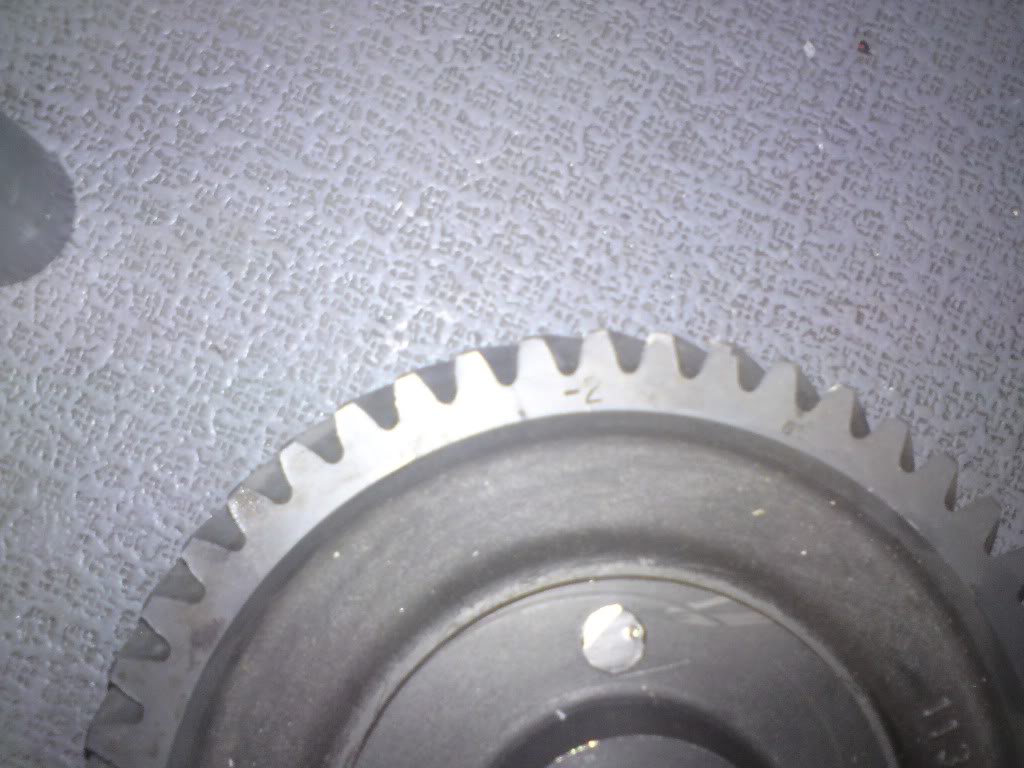

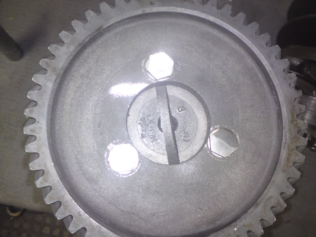

The cam gear must be machined for countersunk bolts
the cam gear has a number which preferably should stay with the specific casing (not a big deal for std engines)

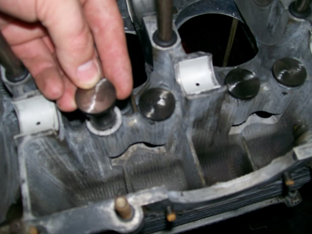

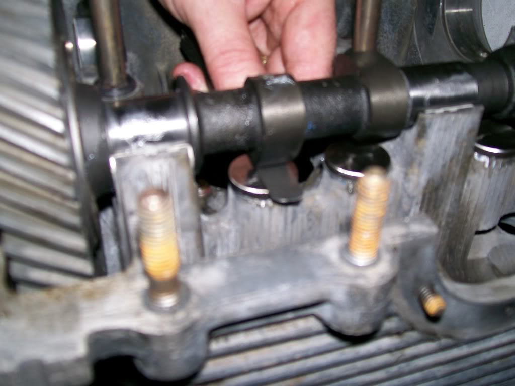

with a new cam it is a good idea to check whether there is play between the lobe and follower when installed as no clearance here will ensure total destruction.
using different pumps and cams also calls for constant checking of clearances

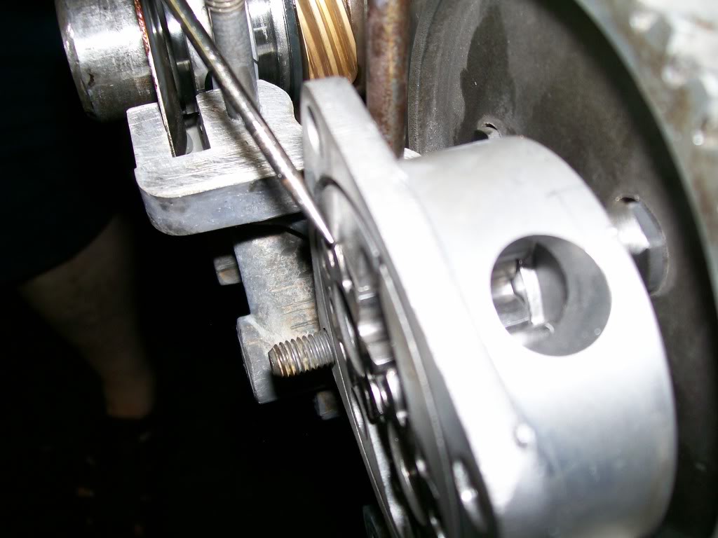

huge pumps often catch on the bolts used for holding the cam gear and it is good to check and clearance parts the empi pump filter combo needed to be clearanced as it also hit the crosmember boss and would not slide in all the way.
another often overlooked problem is that the drive gear on the pump presses against the cam and oes not fit all the way forgetting to check this means a ruined engine.

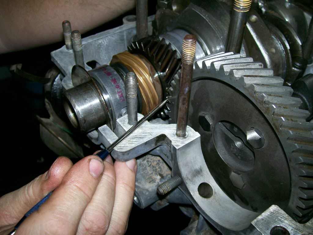

final cleaning of the case is followed by installing the distributor drive and distributor drive this way ensures that you dont battle to install the drive later and possibly damaging the brass gear. Then the crankshaft is set in place i like to use vaseline as a pre lube and this has served me well. Next to follow is the lifters (I lube these with CV grease if I dont have the lube as specified by the cam manufacturer)
A final check that everything is in place and that the bearings are correctly aligned on their locating pins.

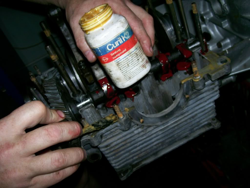

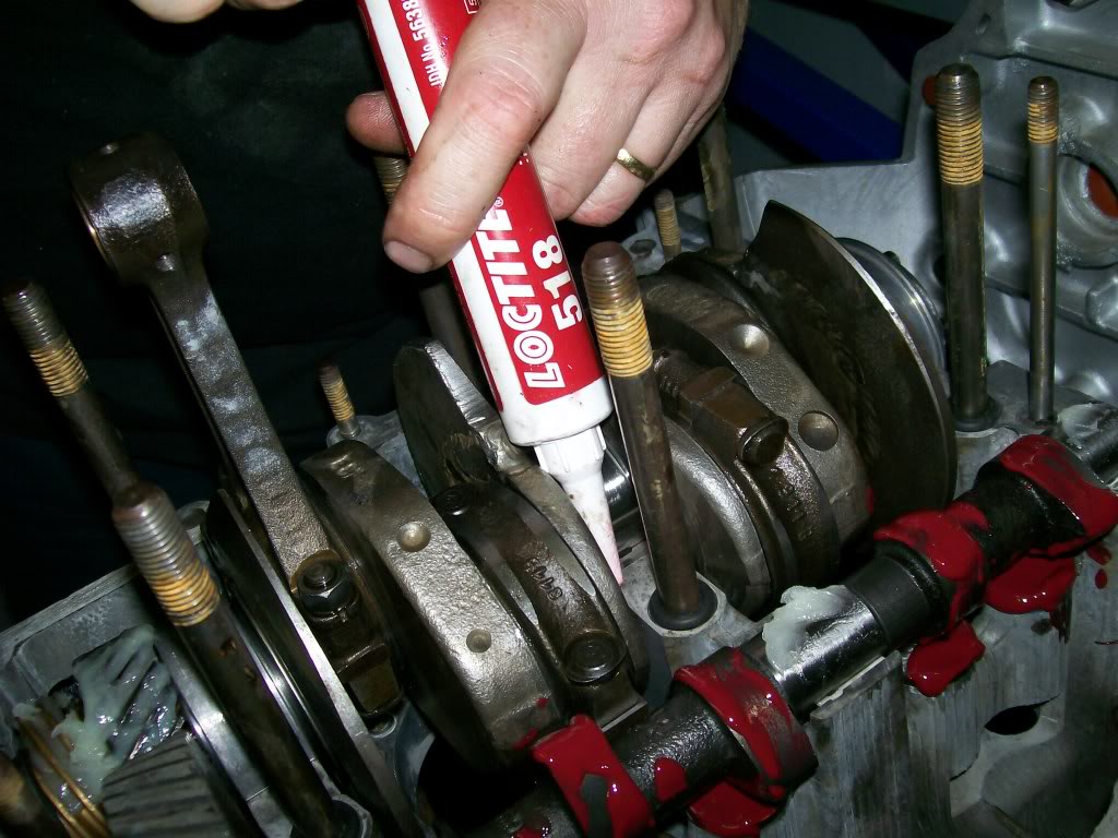

Now is the time to ad sealant. I use two types on the case
Loctite 518 for the cam plug and the studs straddling the camshaft i also use this at the oil pump and cylinder bases.
The Curil K2 is used on the rest of the casing this is the stuff used by VW

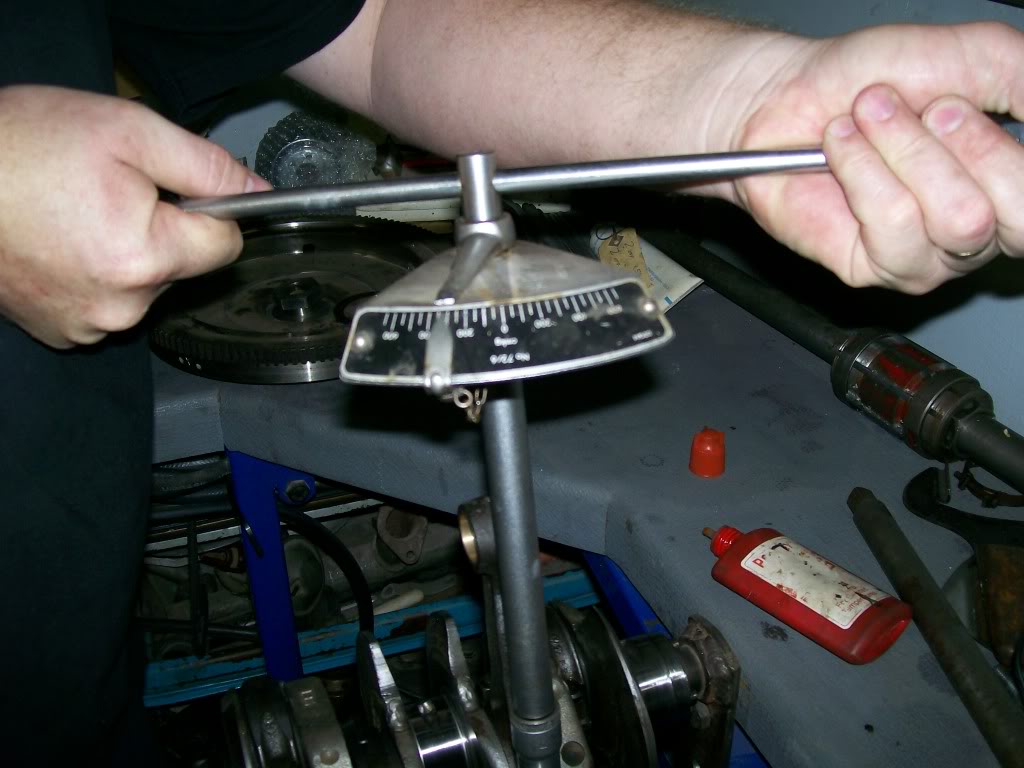

Once the case is torqued ( I religeously follow VW torque settings only deviating on conrod nuts where I use loctite and the std setting
I then set the end play
I use a modified gland nut and a special steel washer to spread the load

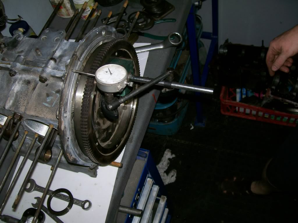

If you buy a counterweighted crank secondhand get the flywheel as well. Or get the person to do the 8 dowelling before purchace Fig only had a crank and matcing the dowels was the biggest obstacle in this build.

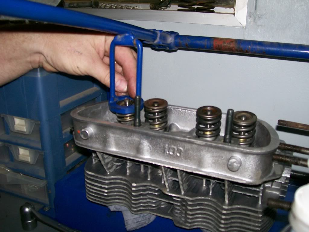

The auto linea heads needed lots of de burring and even downright drilling of small holes in order to get the airflow to go as VW intended but the heads are real nice.
