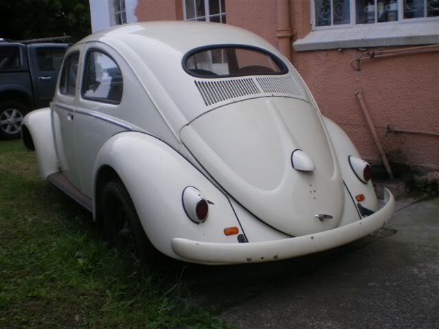

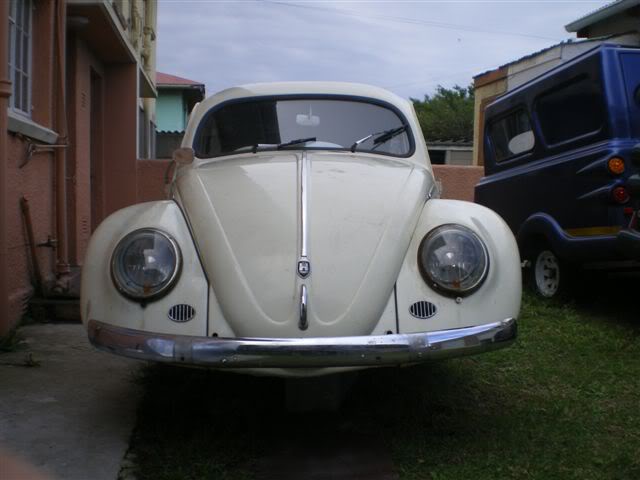

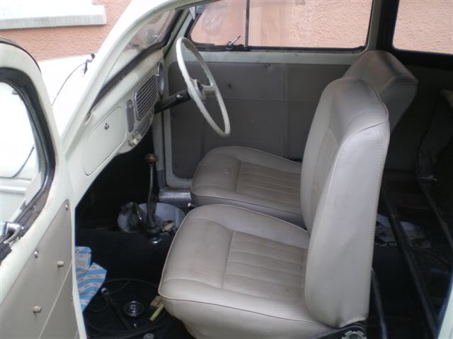

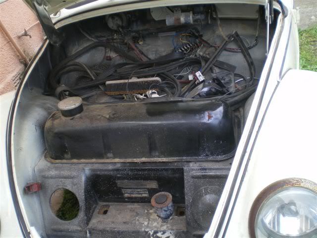

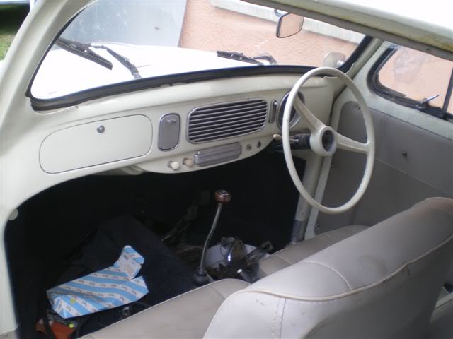

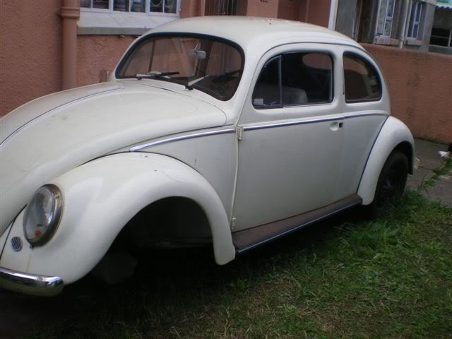

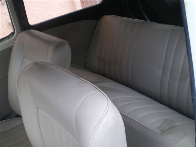

Hi Guys, with the Fastback Project drawing to a close, Have collected an OLDER girl to play with.
Not quit Old enough, but she will do till the 52 Auntie comes along.
Still not sure what to do with her, but some of you will tell me sure enough.
Edit;- changed the Title, due to my stupidity on Model year, ..
Here are some pic's as she sits in the workshop yard, at this moment.
