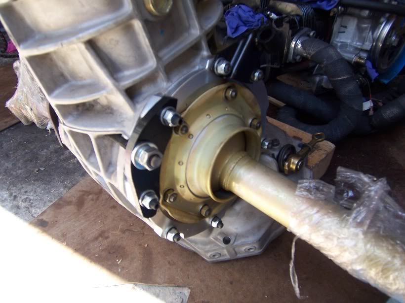

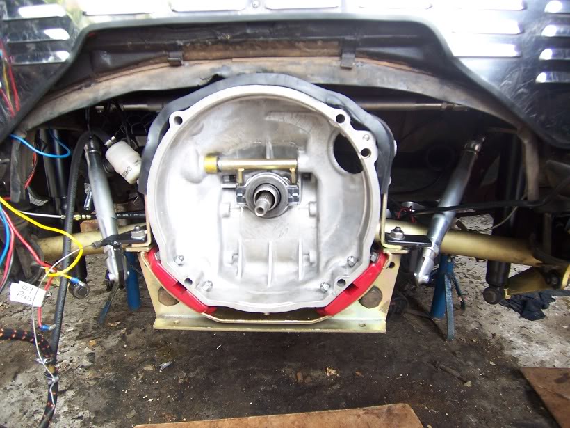

- Posts: 14994
- Been thanked: 487 times
Re: super beetle gearbox
Swing axle (mine)
IRS (not mine)
IRS (not mine)

- Posts: 21
- Joined: Sat Sep 01, 2012 10:36 pm
- What model do you have?: 1974
- Location: cape town
- Has thanked: 4 times
I definately have the one in the 3rd picture(irs) as well.All's well I'll keep my swing axle one in place. thanks
