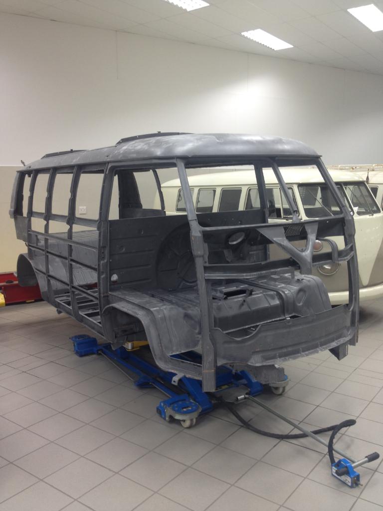

So Sean's (FooFunk) panel came in on Saturday.
Justin and I threw a hoop style rotisserie together
3460
Rolled it outside
3461
And tipped it over
3462
Justion has a bit of work ahead.....
3463
Few more pics here:
http://www.facebook.com/media/set/?set= ... 743&type=1
We need to determine how 'correct' this job needs to be. Given the plans for the motor and use of the vehicle, I'd like to see upgrades and improvements over the original.

:hangloose: :hangloose: Man, I like that rotisserie.
It's fantastic that this bus could be saved. :D
Good luck!
