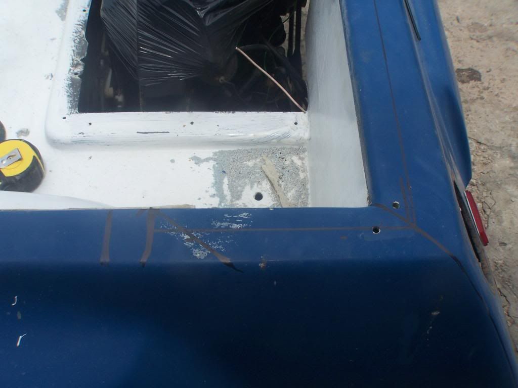

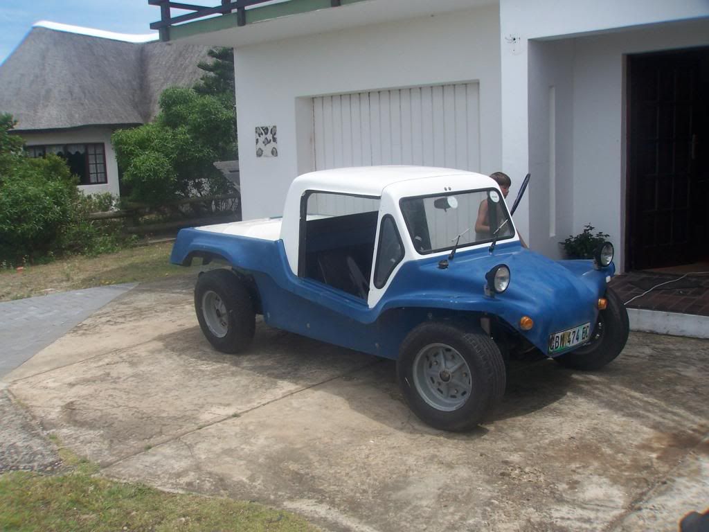

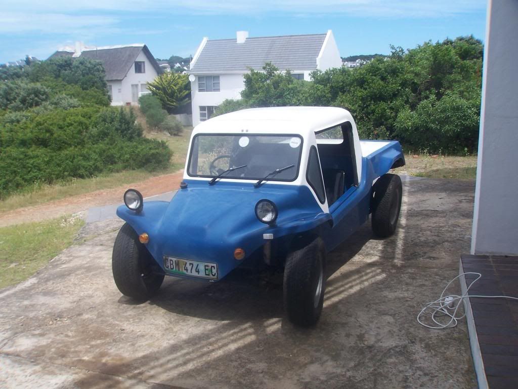

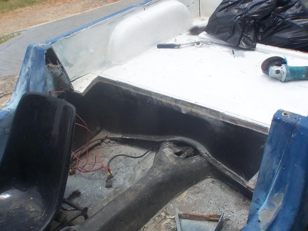

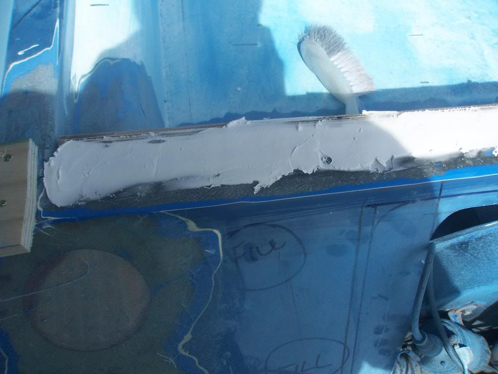

Before stripping and cutting started

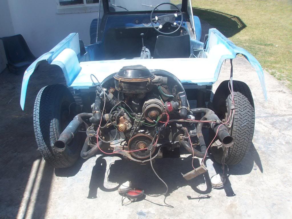

Cutting starts!
The bak was shortened quite a bit

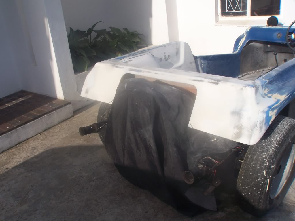

Back cut off

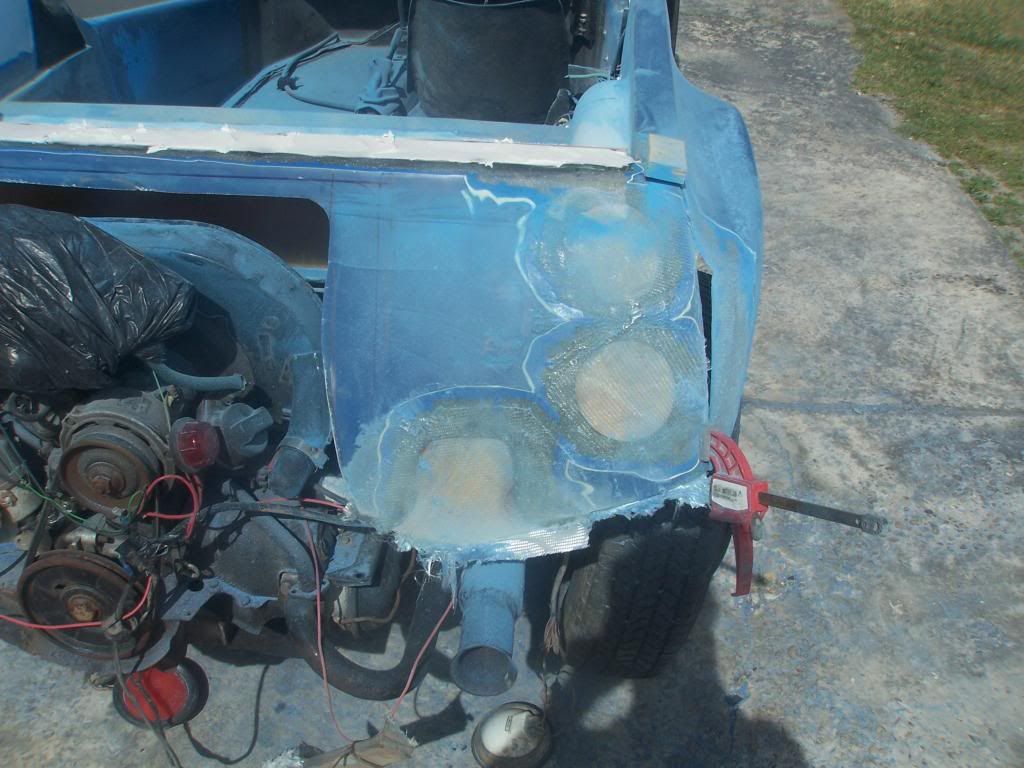

The truck light holes will be filled up
Shortened
Little bit of fairing prior to laminating

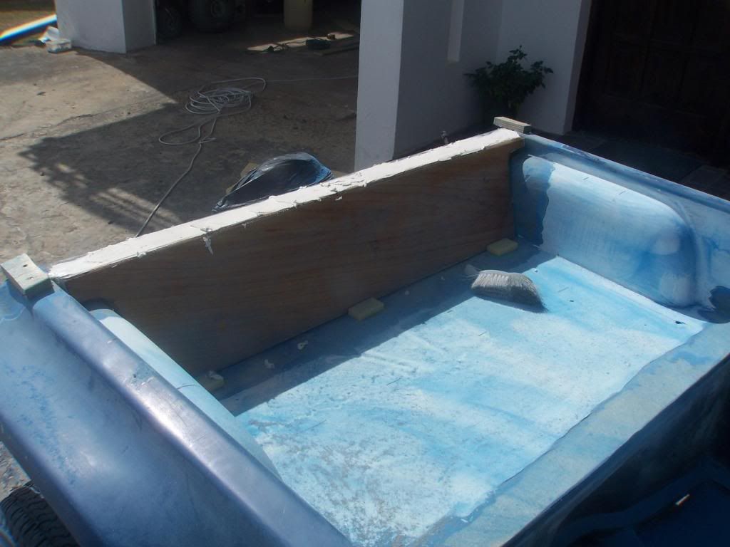

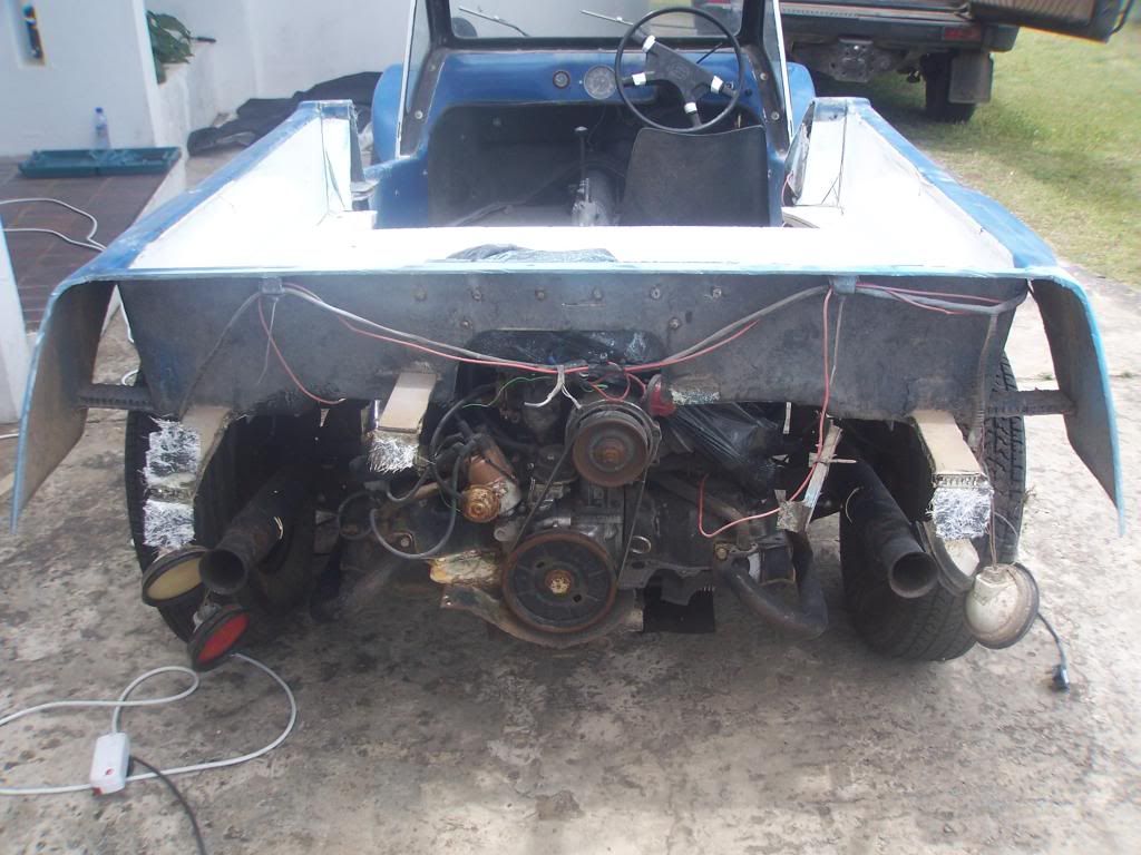

Checking rough fit of back panel

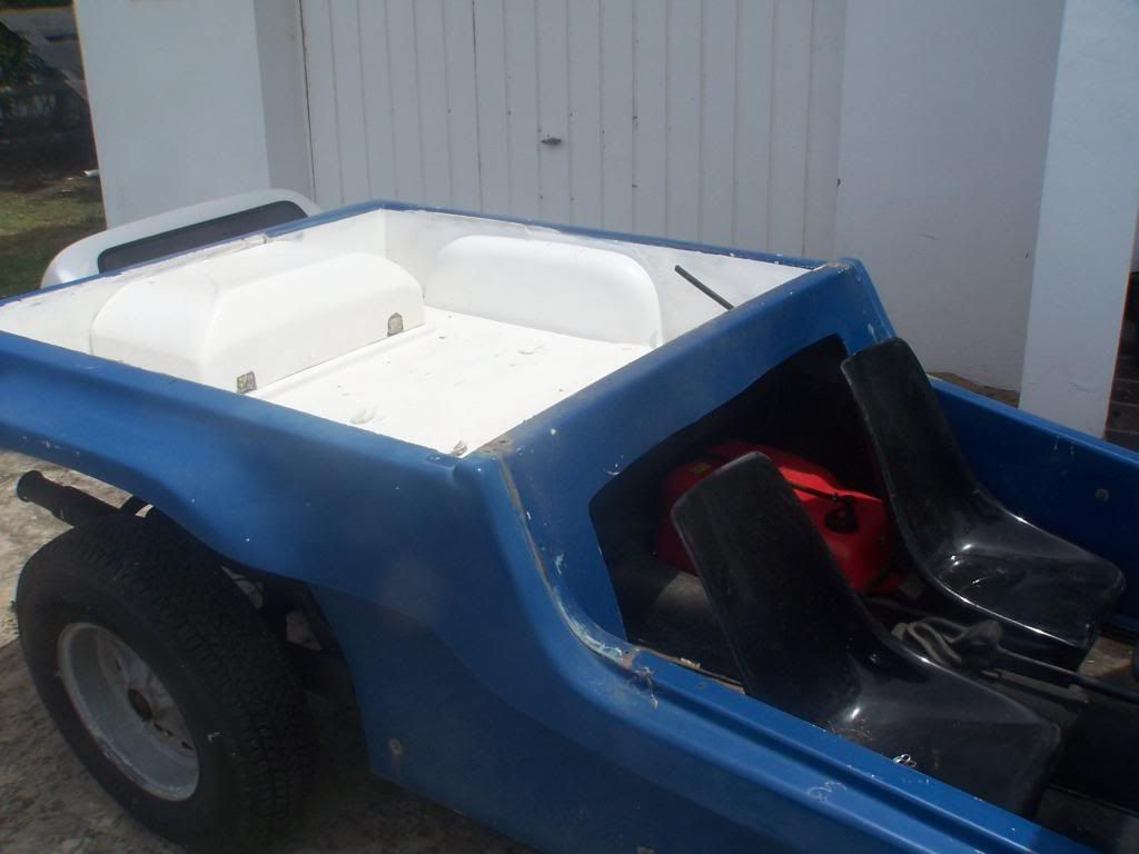

Size of new back seat.There will be a mini 'boot' behind the rear seat for storage

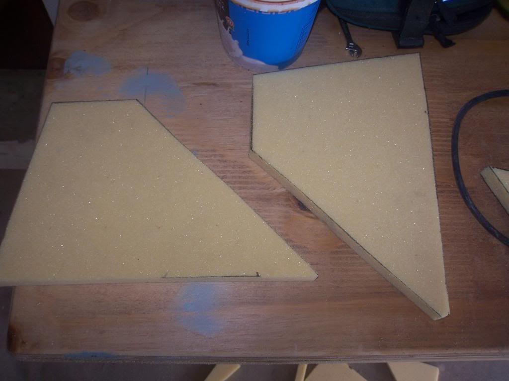

Structural foam for behind back panel to prevent it becoming to floppy
Bare with me while I sort out the bugs with uploading pics

just a question ,why dont you drop the front part of your rear seat by another 10-15cm then youll have the rear passengers sitting in the car instead of ontop of the gearbox,thats what im planning on doing with my buggy.
something similar to this pic on thesamba
end up with a proper 4seater buggy

I've been pondering on this myself. There is a steel frame under the bak and I would have to modify this or make up a new one. I'll give it some more thought and maybe will do some more cutting !! I'm busy making up a small mould for a battery tray that I want to drop into the back seat.

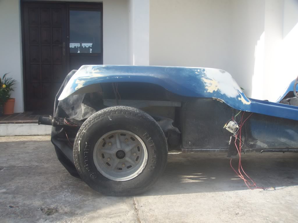

Most of the bodywork is now complete. I'll be towing the buggy to our factory this weekend to prime and spray. The colour will be light orange because I have it 'in-stock' with windscreen and side panels in a light cream colour.
I made a simple mold for the battery tray last week. All I need to do now is glass it in
I think it looks almost like a standard buggy from the side :D
Doesn't look bad from the back either!!! I'm trying to decide if I should put a cover over the motor that I can also mod to fit or if I should leave it. The pulley cover will be finished in carbon fibre anyway. Any suggestions??
I am modifying the windscreen to run a rope-track for the bikini cover at the moment.
