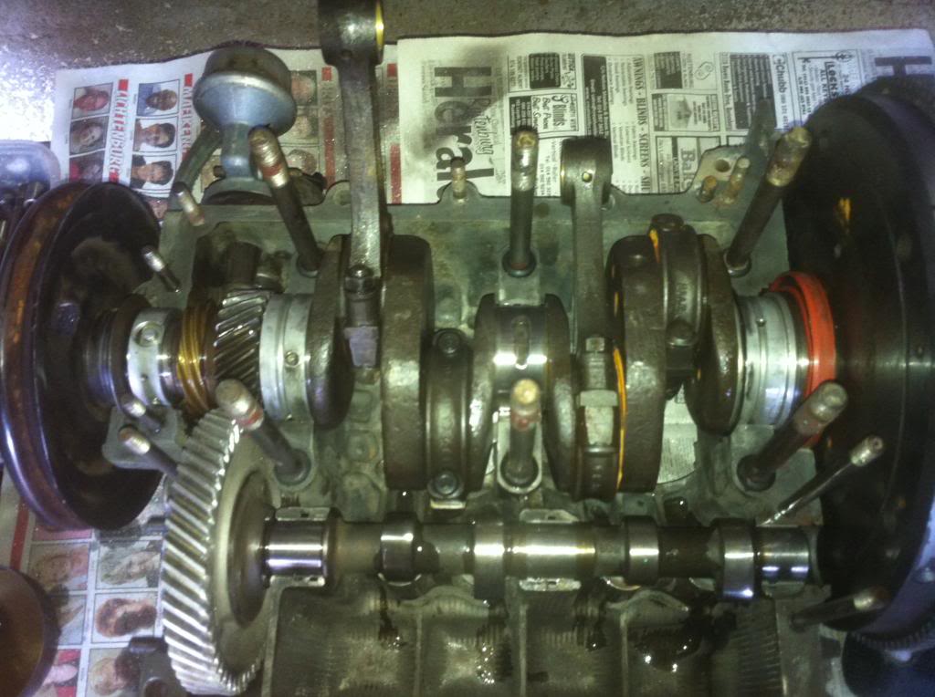

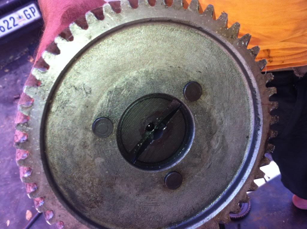

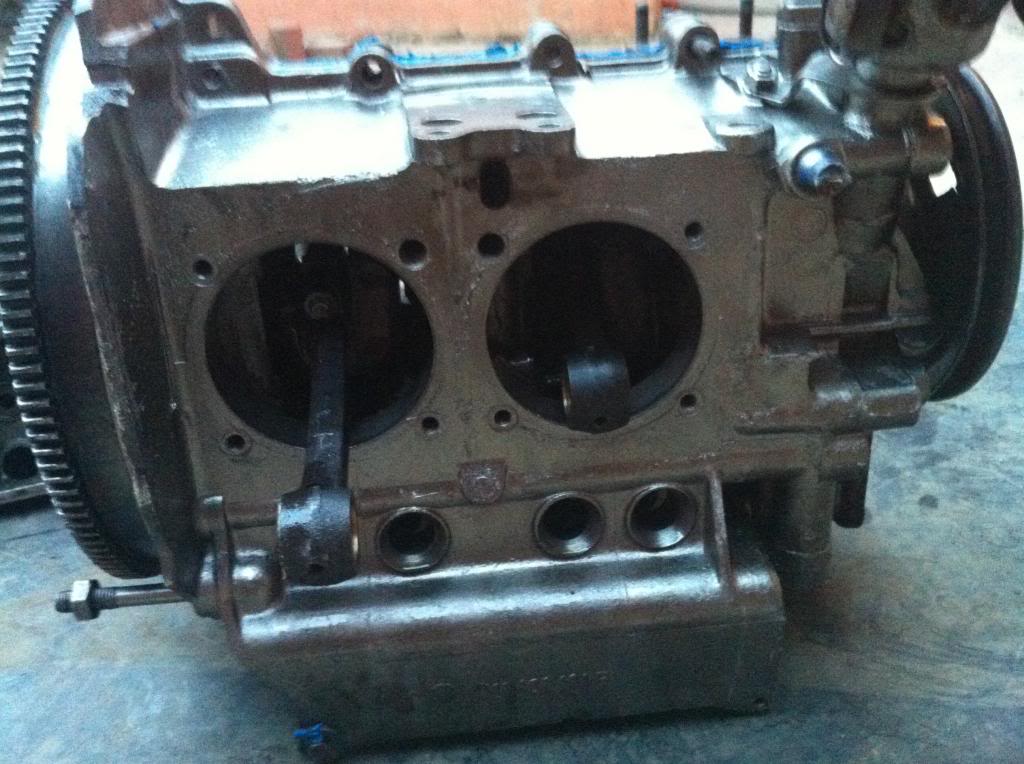

broken cam
clearance with old cam and oil pump
new cam
Clearance with new cam and pump

EISH!!! :shock: The PO must have revved the hell out of the poor thing.
Good luck with the project; looks like a really fun toy.

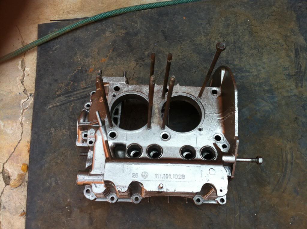

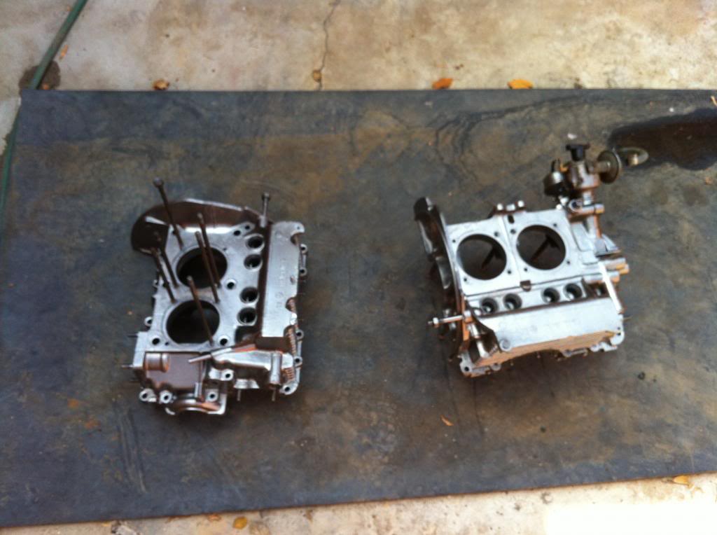

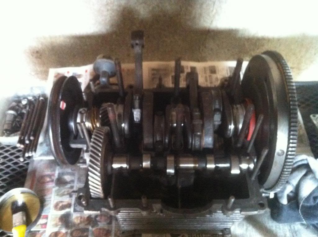

so today i started with re assembly .
had to do something about the block's color ! So i painted it gunmetal
So here it is...Back together :hangloose:
So of to work now...Tomorrow ill start cleaning these
Thats all for today :)

One thing I noted was that #3 main bearing dowel pin location is not in the right place, did you bolt it up like that?
Dude, next time go a little less on the case sealant. Am I seeing things are is that block broken at the top? Will only be hanging on 3 points?

calooker wrote:One thing I noted was that #3 main bearing dowel pin location is not in the right place, did you bolt it up like that?
Yea thanks for telling me ..but im not putting it in the car cause of the lack of experience i have with these so i contacted someone on the forum to help me with a new motor or help me rebuild this one..
the pics i took was at a mechanic but after a while i noticed he didnt really know what he was doing so i took the motor back home !
