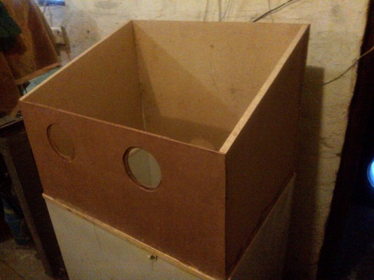

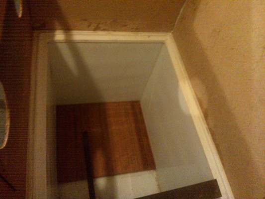

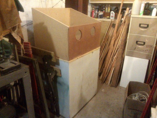

Wel ek het 'n sandblasting gun gekoop en wil begin met my buggy se wielle, nou hoe gemaak vir 'n sand kas. My werks plek is baie beperk en besluit toe om die ou boks vrieskas [wat ek gebruik vir stoor plek binne en werks blad bo-op (wat ek wou uit gooi want ek het 'n lekker sterk staar werksbank gekry)] vir die doel tegebruik.
het vandag net eers met hout 'n boks gemaak wat bop kom en moet nou die glas/plasties kry vir die deksel om dit te toets.
sodra ek hom het dat ek lekker by hom kan staan en werk sal ek 'n boks van alu maak om die hout te vervang.
You might not need to make a metal box - just line your wood with rubber sheeting. Old conveyor belting is ideal, and if you can find it, might even be free...
Barry
Barry wrote:You might not need to make a metal box - just line your wood with rubber sheeting. Old conveyor belting is ideal, and if you can find it, might even be free...
Jip that is a good idea if you can find old conveyor belting, you would not believe this but we supply new conveyor belting to our clients, but nun ever have a scrap peace to give away...and they are way to expensive to us new belting. But that gives me a idea to us rubber insurgent.
the compressor is a small 25l with a big pump that I add a extra 25l tank to it, a bit small I know. But I can life with that.
